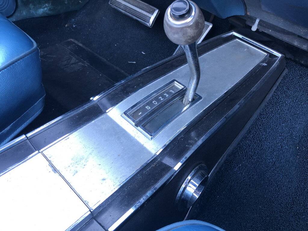

My '69 300 has a wood grain shift knob but the console is plain smooth aluminum, no woodgrain. It's always struck me as odd. Now that I've seen this video, I wonder if I'm supposed to have woodgrain or if my shift knob is wrong? :confused:

My previous 69 300 had plain console top, and chrome shift knob. My understanding on the knob was that the chrome were left over from 68, so early builds got them til they ran out and went with wood grain. As far as console top, seems most c bodies I have seen had the plain aluminum, but all repros now have wood grain. But I know no specific reason why C's had plain aluminum...and if I could find one I'd buy it ..lol
My 69 Polara (SPD 12/12/68) has the wood knob and aluminum console, I can't say it is correct as I know the previous owner replaced the console.
Alan
Up to Jan 1st 1969 the chrome tulip knob is correct. Changed to the wood grain after that. The fluted chrome console top is correct on a C body. :)
Non federal safety mandates (i.e. headrests) for hard and fast change over dates are difficult to prove. The parts book references through the chrome vs black button change (tulip vs wooden knob) a transition to start in October. B body wood knobs seem to become prevalent in January depending on the plant. I would presume available inventory was used up as needed in C body plants also and the change over happened when inventories ran out.
