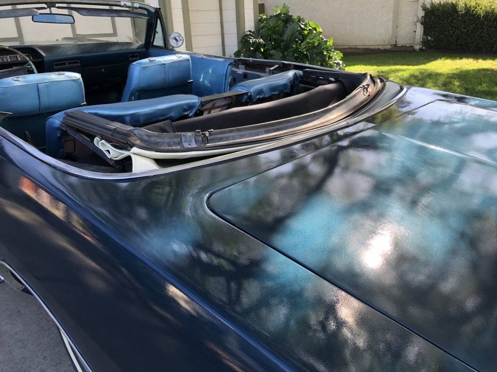

This is what’s always looked normal to me. I’ve always thought only Volkswagens and horseless carriages should fold down above the well.

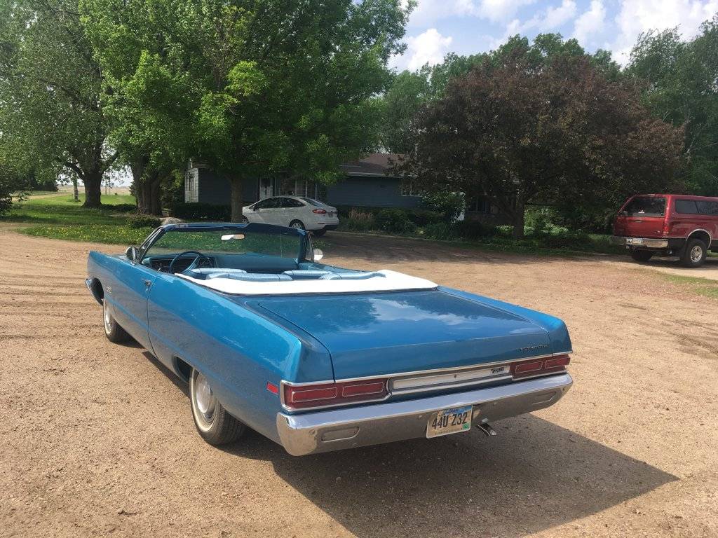

It should go down farther than that. I'll snap a pic later of mine, but it should be almost flush.

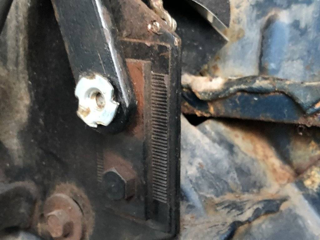

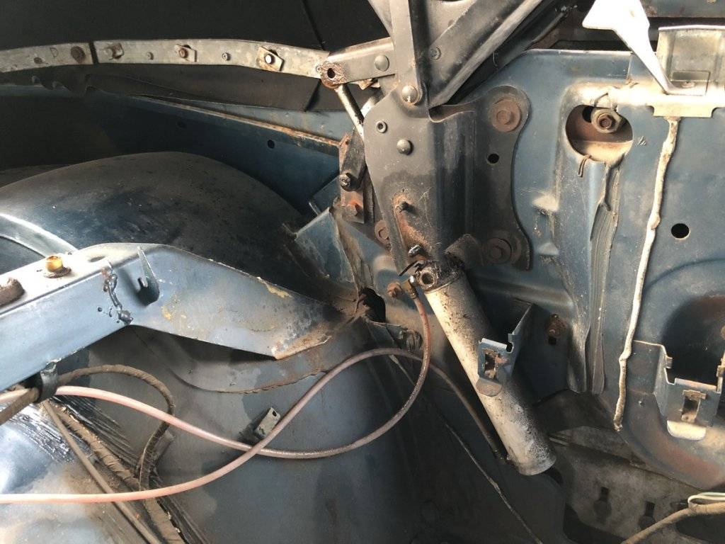

The frame has little adjustment in the main mounting, I feel that rotating it down in the rear may help but would probably throw off the header fit.
That might be where this adjustment come in (don't worry, the woodworking hardware has been replaced).
There may be other adjustments but I haven't looked, this is all I feel that might impact the drop depth.
Alan
is the top currently working? i only ask because it looks like the pin is missing from the cylinder in your top picture. without the pin it will most likely bind there.
the bottom picture is your stack height adjustment. that is what you are looking for. keep in mind that lowering the stack will change the alignment on the header .
you'll also have to re adjust your side windows. test carefully checking for any alignment issues and binding.
The top works fine.
I was replacing the pins and cylinders.
