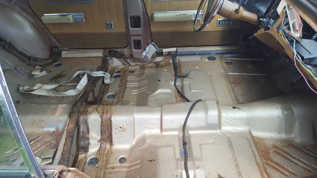

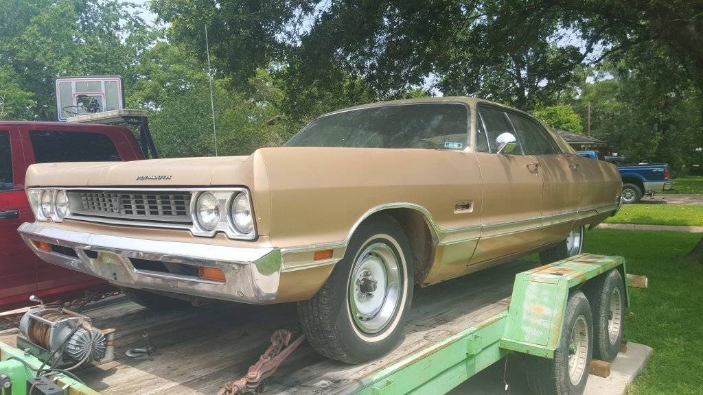

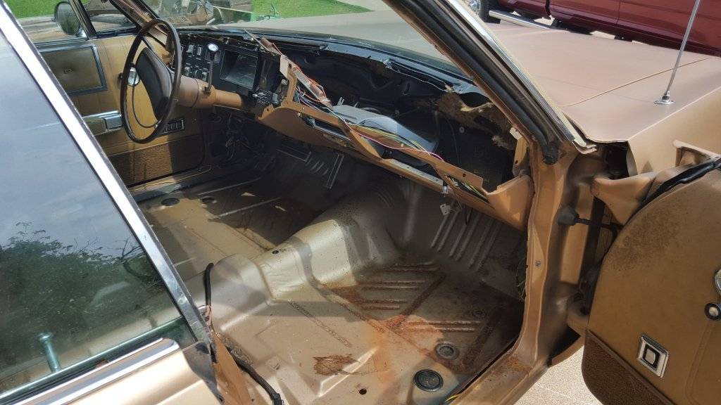

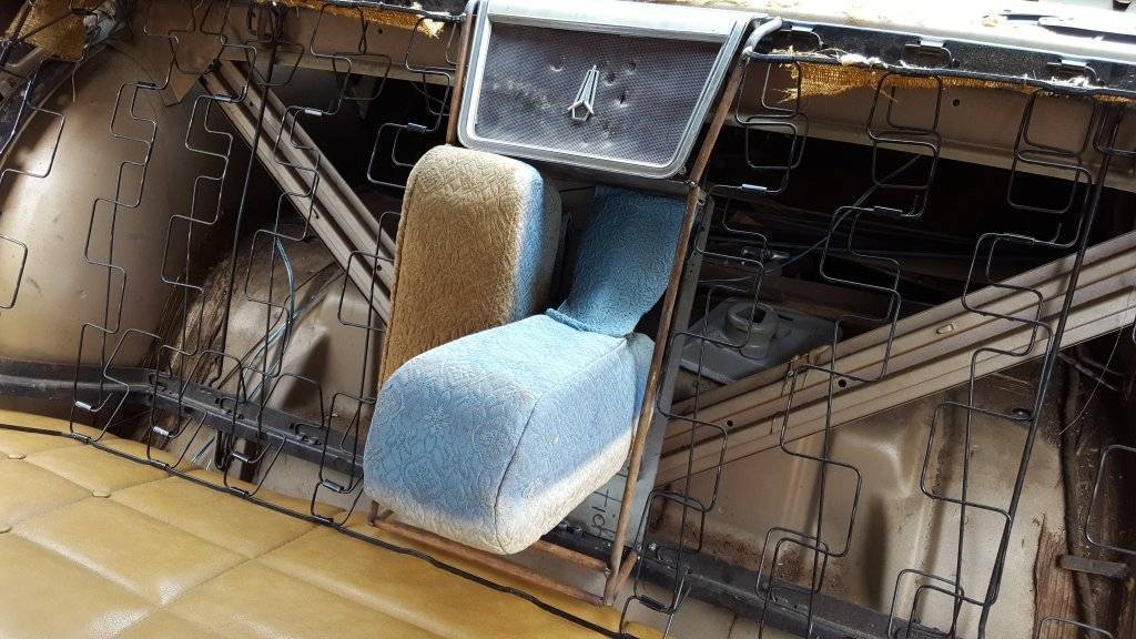

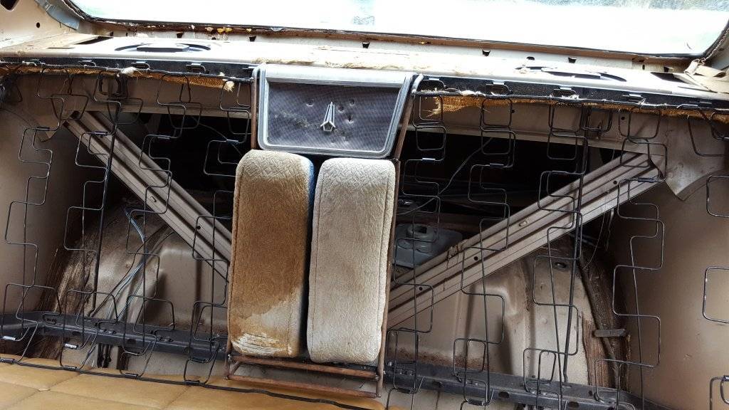

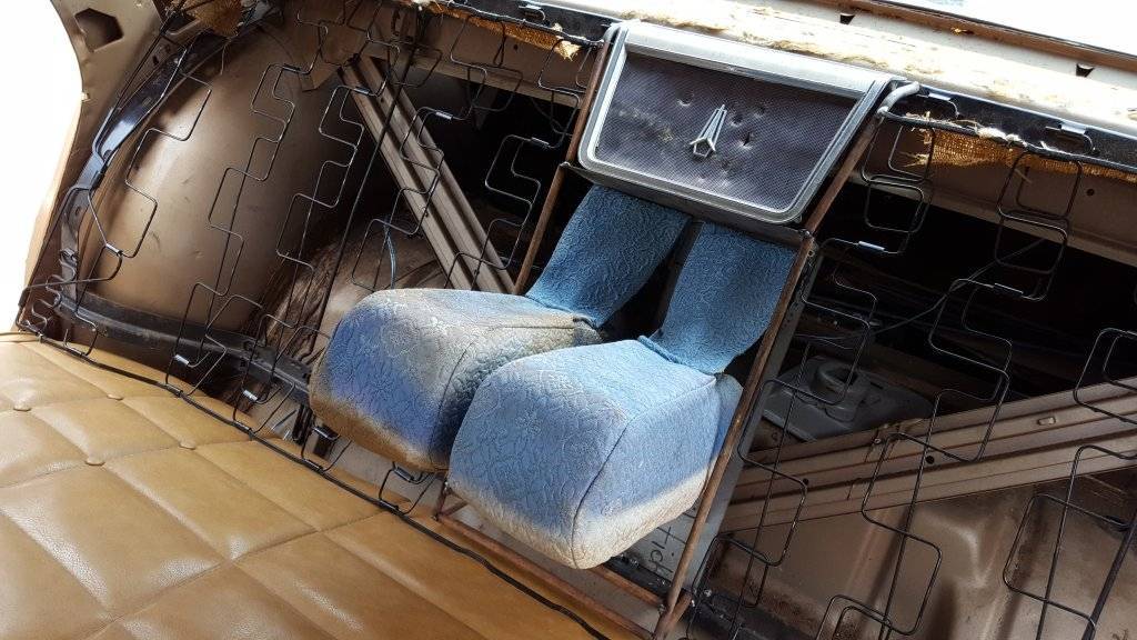

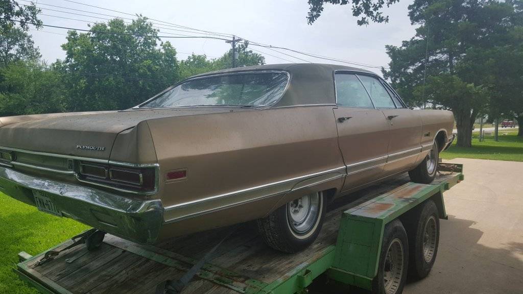

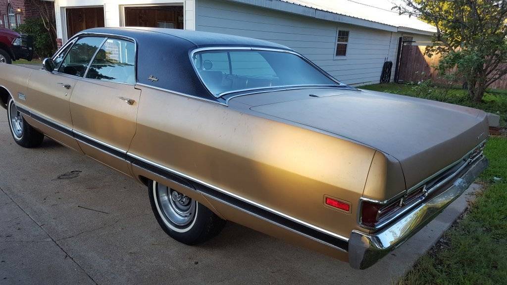

Here's the latest project 1969 VIP 318 2 barrel 19,000 original mile car. Coming in for a polish, carpet, headliner, dash pad, disc brakes, a/c work, belts, hoses, ect...

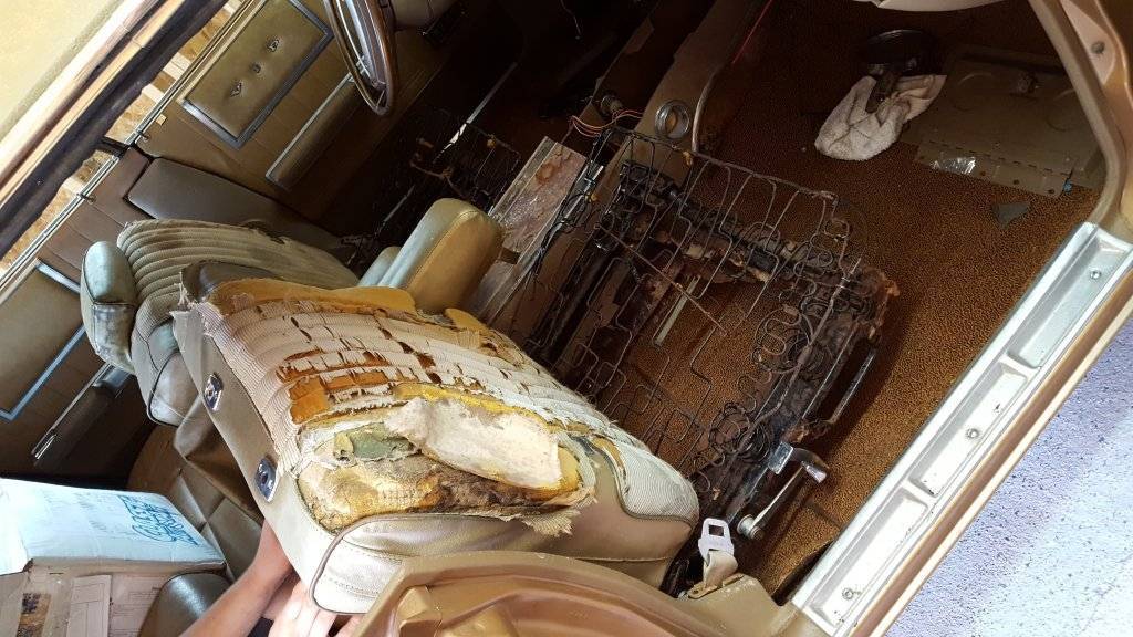

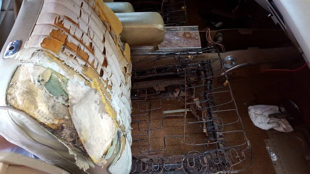

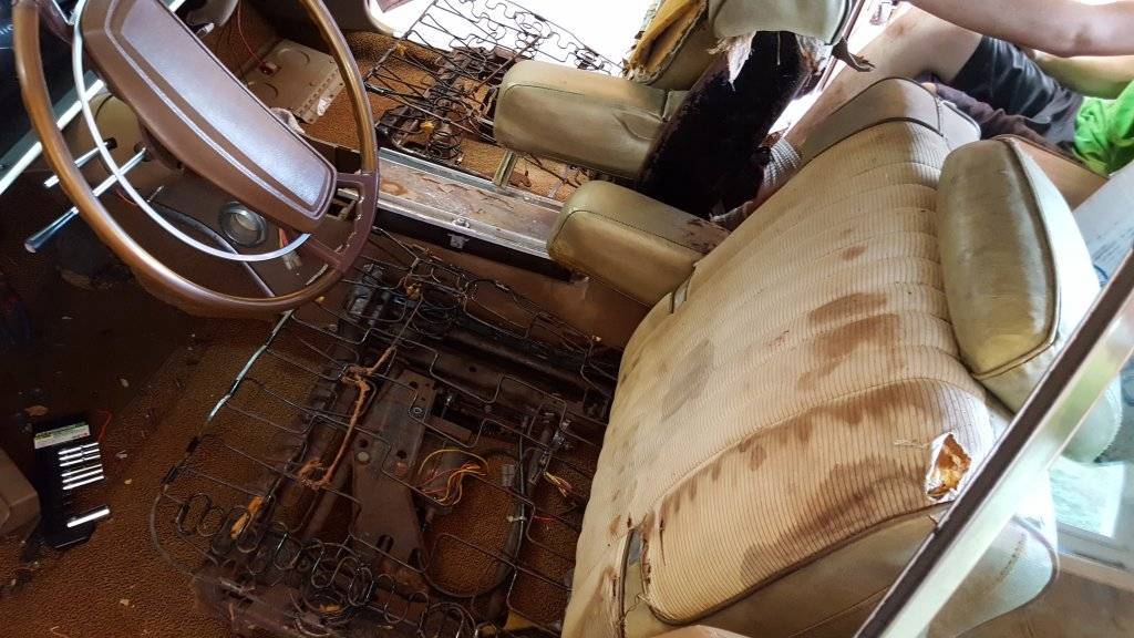

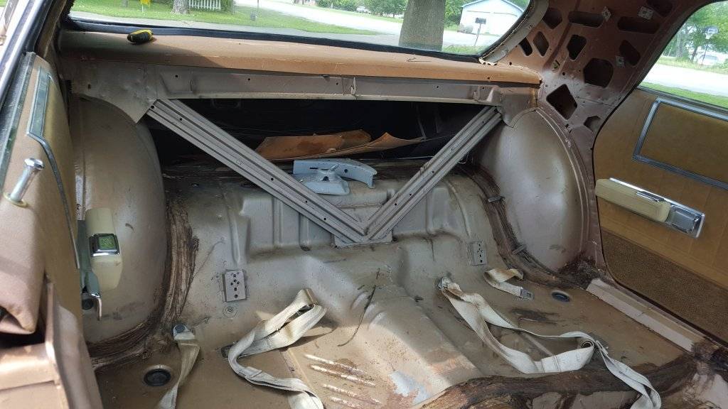

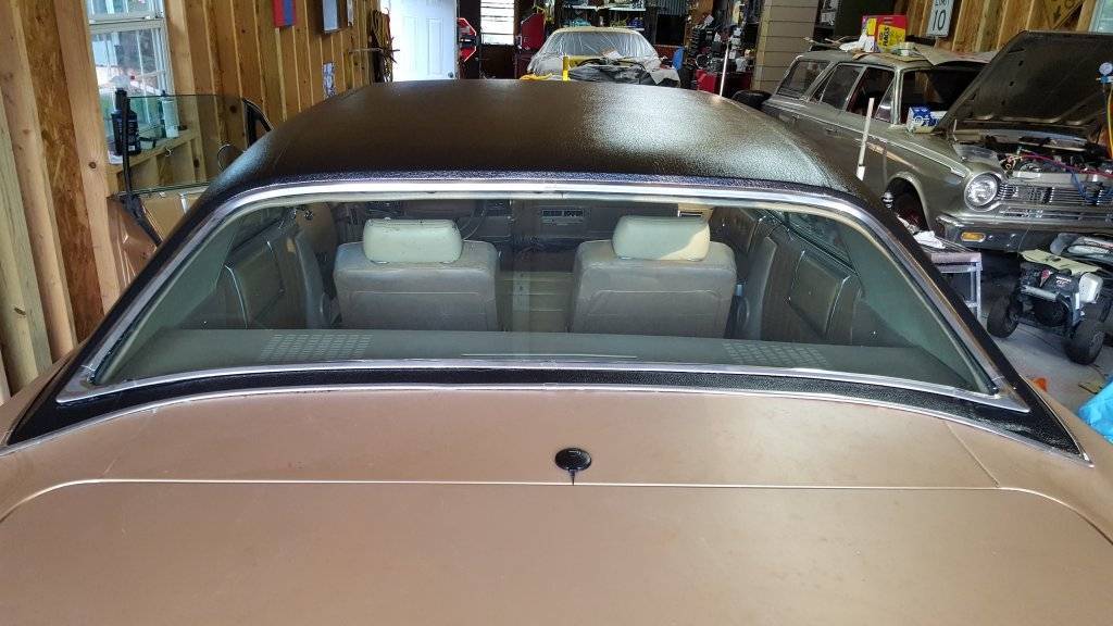

so we decided to change the interior up a bit, instead of the boring old bench seat car we modified a split bench set out of a 71 fury to accommodate a center console. It still utilizes the fold down arm rest and power drivers seat. The rear seat was also modified to accommodate dual folding arm rests and the speaker grill from a sport fury, which will be the intake for the rear window defrost. We cant wait for the seats to get back from upholstery!

It's being built for a customer who has a list of options that needed to be in the car so it's comfortable for him to drive. He tried the car as a bench seat car and where he needed the seat to be for him to be comfortable it was uncomfortable for the passenger. Arm rests were a must and it had to have a center console for easy access to his pistol. It's being built for his everyday driver.

Thanks, it's not like we are doing this to a 71 gt, it's a 4 door so why not change it up a bit. We also have a 440 that is fixing to be dropped off at the machine shop to put in her. The 318 2barrel just isn't going to cut it
