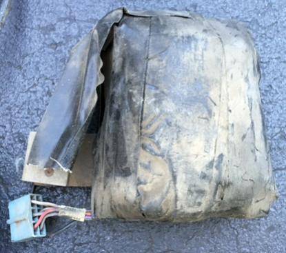

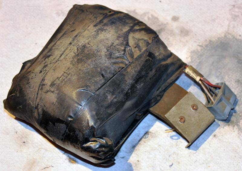

If the problem is in the red box, you will probably have to locate a mechanical replacement :(

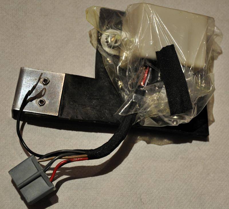

I have a spare "package" but I'm not sure if its the mechanical relay or the red box. I never checked it, but I can check that tonight if you want.

As mentioned, I do have a spare second hand unit, I will check if its the red box or the mechanical relay.

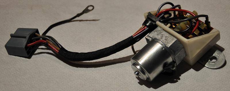

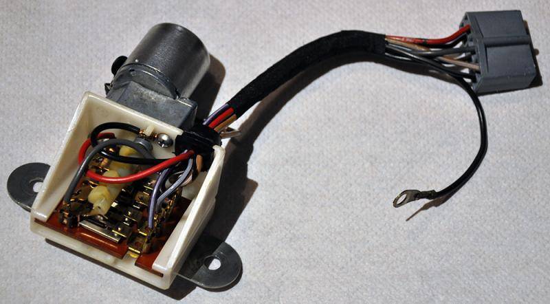

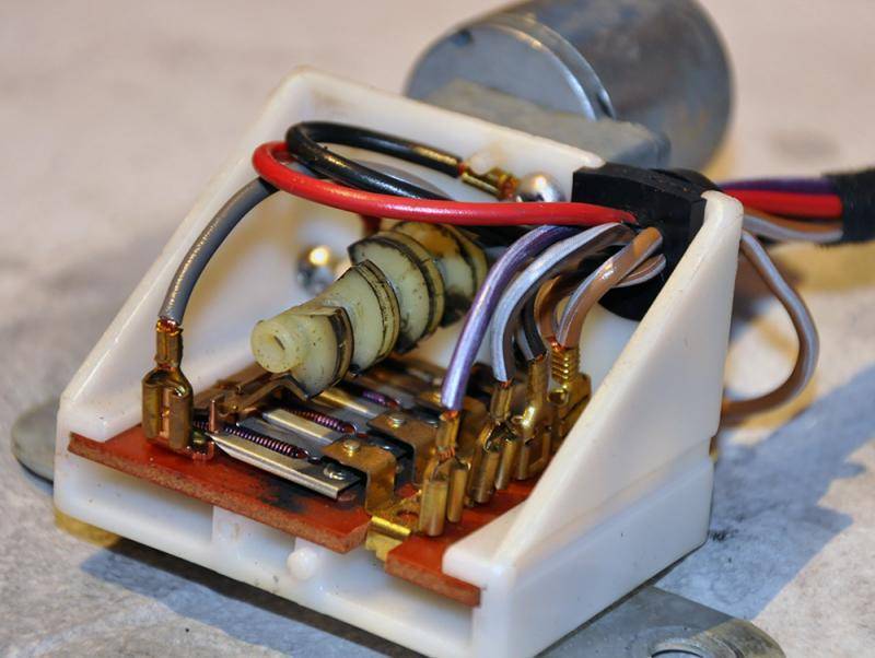

I indeed have a spare mechanical unit. I bench tested it and it moved very slow and agonized.
I opened it up and it was a mess. 46 years of dirt and grime everywhere.

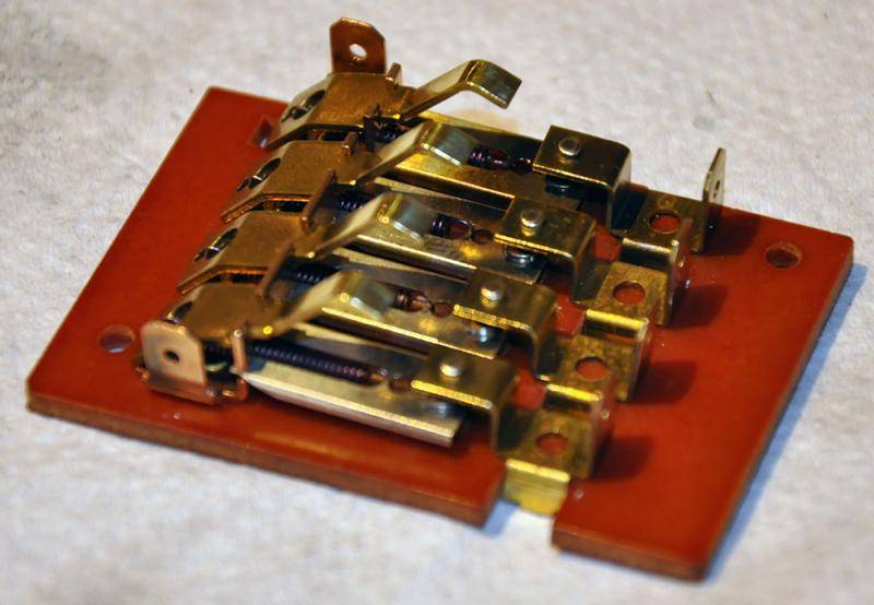

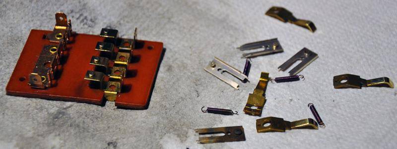

I took it apart completely in order to clean it.
I cleaned every single part with a small wire wheel. after assembly, I polished the contact points to the cam as smooth as they can get to generate as less friction as possible.
After that, I had a little improvement in cam speed, but not as fast as its supposed to be.

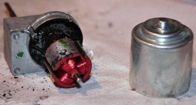

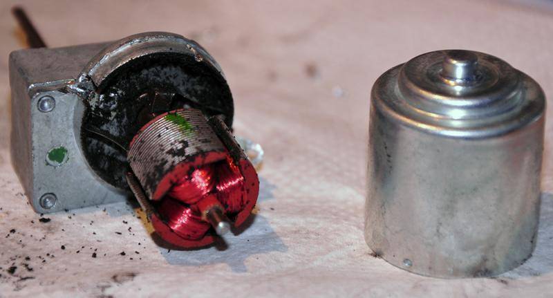

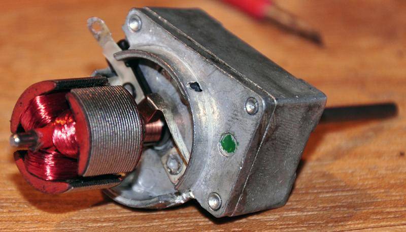

So I took the motor itself apart and it was even worse in there.
But it cleaned up pretty nice with a little effort.
The endresult is a completely rebuild unit, and you Sir have the possibility to buy this beautiful piece of ingenuity if you're interested!
