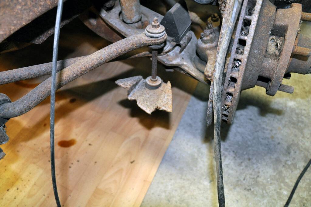

I will 100% agree with the spring mfg.
But the "bent t-bar" catches my eye.
They don't bend unless some outside force bends them. That may be the source of your problem. Whatever bent the bar pulled things out of alignment.
The Sway bar mount was broken off on the lower control arm on the driver side where the torsion bar is bent. Maybe the previous owner hit something with the LCA!?
