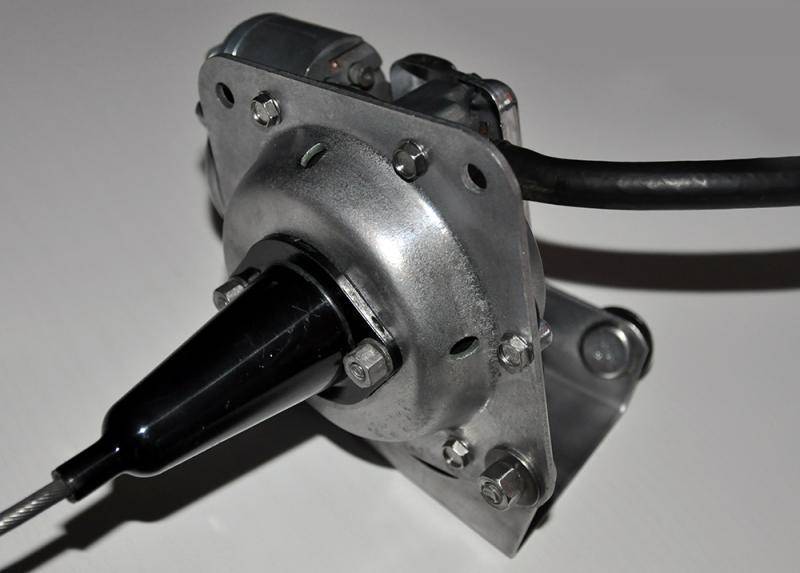

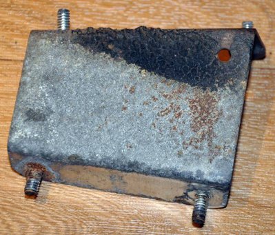

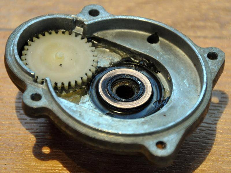

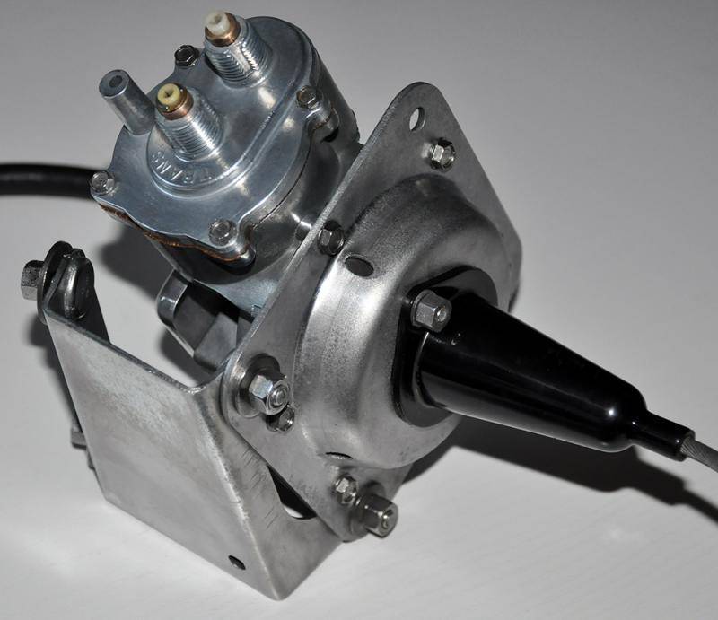

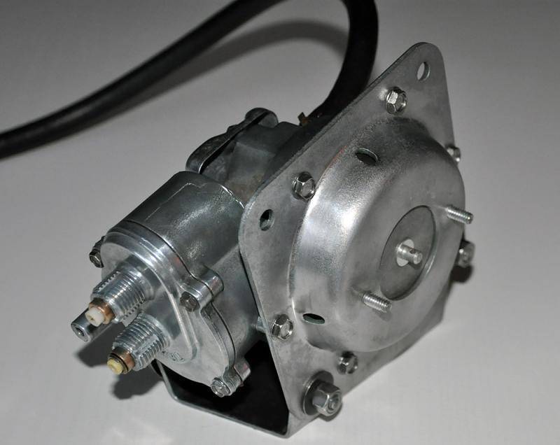

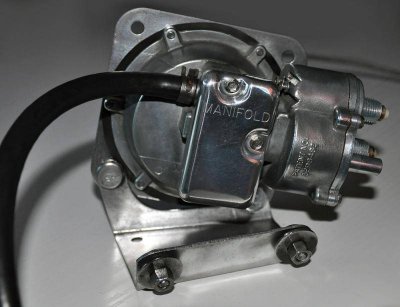

Another part is done! I love shiny metal :)
Amazing. How did you restore the finish on the metal?
Most parts are done with a wire wheel and a polishing wheel on a table grinder. But all tight sections are done with a toothbrush sized wire brush and a rag with Autosol. I'm also using a lot of different dry and wet sandpapers.
Some small, winding parts with just surface rust are washed with soap and hot water using a nail brush and then soaked in metal rescue.

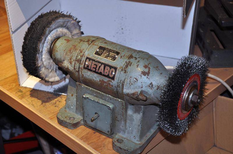

That's the gringer... Found it for close to nothing on a garage sale. The wire wheel creates a great brushed finish. If I want it smoother, I use the polishing wheel on the left with 2 different polishing pastes. Called "pre polish - rough finish" and "high-gloss finish"
