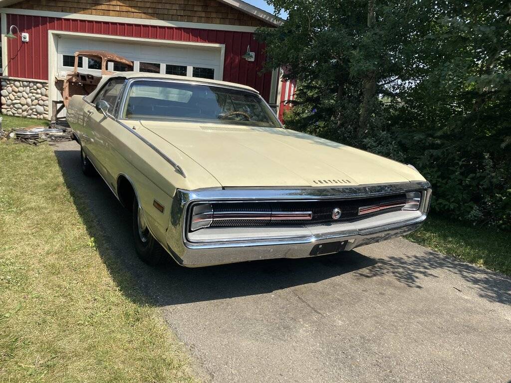

Here’s a few pics
since the column shift has been changed to a console i'd keep it that way.
imo changing to a console shift doesnt hurt the value if thats important to you; i think more people would prefer it.
you might want to look for the 70 chrysler padded console top pieces but they will taken some hunting.

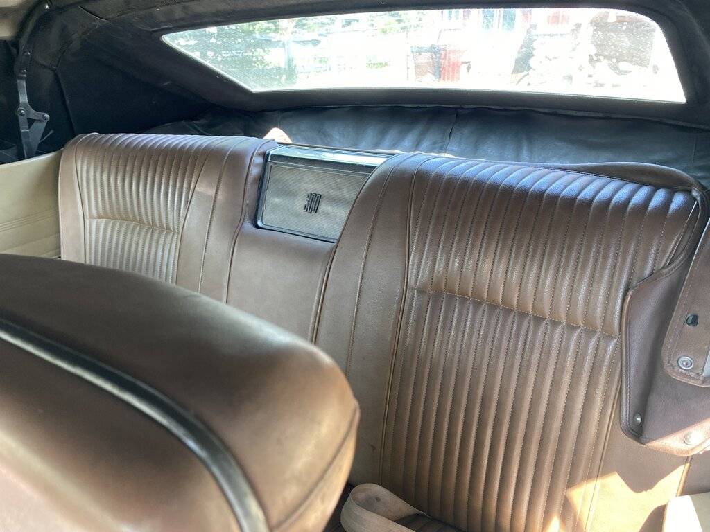

what colour was the interior originally ? i'd guess saddle tan because of the dash pad and top boot
heres a pic of the saddle tan coloured console tops in my 70 300

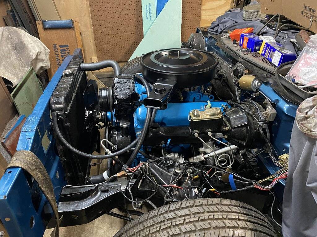

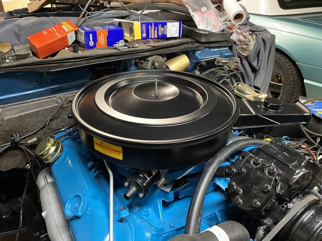

Incomplete, but I’ve been working towards originality. Mine has AC, the air cleaner is a single snorkel.

Here’s a photo of the single snorkel air cleaner in the car, as well as a photo of the console.
Obviously the console is not an original one, but does the air cleaner itself look correct?
The air cleaner looks correct, although it’s missing a vacuum solenoid on the top of the snorkel. Console is from a ‘68 or ‘69, someone here should be able to ID it. Beautiful car, nice catch BTW. Can you post a pic of the fender tag?

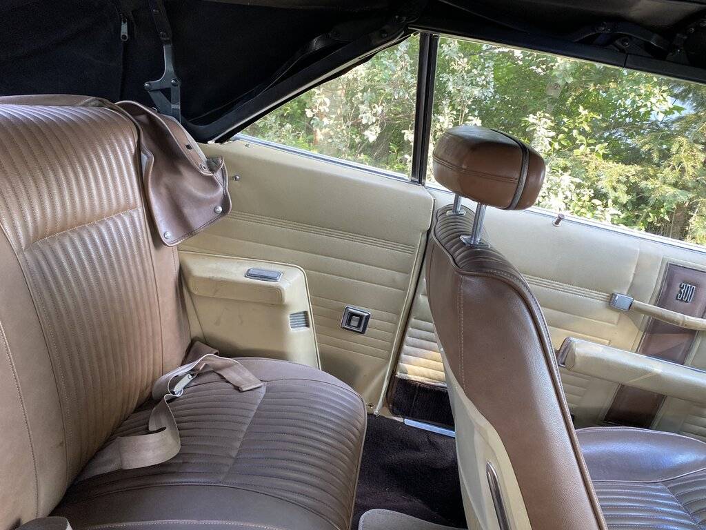

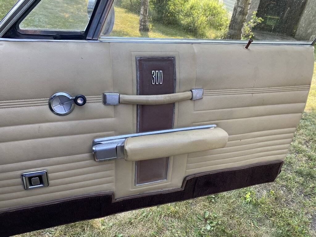

Hey Marko; yes my car appears to be a saddle tan interior car as well.
My door panels aren’t in great shape and someone has painted or spray dyed them at some point. They are now 2 tone, but I’m guessing originally the interiors on these cars were just 1 colour?
I’ll go take a photo of a door panel and post it up.

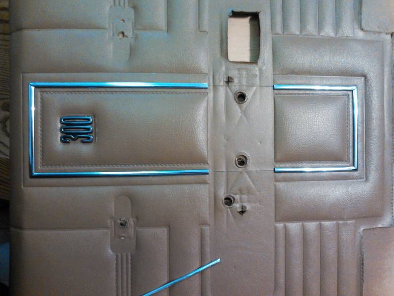

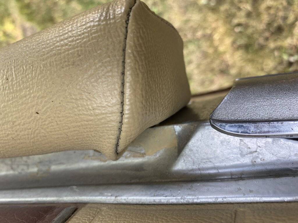

So that’s what’s happened in the past, someone has either painted or stained the door panels, and left the centers saddle tan.
There’s actually a brush mark on the chrome armrest plastic backing plate!
so this begs the question, could I go after this gently with a stripper and remove the topcoat?
Obviously I can’t order new saddle tan door panels from Legendary interiors!
I used the SEM products to redo my dash with excellent results. I do not know if you can actually take the topcoat off, but they might have a color that is close to the original saddle so you can respray the whole panel.

Although the console is not correct for that model year, buckets w/console is more upscale than buckets with the buddy seat center item, to myself and many others. No real "ding" to the value as long as it was done well, even with the incorrect model year console. BTAIM
If the air cleaner pie plate is important, you can either easily remove it or get one that is just "Chrysler 440" instead. But do get the vac operated flapper item for the air cleaner snorkle, even if you don't hook it up (requires a thermostat and vac lines from a manifold vac source to run it).
In addition to your other priorities, finding a useagle build sheet would be a good one to have, generally, just as in the B and E-body cars.
As to the underhood colors, the vertical part of thecowl area will be body color, as will the core support. The inner fenders on Fuselage cars and later will be satin black (same as the engine brackets), rather than body color (as the '68 and prior C-body cars are). The front of the core support and upper/horizontal cowl area will be painted a flatter satin black (and sometimes somewhat sloppy, by observation).

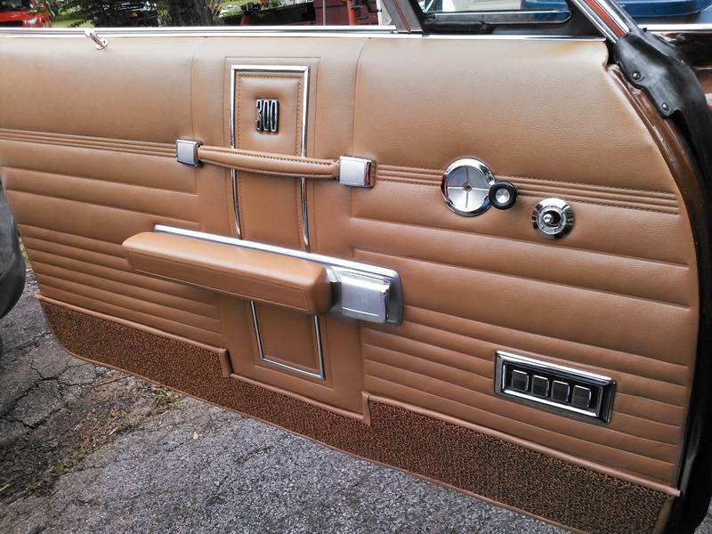

I've painted my panels with SEM paint with great results. The color isn't quite the same, but it looks good.
A couple things... The arm rest and base are available in reproduction and the door pulls have been reproduced by ABC Mopars.
I redid the chrome trim on mine too. Used this stuff from Auto Zone.

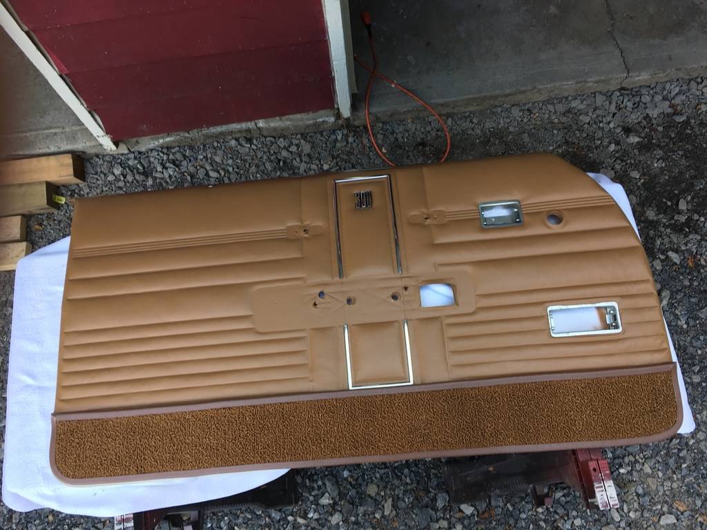

My finished panels after paint etc.
I didn't like how the carpet turned out so that was redone a year or two later.
Hey big John; your door panels came out great!
Do you recall what the name of the SEM colour was that you used?
Did you use the SEM pre stuff that helps adhere their paint?
