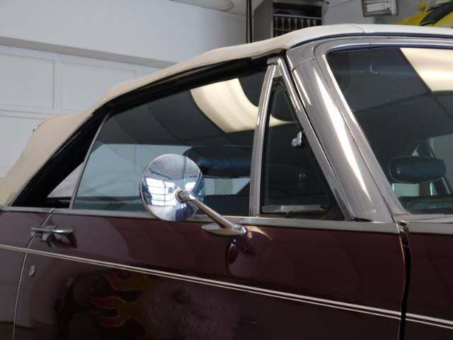

Is the passenger side mirror correct on the 300? Looks different than the drivers.
Also noticed the steering wheel is wrapped in leather.
The more I look at this car the more I notice.
The right side mirror might be OK, as the photo isn't that clear. The wrapped steering wheel almost invariably signals a badly cracked steering wheel.
Pulled these pics from dealer webpage...
I'm thinking the passenger mirror is a add-on aftermarket. No?

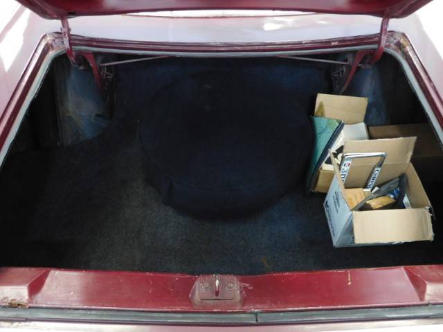

Aren't the spare tires supposed to be fastened on the right side on trunk floor on convertibles? Wonder if the floor is shot and covered up with the new carpet.
Also noticed the Dutchman panel in this pic doesn't show any seams. I would say that is the 2nd indicator, along with the boot trim snaps that this panel has gotten filler work done to it.
Mirror is wrong. Spare tire placement will shatter the rear window if you put the top down. No-seam dutchman's panel is correct. For some reason convertibles came from the factory with leaded seams that always cracked with time and body flex.

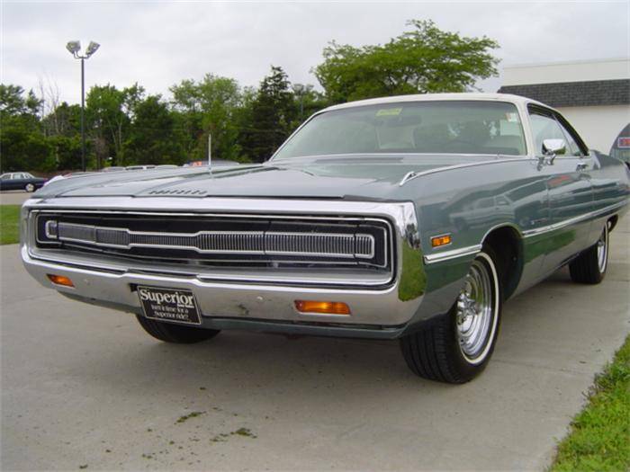

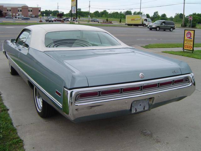

Don't know what happed to that one. Superior also had this one for sale many years ago now, maybe as long as 10 years ago, and I still kick myself for letting it get away..........
