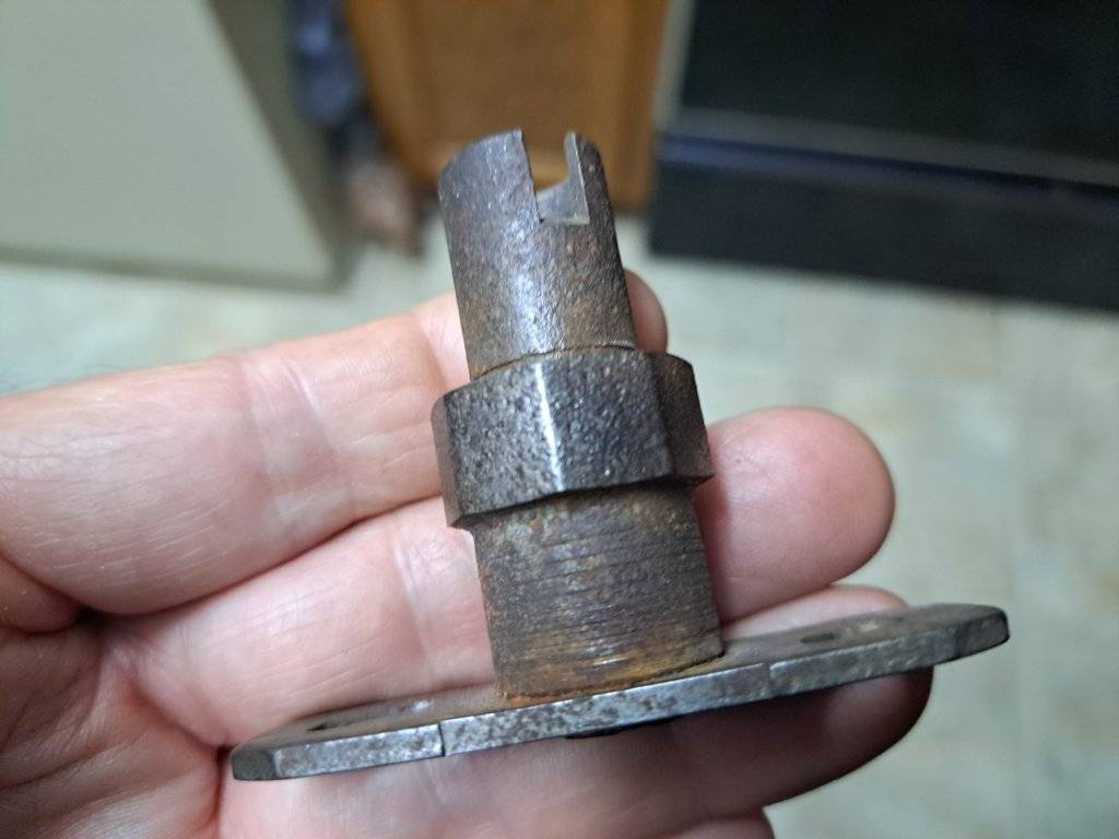

I am looking for a distributor cam assembly for a 1970 Chrysler300. Picture below is NOT the actual part, But a representive part. Must be new. My usual sources show no part in stock. Bushing and cam lobes are worn out on the original.
@halifaxhops should have some.
Good time to do a recurve to run better on the corn whiskey at the gas pumps.
That is if you want to stick to points.
The distributor cam in Frankie was well worn so I installed Pertronix ignition.
Problem solved, and still looks " stock" .
What bushing is worn out? There are none in the advance cam just the shaft itself. Need to know what is marked on it for slot length and R or L if over 15.
All I have are good used.
