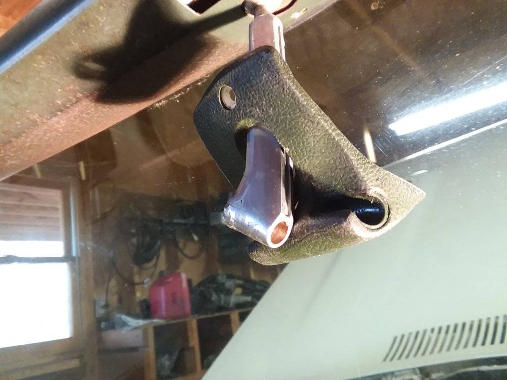

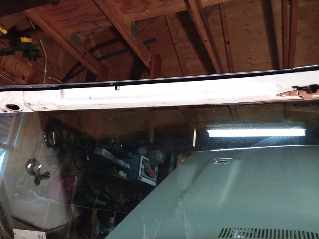

I want to paint the header trim above the rearview mirror, but am having trouble removing it. So Far
-Header trim: removed one screw either side of rear view mirror. Trim is loose at sides, but at center remains tight against windshield frame.
-Triangular trim piece at top of mirror shaft. The front screw screws into the header trim molding. The long rear screw screws into a metal clip. After this piece drops down on to the mirror, it does not expose any additional screws that need to be removed to remove the header trim molding
-Rear view mirror base, under header trim molding: loosened Phillips head screw, see pic below. Header trim still did not move.
-I don't have a replacement trim piece, so really can't risk damage to this one. I guess there's clip under the center of it somewhere, but Chapter 23 of FSM gives no hint of it. Any help is greatly appreciated!

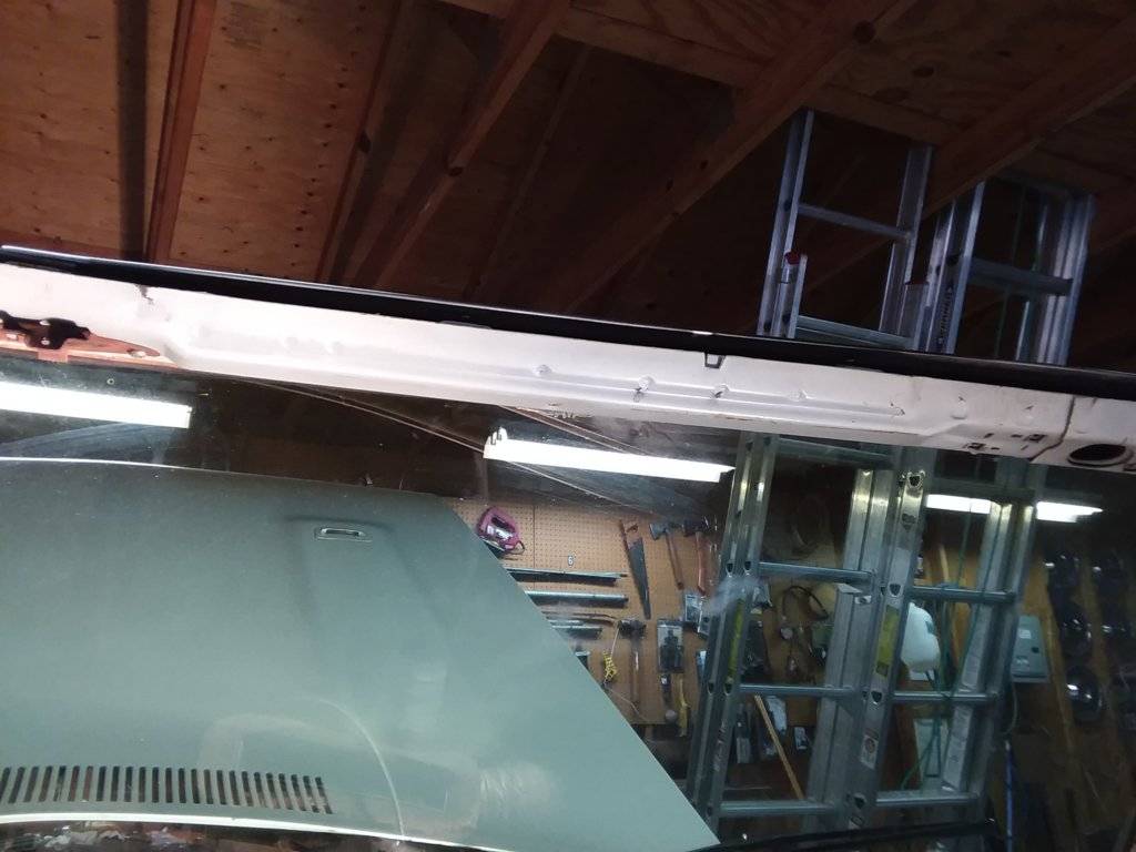

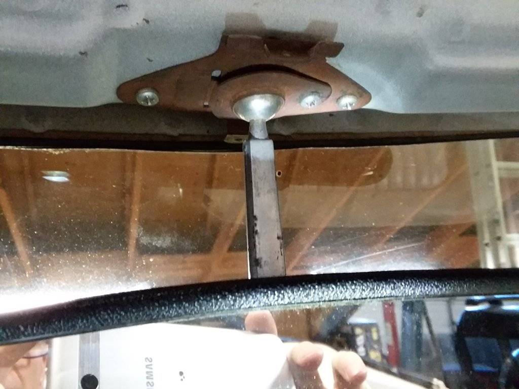

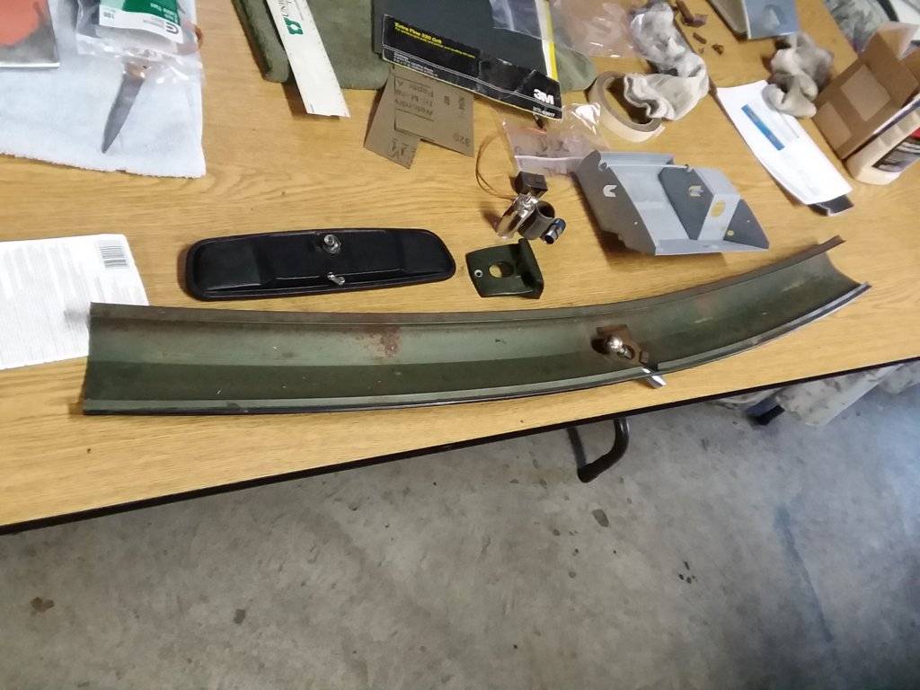

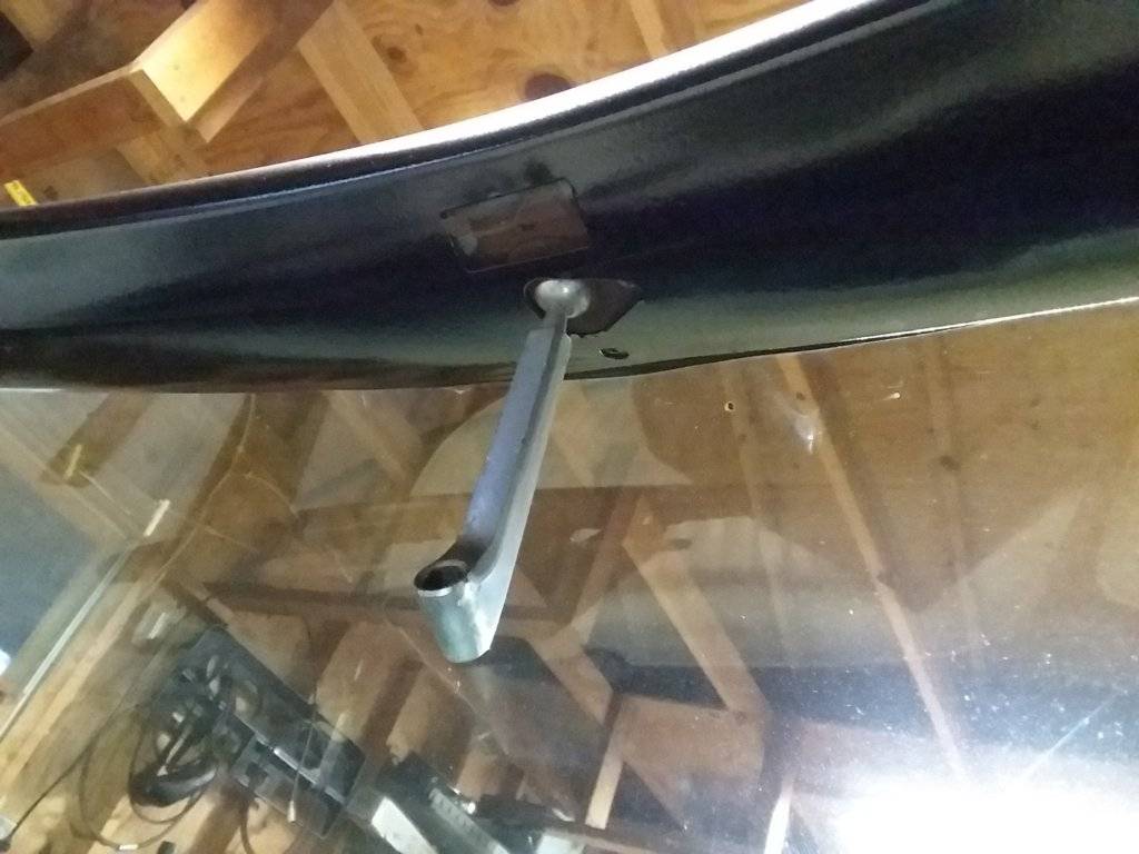

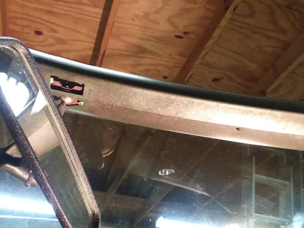

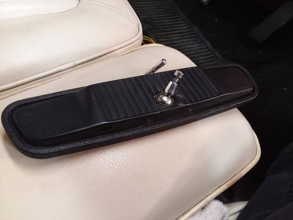

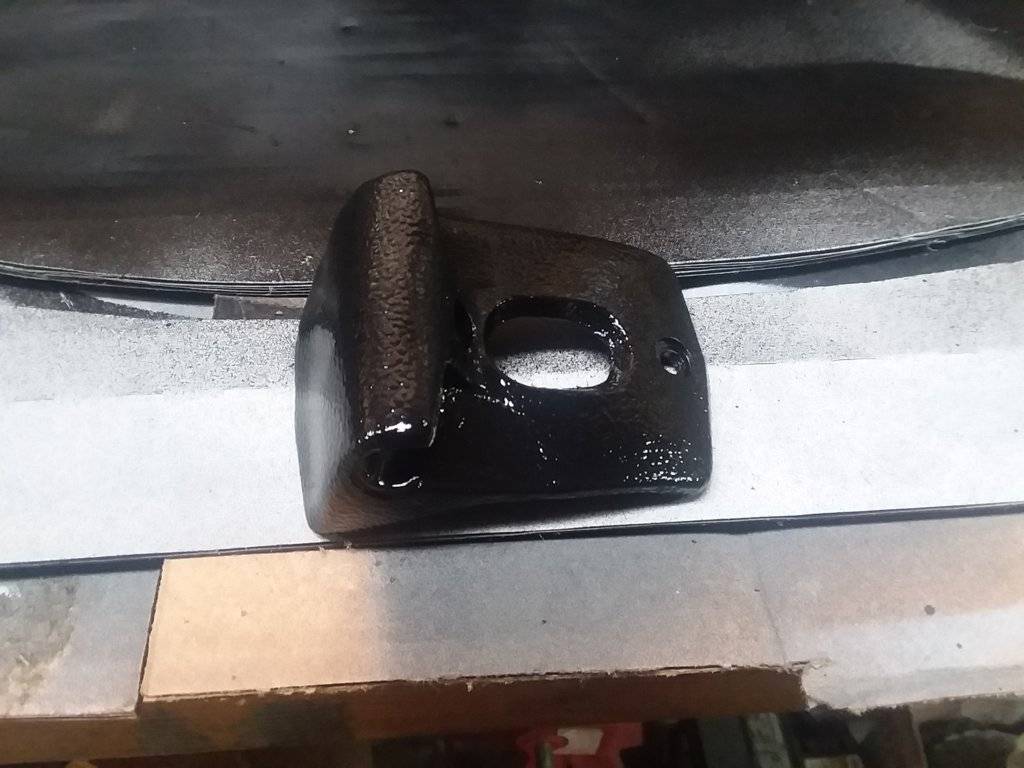

Phew! Everything removed. Some pics and procedures
· Mirror, remove from arm: 1/8 inch Allen wrench. After remove bolt from arm, mirror comes off of arm easily
· Header trim: tried getting a 18 gage wire, then a ground strap between it and the wind shield frame. Didn’t seem to help. Ending up grabbing either end of the trim and just wiggling it back and forth until it eventually loosened and popped off. It did not have any black mastic. It just had been in place for 47 years and didn’t want to move.
· Mirror arm and base: remove single Phillips head screw and remove arm with base.

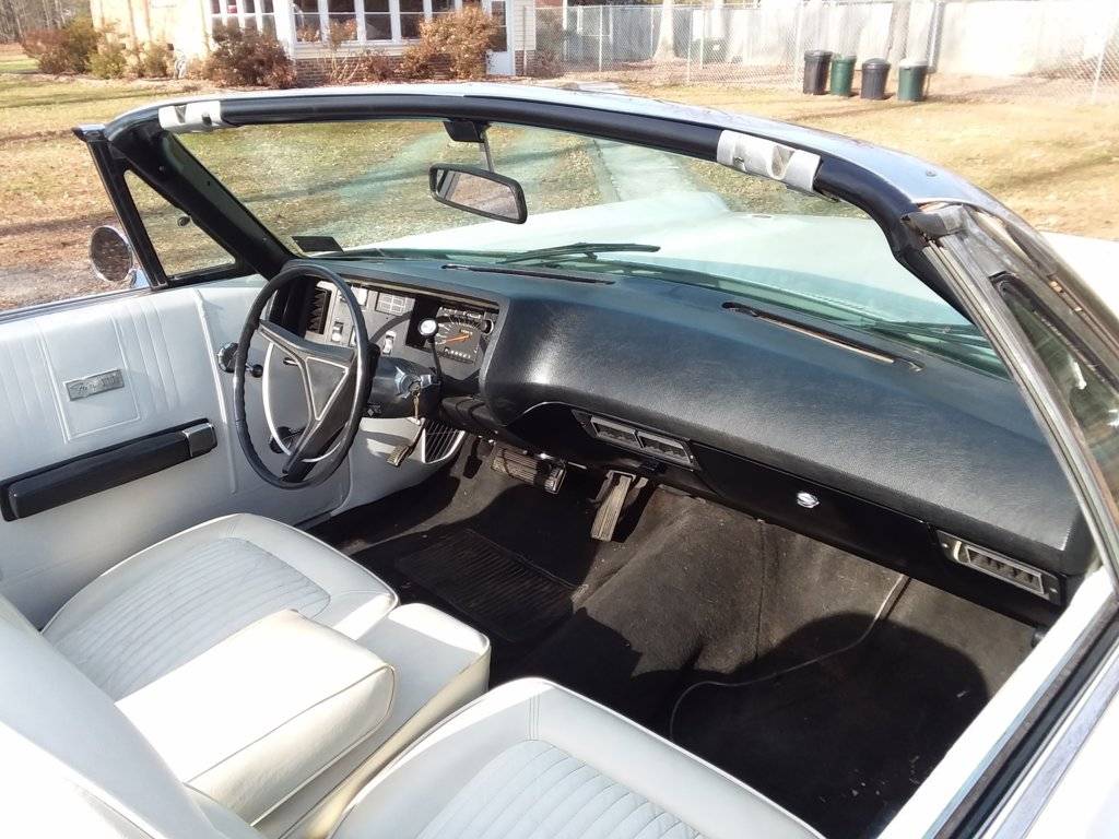

So, it's a green interior car?
Hi Tom, It was a green interior car. The dash and windshield trim are the last step in an ongoing change to white/black. My digital camera makes this picture look better than reality. The green color is more dull and brownish than it appears. Also, the hole in the dash pad above the speaker is big. Dash and surrounding trim are now becoming black. Just personal taste, and I got a 1969 black dash pad in pretty good shape for $110. Big savings over having this one redone by Just Dashes. Ben

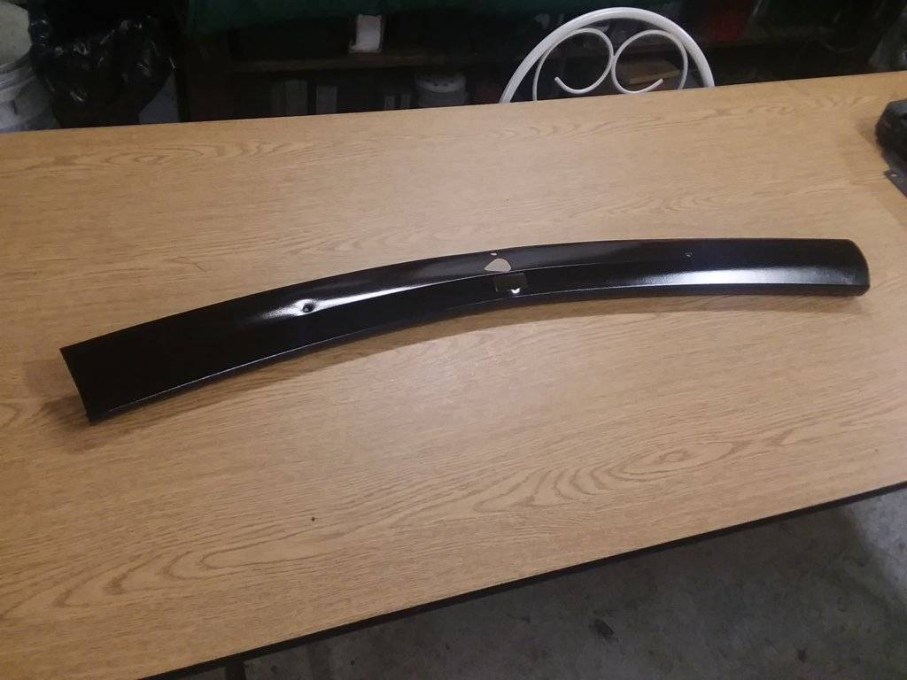

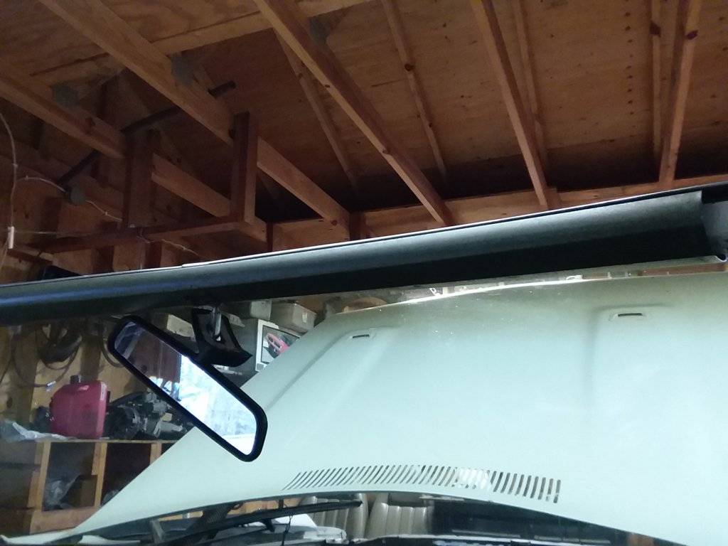

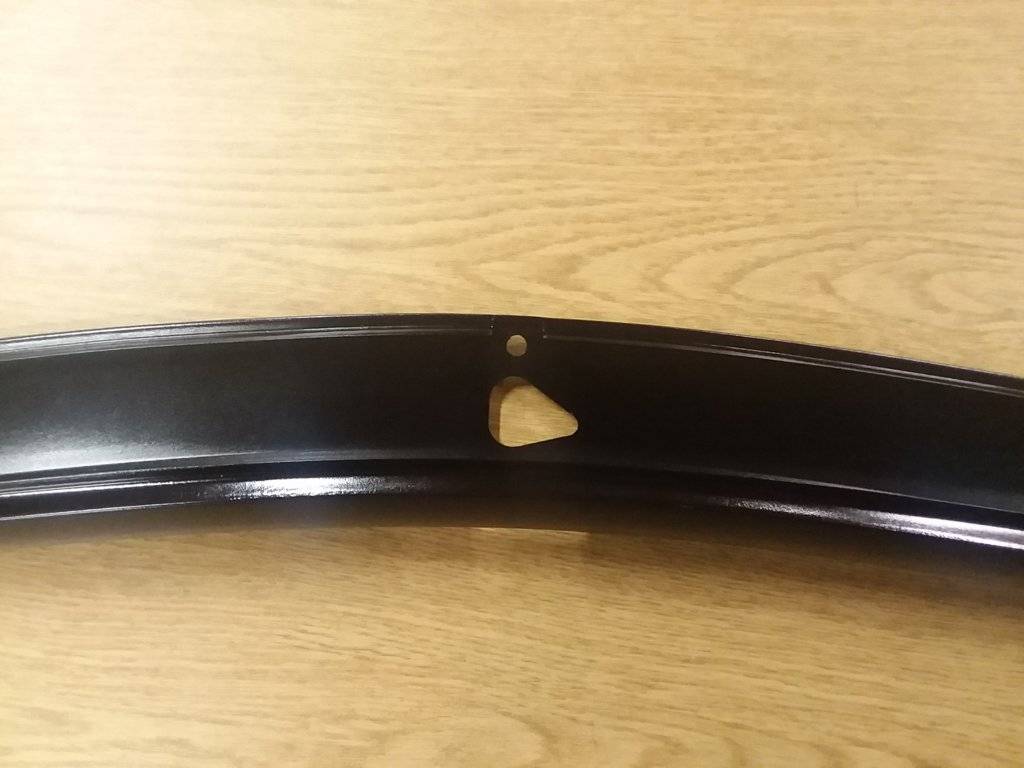

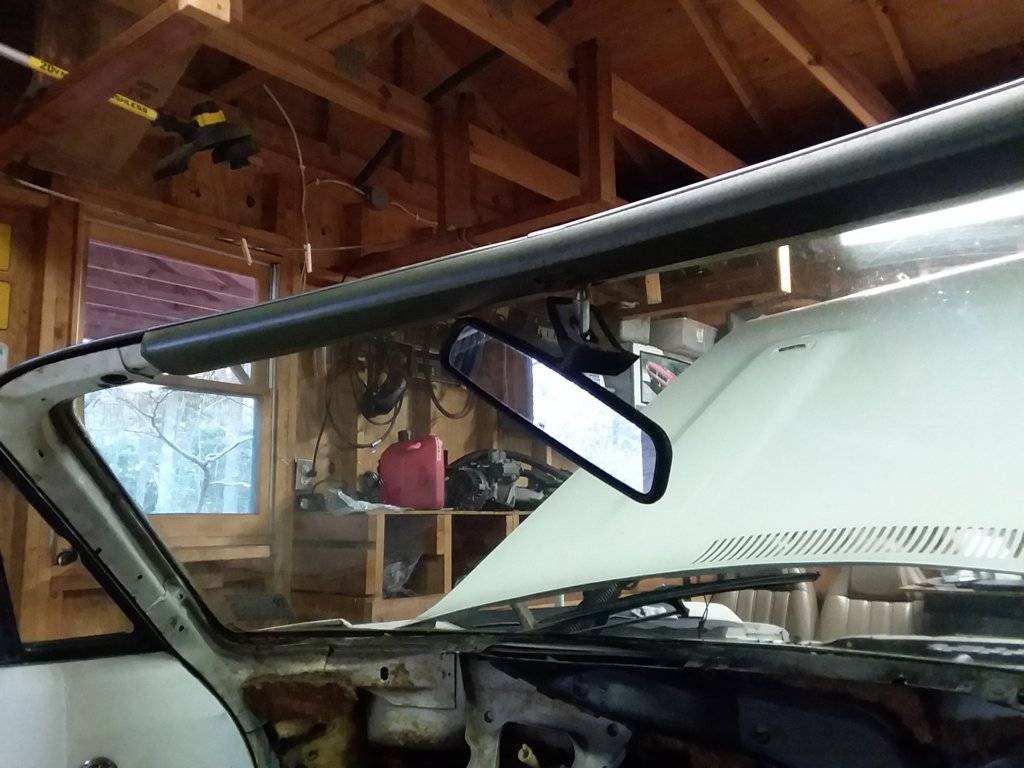

I finally got done with the header trim. The key was draping a towel over the top of the windshield frame and over top of the partially installed header trim, then pushing forward hard to get the header trim to seat in the clip above the rearview mirror mount. Everything else was just installing screws.
Before
After
Install Mirror Arm 1st, Test fit mirror
