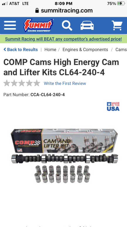

I visited the machine shop yesterday and was pleased with my interaction with them. We sat down and went over everything, called suppliers to check availability of parts and looked over different options. Basically, it will be .030 over, balanced rotating assembly, and milled to achieve around 9.1 comp. using cast flat top pistons. This cam or one close to it will be used depending on price and availability.
View attachment 579107 ouch. apparently in stock at summit. order now and have it for the shop to install as part of their assembly. 435 lift should have a great power band with that M/T and some gear. balanced assembly will spin up nice. gonna max out that 1bbl tho. what's a safe rev. limit f
View attachment 579107 ouch. apparently in stock at summit. order now and have it for the shop to install as part of their assembly. 435 lift should have a great power band with that M/T and some gear. balanced assembly will spin up nice. gonna max out that 1bbl tho. what's a safe rev. limit for a slant six?
I’ll not be going past 4500 much. We’ve found one cheaper than that but a different brand, can’t remember what. I must say, I got my wish for communication yesterday! My brain was scrambled by the time he was done going over everything. Talking about CC-ing the heads, piston depth, he was making on the fly calculations I couldn’t keep up with, but I’m not too sharp anyway! Lol.

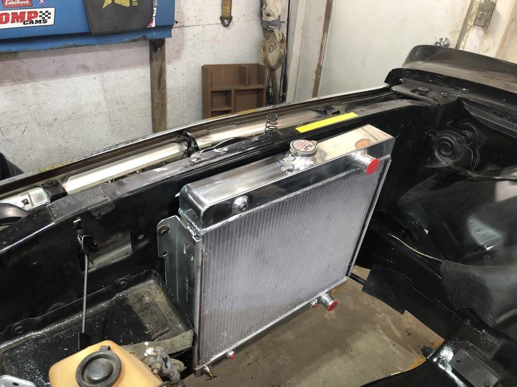

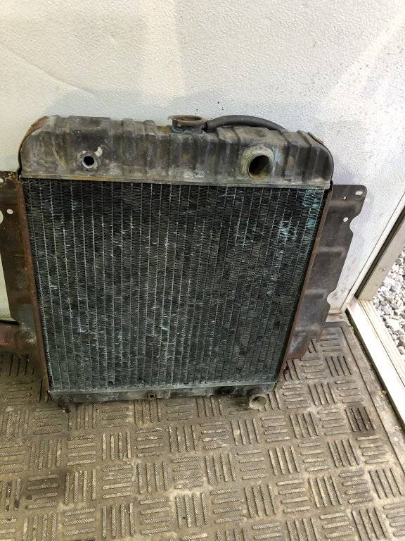

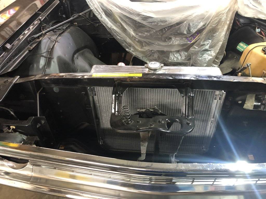

A close inspection of this radiator revealed it’s probably not worth putting in. It’s out of an auto car so it’s not right anyway. I’ll probably go with an aluminum one.

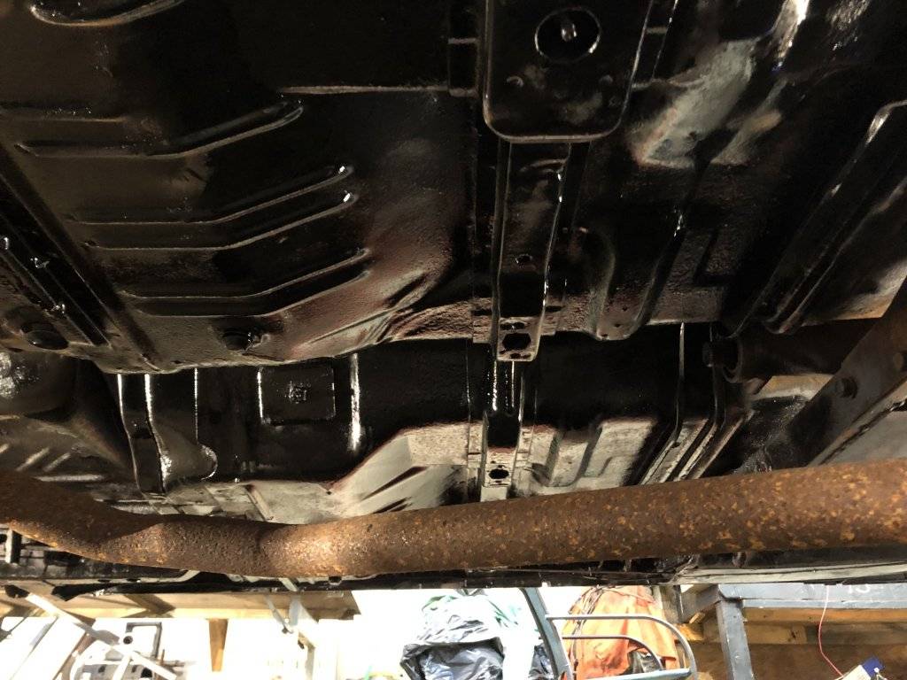

I’ve been scrubbing the underside, rust treating and painting. I don’t like undercoating. To me it traps moisture. This car never had any and it faired pretty well. I wire brushed, de-greased, soap and water with scrub brushes the best I could. Then I drenched it it rust treatment followed by Rustoleum. I’m not done yet but I’m satisfied that I’m doing it some good!
I’m anxious to drive this thing! Meanwhile, I’m enjoying the decent weather and hanging out in the garage with it.
