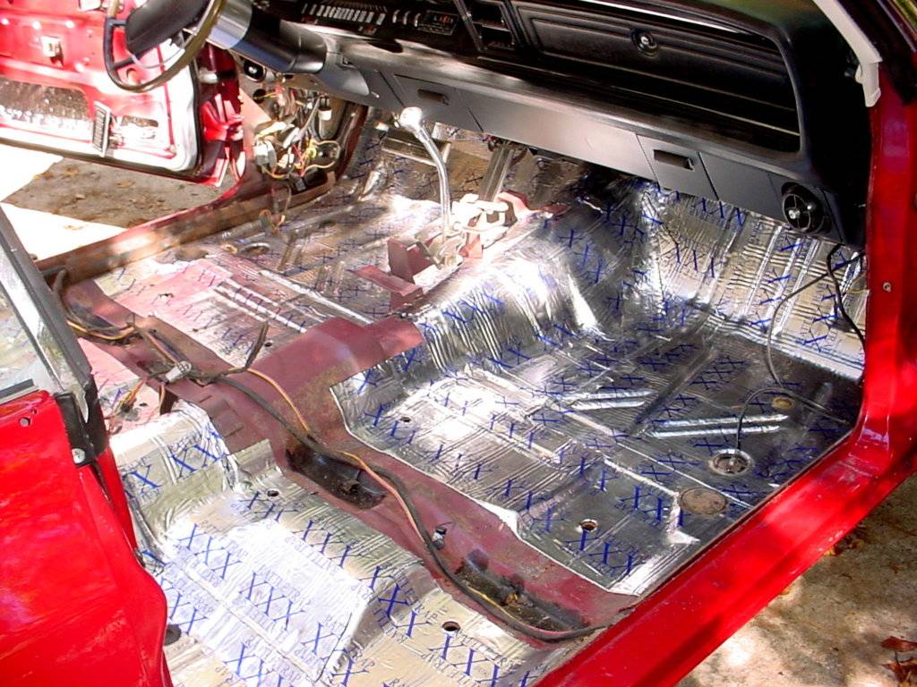

BTW I replaced my firewall insulation with dynamat sound proofng, a lot easier to install and it doesn't absorb moisture.
Good idea. I was leaning that way as well. As far as the factory holes in the upper front fender at the firewall on the interior side, just cover with the dynamat? No need to cut around them?
Dynamat is great. You'll find "fatmat" on ebay. equal quality at half the cost.

Well not really, the guy distributing Fatmat is a roofing material distributor and he sells roofing tape as a sound proofing product. Well it's not. Plus the self stick is designed for roofing not automotive and after awhile it becomes unstuck. You get what you pay for!
Dynamat ain't cheap, but it's really good stuff.

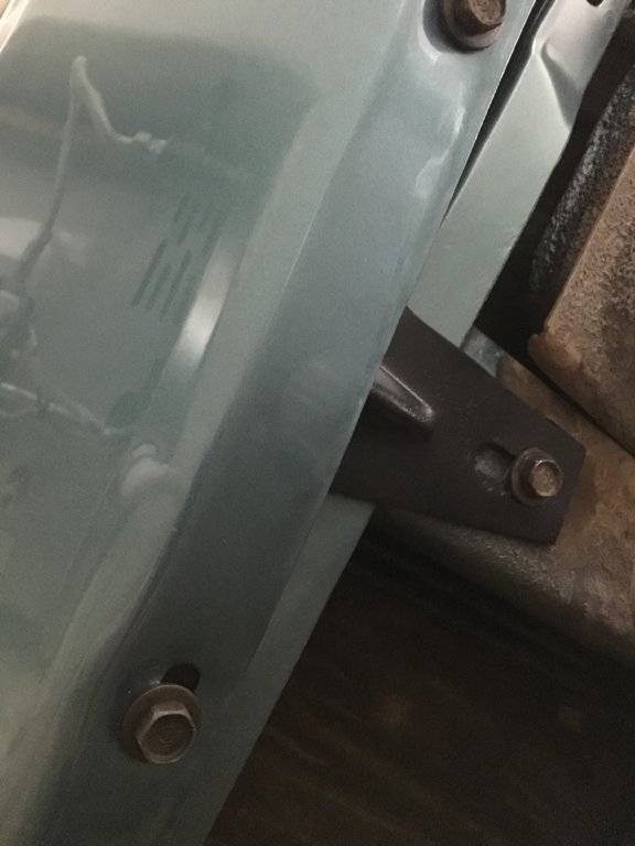

These holes

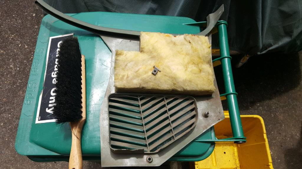

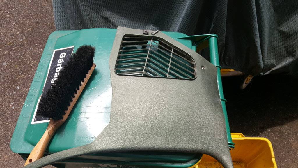

There is a plastic kick panel that covers that mess, and it includes a door with a cable to open and close it. These are the foot well fresh air vents. I didn't put dynamat there, but did put a foam weatherstrip around the vent hole so that when in the off position it actually stopped the air flow.
The kick panels get a yellow foam type backing material on them that helps insulate against them. DMT has those as well. That or you can use Dynamat.
Dynamat doesn't compress like foam so it wouldn't work well behind the kick panels. My factory foam was in bad shape so I used some weatherstrip from Home Depot.
Below are some pics of the kick panel.

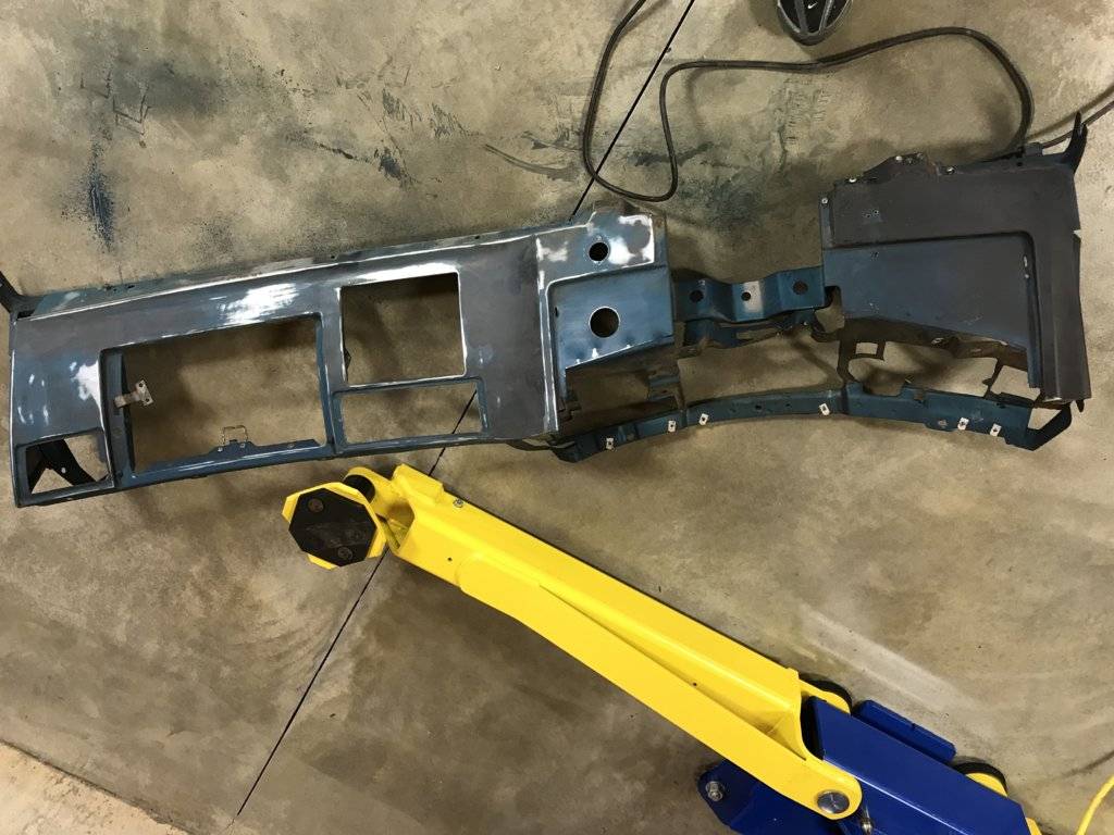

I actually have two nice kick panels. I was referencing the holes above the kick panels above where the dashboard frame bolts are. Can those be covered?
Don't see why not, the foam on the back of the kick panel already does it, but sound mat would give a better seal.
