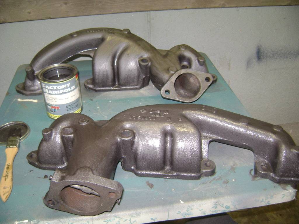

    HP manifold outlet is 2-1/2 same as the front pipes from TTi.
    The HP manifolds do have an advantage regarding better flow vs lo-po logs but still restrictve vs headers.
    HP do look sexy but hold heat for hours on end and known to cook valve cover gaskets,plug wires and pain in the ass to swap plugs.
    I have them and they are worth the third degree burns on my hands,LOL!!
    Personally the 2-1/2 TTi system works great. and the turn downs do not "look" too big on a C either. Their system is worth every penny,excellent fit,finish and sound.
    I had the system on 3 cars,two with the lo-po logs and the BoaB with HP.
    My 2 cents.

    Thanks @cbarge. Beautiful car and great pics. What paint/finish did you use on manifolds?

    After sand blasting them,scuffing them with steel wool I used POR15 brush on exhaust manifold paint. Seems to be holding up well 10,000 miles and third season driving.
