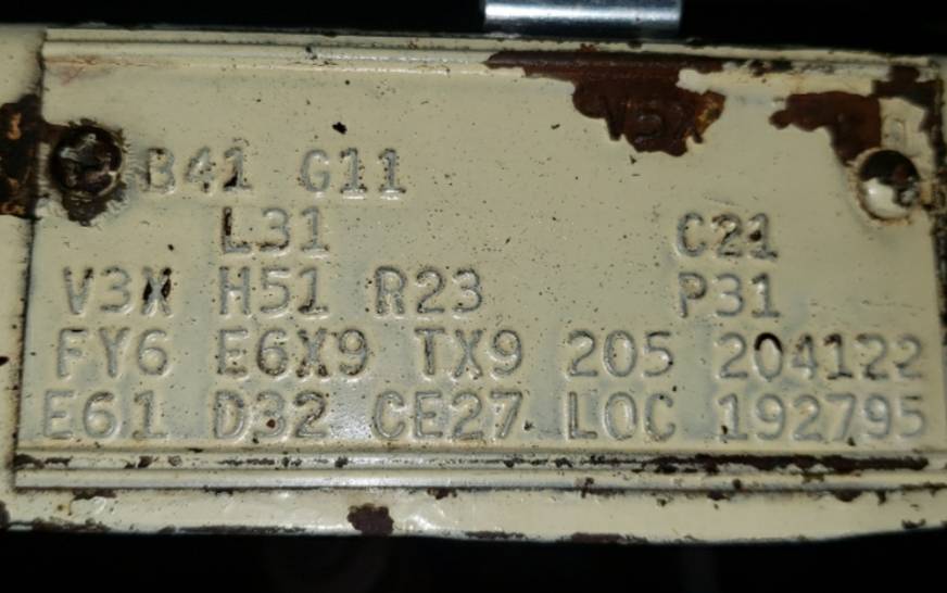

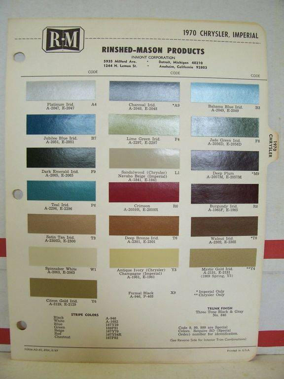

It is an original Y6 Citron Gold car and not a Y3, see picture below. Y3 by the way would be called Antique Ivory (like a cream color). A survivor, sorry I don't think so. It has a new carpet, and it is painted gold in the engine bay and yellow on the outside. It is interesting though with a power brake booster with a manual master. Very very nice car though overall.

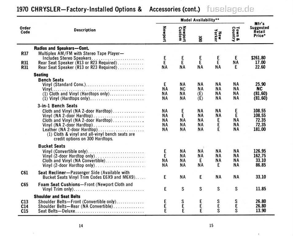

You have had your car how long and you don't know that your bucket seats are not correct then - assuming you have a Newport and the seats don't have buttons, yours are not correct. Perhaps yours were recovered in the past and the upholstery shop didn't bother putting the buttons back on.
I was going to say they were probably recovered. Legendary makes those seat covers, and they're perfect! But they don't come with the button's. They tell you that, and that they don't have them. I have yet to install mine, and I am still debating whether to install them or not. I have them all, and they're in good shape. It just "seams" wrong to poke holes in brand new beautiful seat covers. They do add a nice touch though. Seeing this cars interior is inspiring!
