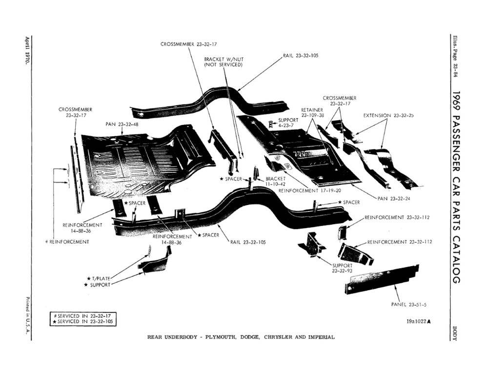

Not shown (this is 69) is the front floor section (one piece), the two floor sections (Pan 23-32-24/48) are shared between Dodge and Plymouth (and probably Chrysler), the Extensions (23-32-25) are where the difference is made. Forward or rear of the Extensions and you are good, the Extensions need to come from the same car.

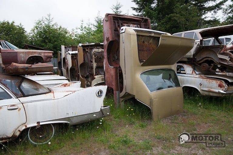

Call Wildcat and see if this one is still there. Long shot the pan is good with the trunk open.
