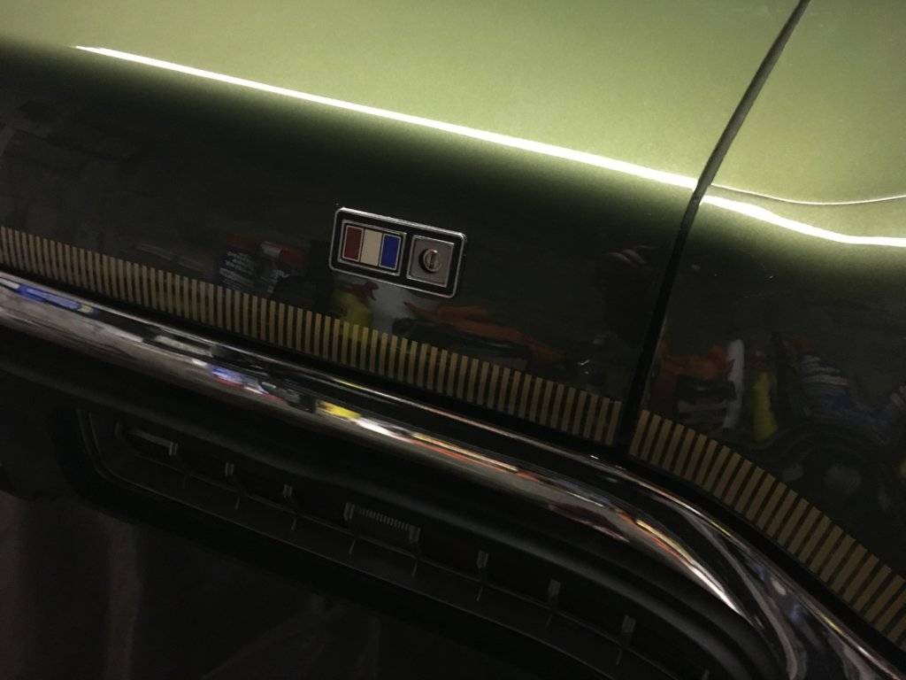

    I’m just coming into the tail end of things with finishing touches etc.
    1971 Plymouth Sport Fury
    2 door formal (fast top)
    Trim delete car
    318 - 904 - 8.25 rear
    GF7 Paint
    Brown Executive interior with floral inserts
    For the upgrades...
    Suspension:
    Viking tubular control arm
    Viking 10 way adjustable shocks
    Detroit heavy duty springs
    Drivetrain:
    Chrysler suregrip 3.21 gears
    904 trans - red bands, shift kit and 4 clutch pack
    TCI torque converter
    Motor:
    Original 318 bored and decked
    Mopar purple cam 340 spec
    Edelbrock RPM heads
    Edelbrock RPM airgap intake
    Hooker supercomp headers
    FiTech go street EFI
    MSD ready-to-run ignition
    Magnaflow full stainless 2.5 exhaust with “X” pipe
    *Note* Second tag is a different colour because I misplaced it while the car was at the paint shop...

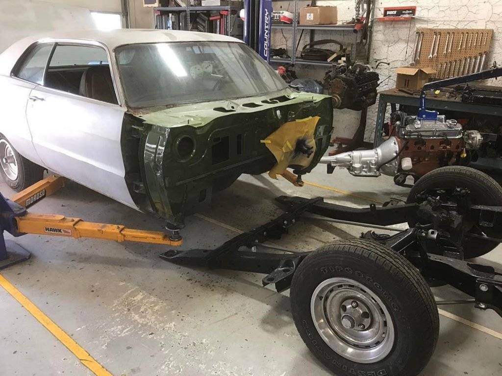

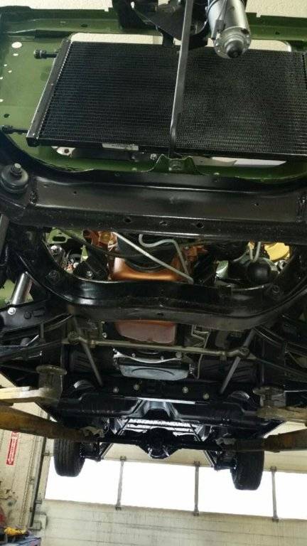

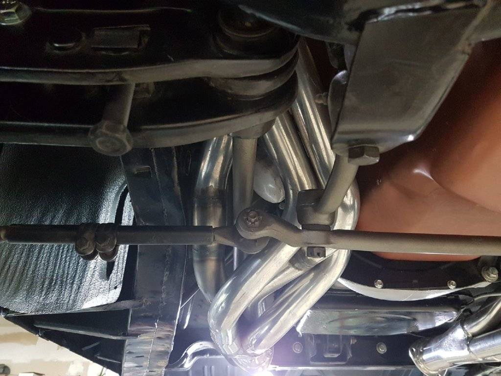

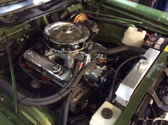

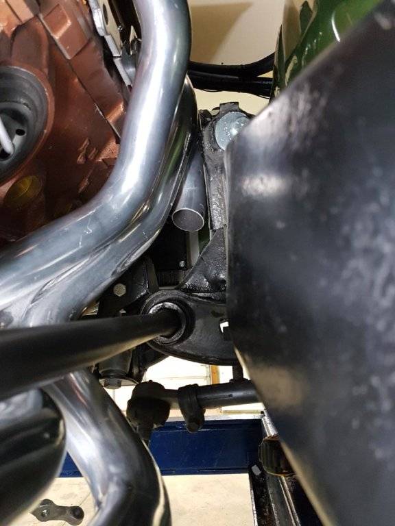

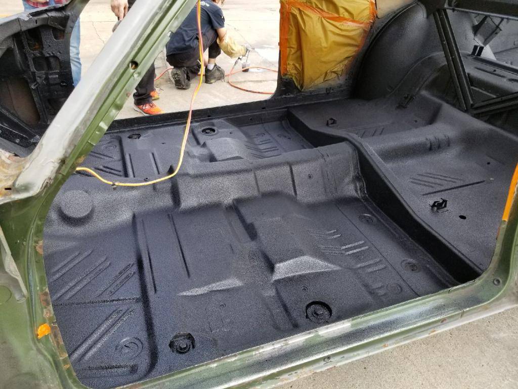

    Some photos from the Restoration

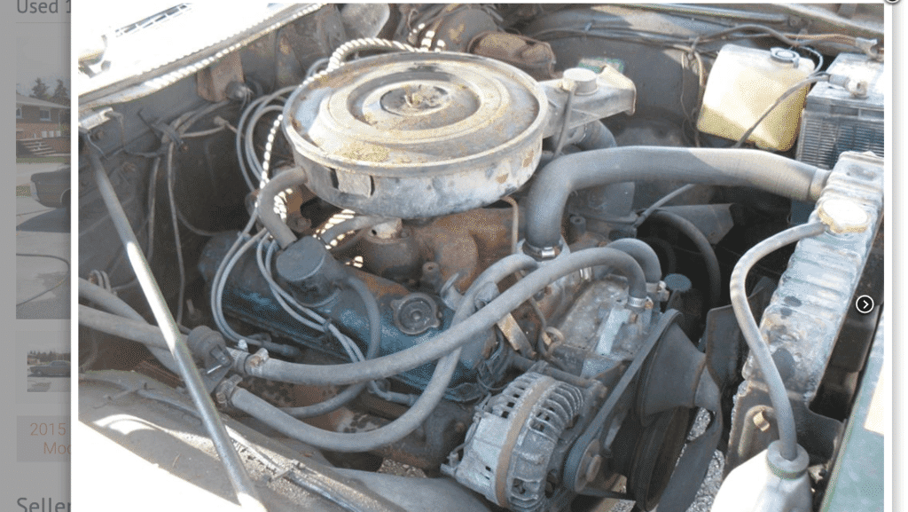

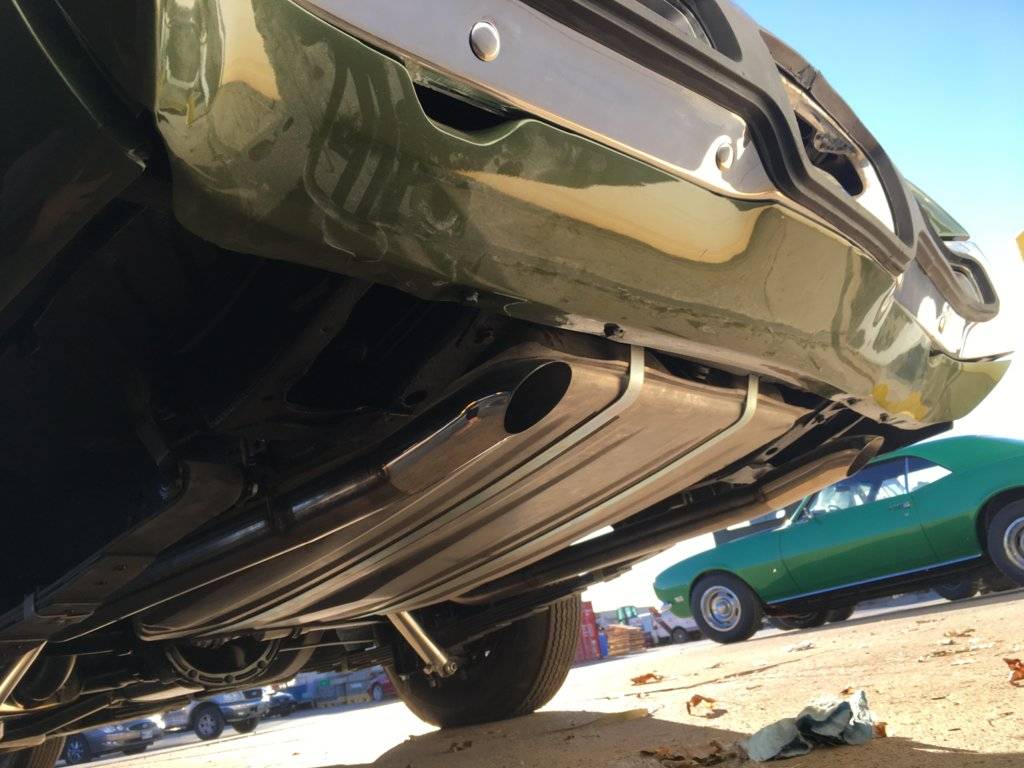

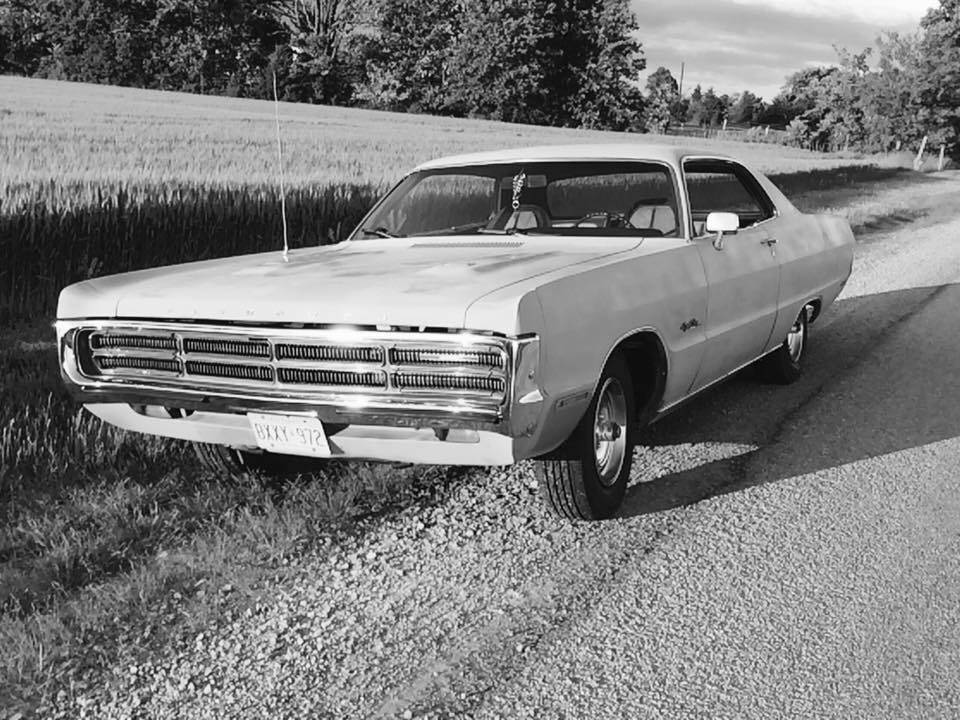

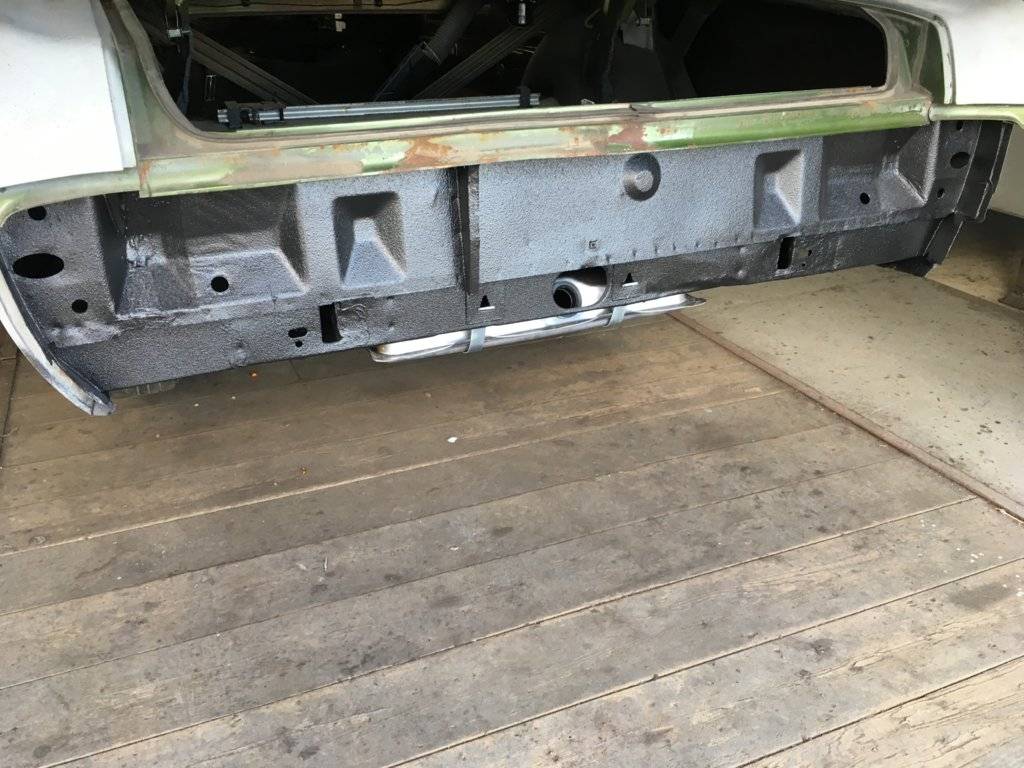

    A few more from the restoration and before
