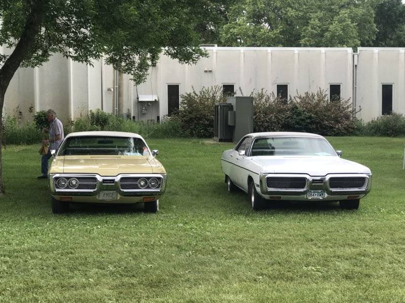

1972 Fury III 360 101498 miles
With exposed headlights and horizontal bars that front looks somehow angry. Thumps up for the look!
Agree! Love the exposed HL 72 grill. Also, @oliver warned me that it would look like "an angry vacuum cleaner" if I installed a hidden HL grill. Can't have that now can we.
I saw the hidden headlight grille first, so the exposed headlight grille made me stop and think for a moment. I like them both, the exposed looks tougher and the hidden classier. Or something like that, to me at least.
Car on the right is a member here, but he doesn't post.
I saw the hidden headlight grille first, so the exposed headlight grille made me stop and think for a moment. I like them both, the exposed looks tougher and the hidden classier. Or something like that, to me at least. Car on the right is a member here, but he doesn't post.
Is the tan car yours?

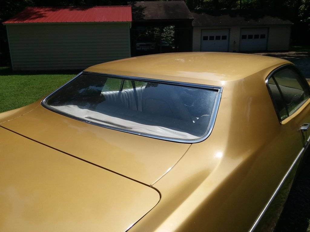

Look at the body around that rear window. Almost Pristine!
Given the color and previous experience with a rusted dutchman/trunk/rear subframe, the car was irresistible

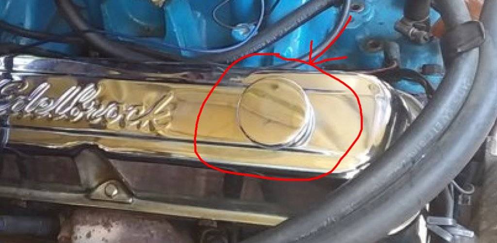

Oil Consumption, 1 quart in 600 miles. Seems like a lot, but maybe not for a 92000 mile 46 year-old motor. No leaks except tiny amount of drip at oil pan plug
· Fury has PCV valve, but no breather filter. PCV valve looks new, bottom of valve is dry, and PCV passes the shake test. The Edelbrock valve cover has a baffle below the PCV valve. I pulled the hose and it had a little oil at PCV fitting, and was completely dry at carburetor port. PCV hose does not show any evidence of sucking oil, like a drip. Is the PCV capable of drawing off that much oil if it’s totally malfunctioning and the system is not vented?
PCV
Baffle
No Breather
· Valve Seals and removing valve covers (@Wollfen suggestion on harmonic balancer check). All 8 spark plugs are dry. No smoke at exhaust. Is it worth it to replace the valve seals, if the spark plugs are dry and there is no blue smoke (or any colored smoke) in the exhaust?
· Engine Rebuild: there is no blue smoke coming out of the exhaust. So the last question is: am I missing something?
600 miles per quart is kind of high even for a 100k mileage engine, could be close to going round 2x. That's like a quart of oil every 2 tanks of gas.
The breather is important and I don't get why the chrome covers are missing the extra hole for one, maybe a 1/4 mile thing.
If you fix that do it like the stock set up, ie breather on 1 side and pvc on other valve cover.
Recently I saw a ad with a hopped up motor with chrome valve covers that had the breather inlet and PVC on the same valve cover. :BangHead::BangHead::BangHead:
I agree: either engine has 200K miles or it's not original to the car. Then, who knows? Engine Block ID Pad: 2D289 are the only characters on the pad. That does match part of the VIN, but the last 3 #s of the serial # are MIA. Jan 72 cast in block, May build date for Fury.
Ben... just out of curiosity, what weight motor oil are you using?
Oil consumption of 1 quart for every couple of tanks of gas is way too much.
If it’s not burning and going out the tail pipe, where is it going?
You say plugs are dry.
Something’s up.
I say check the valve stem seals and replace them if hard or broken. On a good running, smooth power producing engine, if the valve stem seals are bad it will burn oil under load a lot more than at idle and still not be enough to be visible. However, the engine will almost always puff smoke at start up from the oil entering the cylinders overnight but clear fairly quickly.
Without a breather to equalize the internal block pressure, I would think the engine will suck oil out of the cylinders past the oil ring on compression and power stroke ruining the rings and cylinder bores. So get one ASAP.
A heavier oil may keep your engine running longer but I fear you will need a rebuild fairly soon if the source of the loss does not make itself more obvious..... very soon.

Hi Javier.
Motor oil is 10W-40. Was thinking of going to 20W50
Valve seals: the car does smoke a little at start up. I was attributing that to the choke being partially closed and additional hydrocarbons in the exhaust. However, it could be accumulated oil from overnight. I was also thinking that the smart thing to do is pull the valve covers and replace the valve seals. I was thinking of ordering umbrella seals. Is that what you would use?
Breather: I was also thinking that maybe the lack of breather was contributing to to the oil consumption problem. I was thinking it would be pretty simple to get one of those oil caps, with the dome shape, that has a breather built-in.
The car is a puzzler. The engine has a January 19, 1972 production date, but doesn’t have the whole VIN serial number and all the information that is normally under the front of the left side head is sanded off. The 727 transmission has a May production date, which is a little late for a May production date car. And the 727 transmission has no VIN serial number. That plate is blank. The car cannot possibly have 200,000 miles on it. The body and undercarriage are just way too nice. I think the car really is a 90,000 mile car. But the hood not being properly adjusted and the car having been repainted makes me wonder if somebody pulled a high mileage engine to fake a numbers matching car and if the transmission is a replacement from early in the car’s vehicle history.
