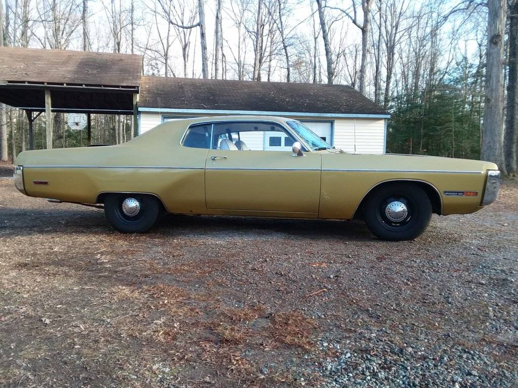

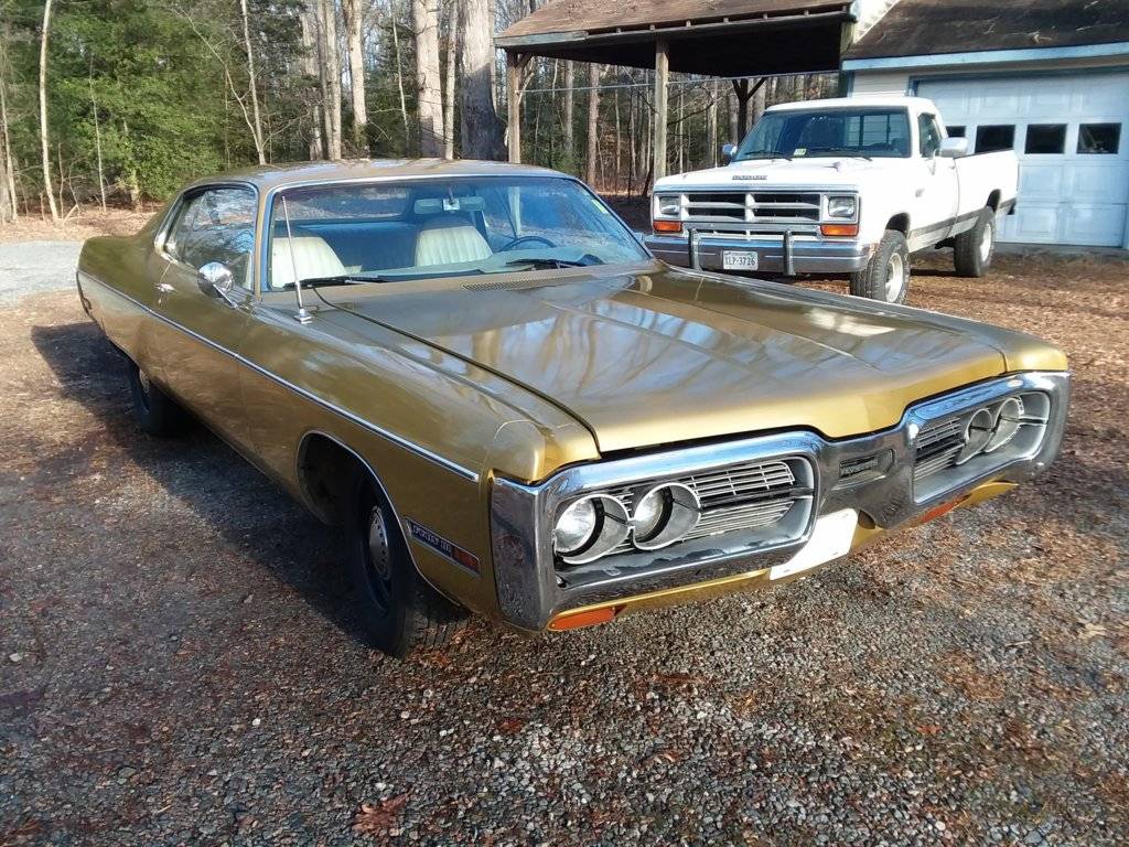

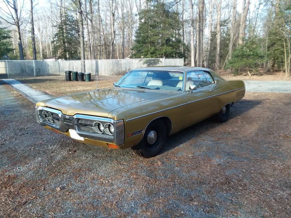

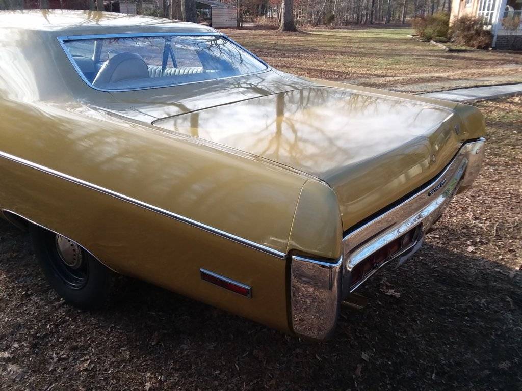

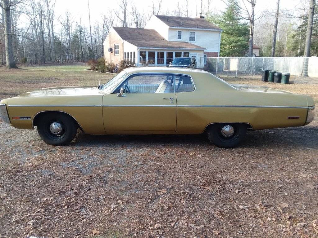

    I told myself over and over, “No more projects!” …while spending a lot of time looking on the Internet at what was for sale. I came across this 1972 Fury III in Winona Lake, Indiana. I love the gold, the coupe, no vinyl top (and no rust concealed under it), no AC. My willpower cracked and I had to have it. It was for sale for $5000, which I thought was a bit much given the condition. The owner was selling, because he had won the car as an unexpected prize at a charity golf tournament, where he was closest to the hole on number 8. He provided many photos and was good to deal with. We settled on $4000. I considered flying to Indianapolis and driving the car from Indiana to Virginia, but thankfully reason triumphed. I had it shipped to my home by Metrogistics for $745. I thought I’d introduce the car and start a project stream. The 1st set of pictures are after my family helped me wash it.

    Doesn't look like much of a project. I also like the coupe, color and no vinyl top. Nice Fury III.

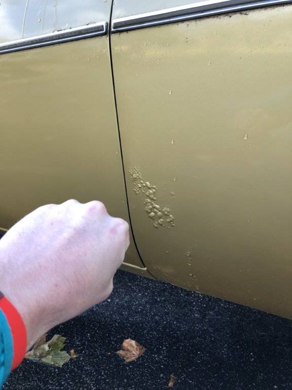

    Some trouble spots
    Rust at rear of RS front fender. Seller took the rest of these photos, honest of him
    Rust at rear corner LS door

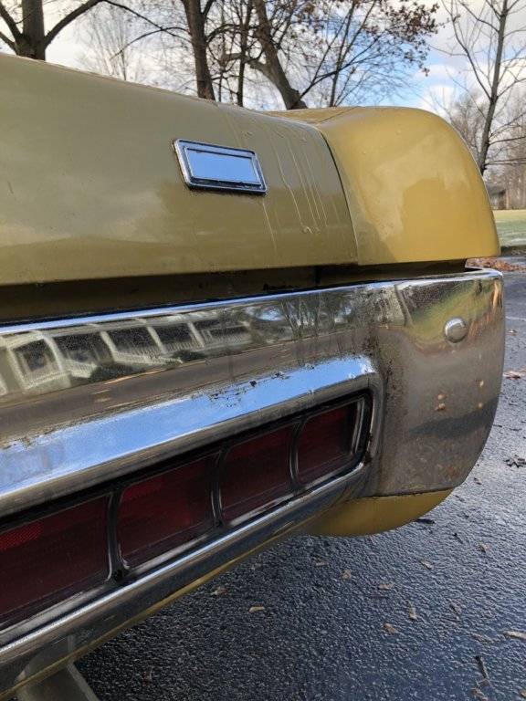

    Rust on both bumpers, not rust thru

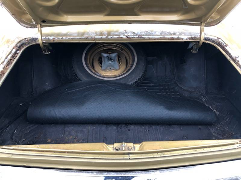

    A few small rust holes in trunk floor, but overall OK. I since cleaned out all the debris in the trunk weatherstrip valley. Only surface rust there
    Rust at RS rear of trunk

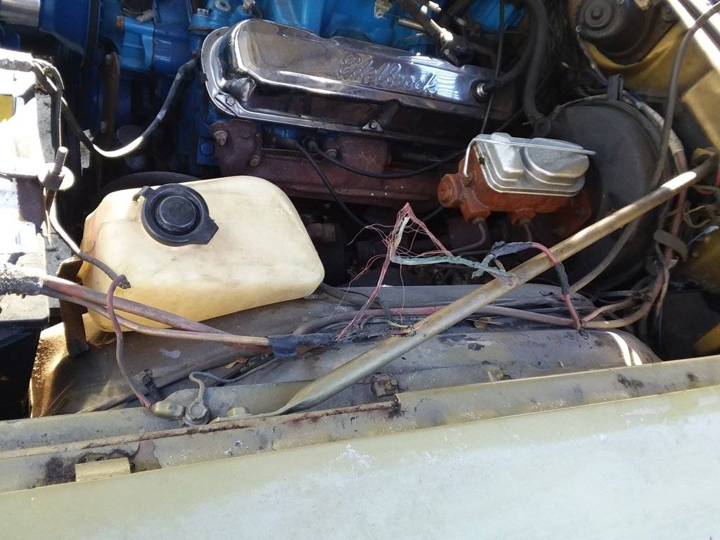

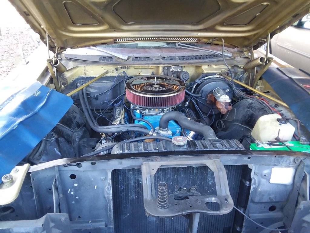

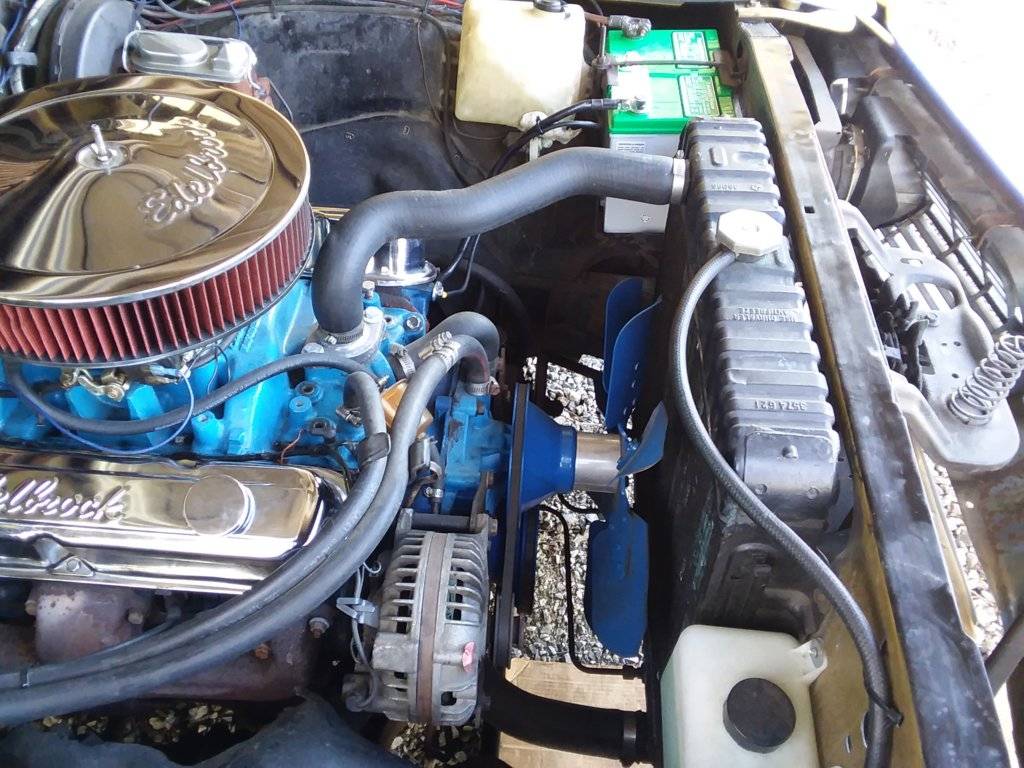

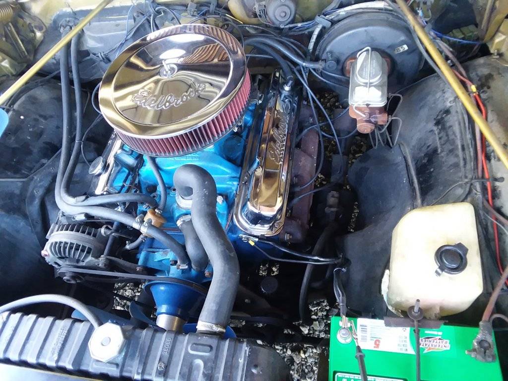

    Yes, converted to Edelbrock 4 bbl
    Depending on whether the engine was rebuilt or just repainted, the car could be a good deal

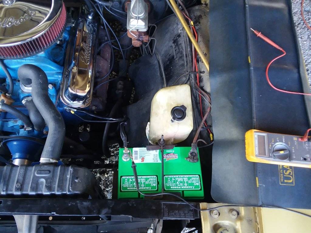

    The car came with a dead battery, some ground issues, overcharge due to poor voltage regulator ground. I have corrected all that.
    Charge wire, As delivered. It would jump start
    With new battery, negative cable, 2 ground wires, and repaired charge wire. It starts OK
    Otherwise engine looks good. Radiator was 1 gallon low, but other fluids OK
    20180120_143108.jpg 20180120_133252.jpg Bit of a rig on the carb. Wire tie throttle cable, kickdown linkage loose at throttle cable bracket, electric choke not connected to anything. Still have some work to do there
    After installing this old clip, I have a kickdown linkage

    My '72 Fury III (a long time ago) came with the 360-2V. That engine has the cam sprocket with the plastic teeth. It won't last much past 100k miles.

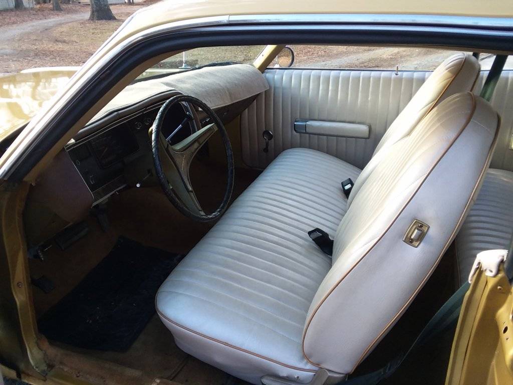

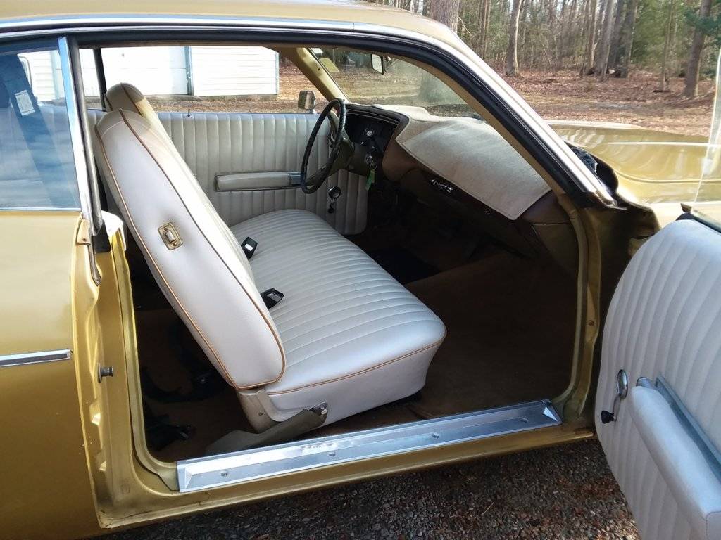

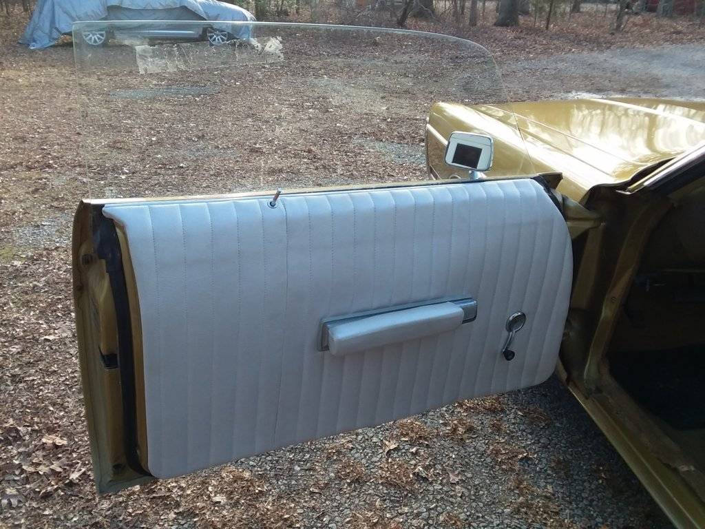

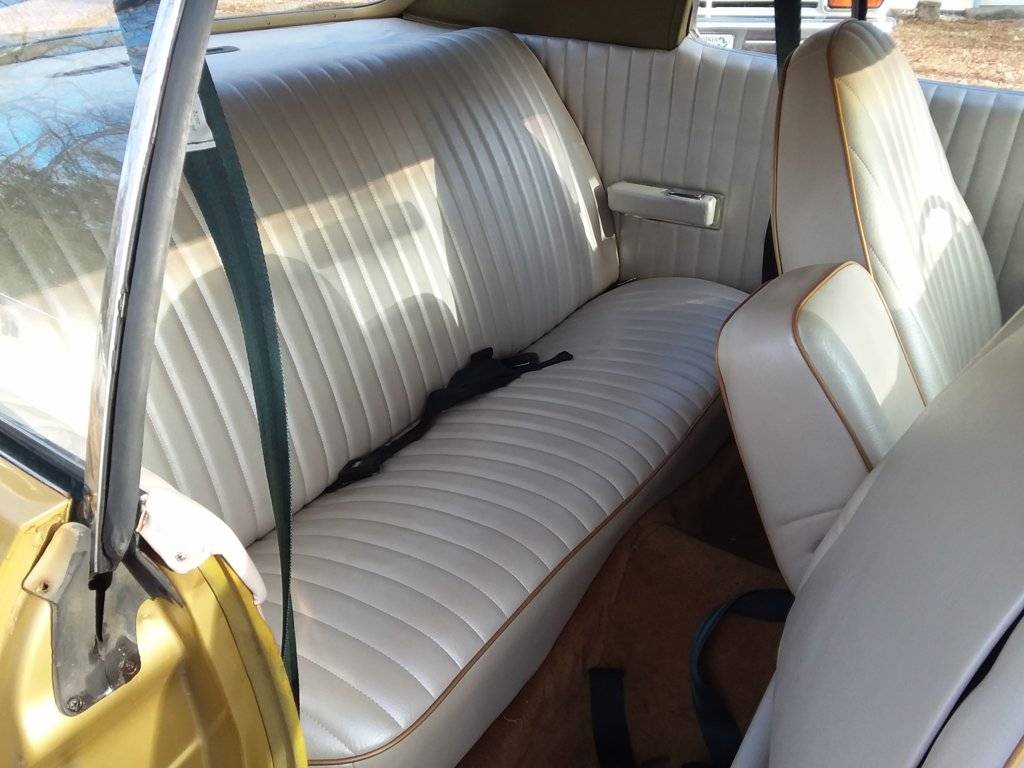

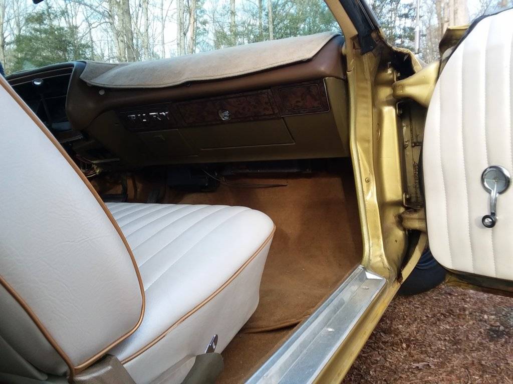

    Interior. The seats and door panels and quarter window panels were upholstered. It's not bad work. It looks like the kind of fabrication that the shops down in Tijuana did when I was in the Marines. We took our cars down there from Camp Pendleton, because we could get a new interior for $300. Problems: door panels not stock, no opening in door panel for remote adjust side mirror, no dome light in new head liner, big cracks in dash pad, headlights blink off and on (may just need switch rebuild)
    Seat belts are black. Don't know why that looks green

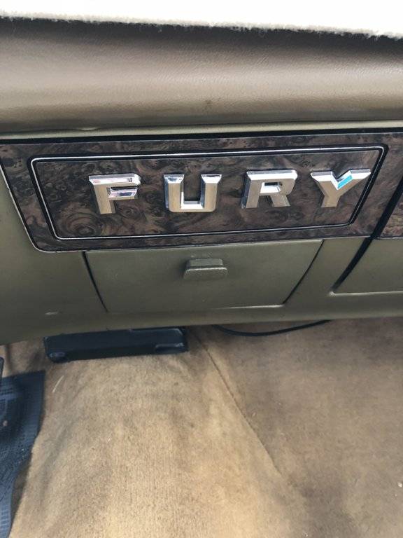

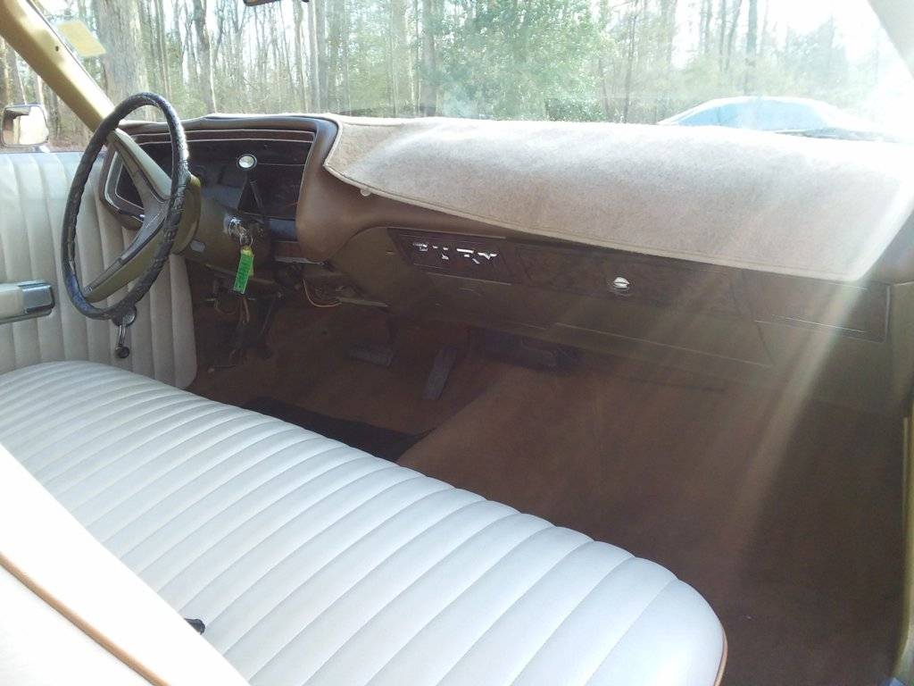

    I like the FURY lettering at the center vent delete. Looks a little off-center.

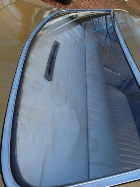

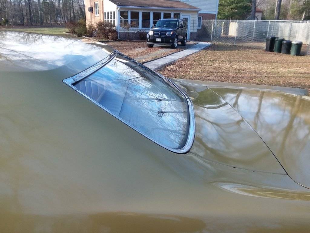

    Like the rear defrost
    Door frames look OK

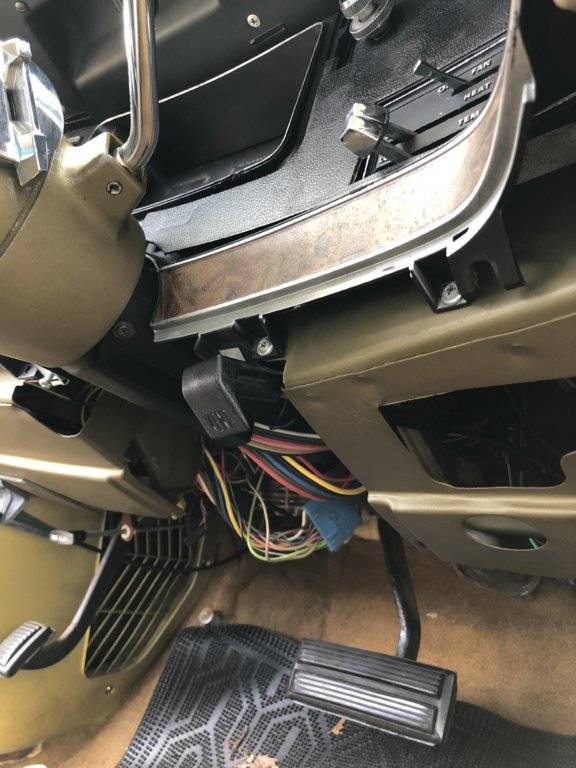

    Under column panel MIA

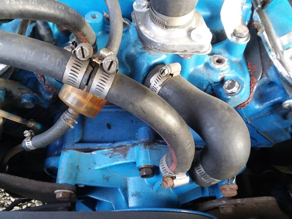

    Edelbrock intake, and carb. If you look at the colors of the water pump and intake vs rest of engine, looks like the timing chain wasn't done when they were. Still that paint might mean a rebuilt engine. Don't have proof yet.

    Looks to me as if the engine was rebuilt and the added the for barrel intake and water pump layer on ad an after thought. The engine looks way too clean for that vintage. Either way just drive it, put the new cam sprocket and chain on when it needs it. Not like it's an interference motor, you'll know when it's starting to go.

    I agree. Runs really well. I think it was rebuilt. Haven't checked if it is original yet.

    IMG_5662.jpeg Exposed headlights look great too.
    Will you do something about this?

    Hi Oliver. I hope the letters are stick on. If they come off easily, I might be able to remove the glue residue with Goo Gone. I’m afraid however, with older woodgrain, that the woodgrain will peel off with the letters. I intend to eventually do something to fix this, just not sure how much work it will be. As a matter of priorities, the letters are fairly far down the list. Priority number one was the charging system. That I’ve cured, and the car has no IOD. Priority number 2 is making the Edelbrock 1406 carb electric choke, throttle linkage, and kick down linkage work, which I’m almost finished doing. Priority number 3 is getting the taillights working. I’m hoping that will be pretty simple. After that, the car has other issues for operation or drivability, while the letters are purely a matter of looks. That said, I’ll get to those letters eventually, and they will go away.
