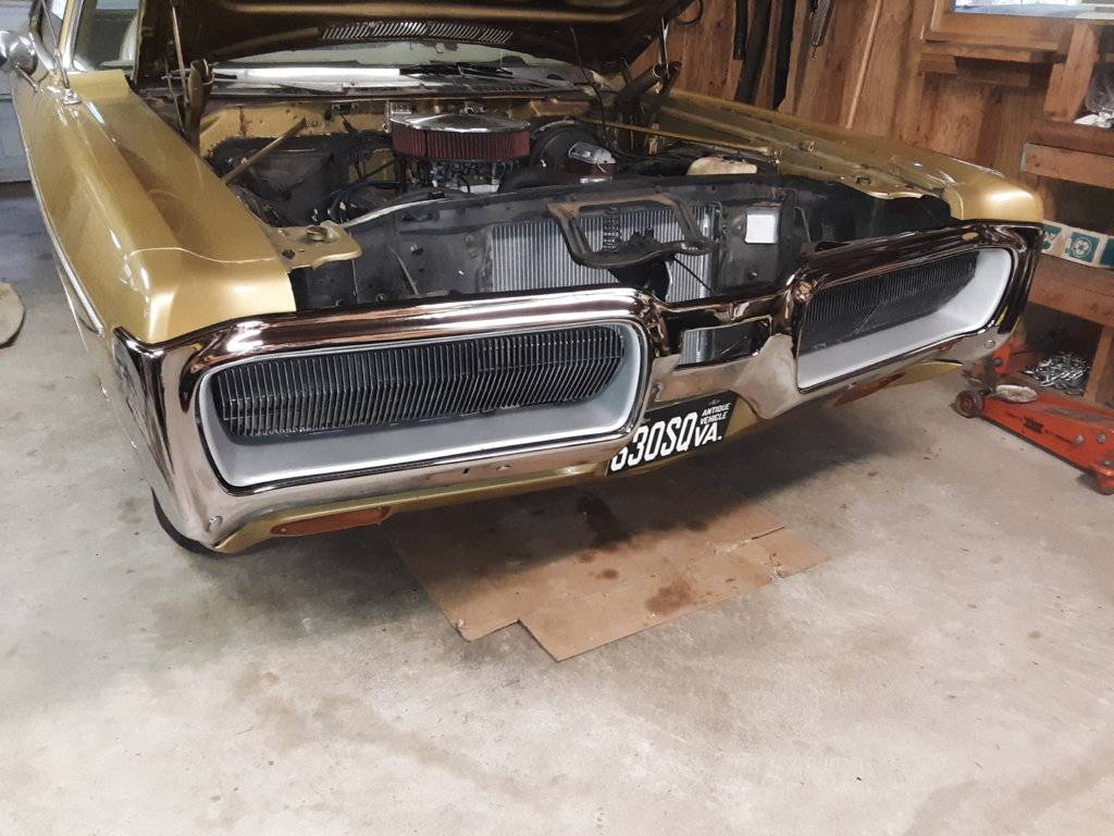

Upper Bumper Brackets
· place bracket under the hood bumper extension. Install mounting screw through extension into clip. Leave loose.
· Install 2nd mounting screw into back of chrome bumper. 7/16 short socket, 3/8 stub ratchet.
· Tighten first mounting screw at hood bumper extension, 7/16 short socket, 3 inch extension, 3/8 stub ratchet
RS
LS

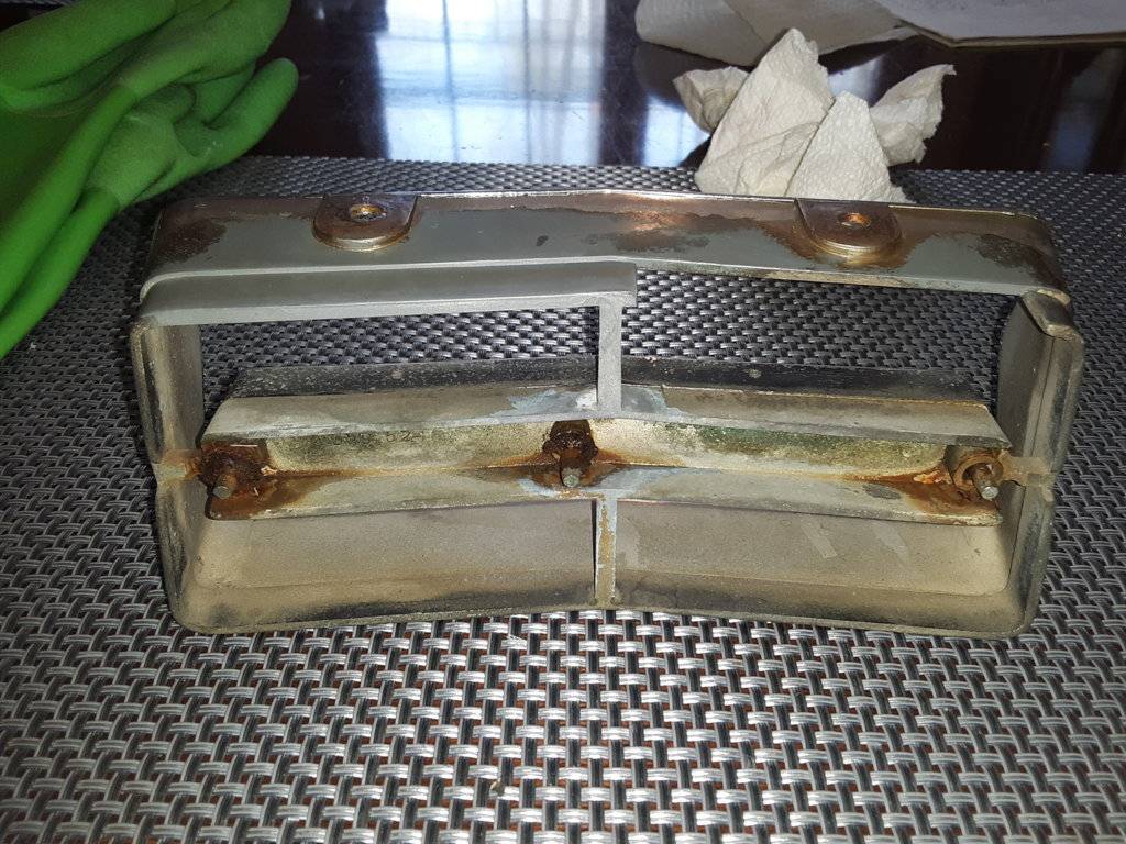

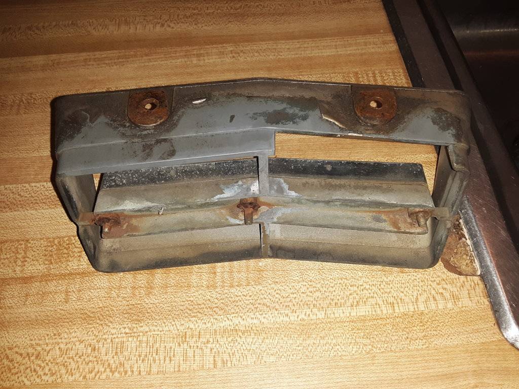

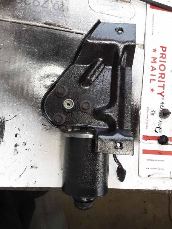

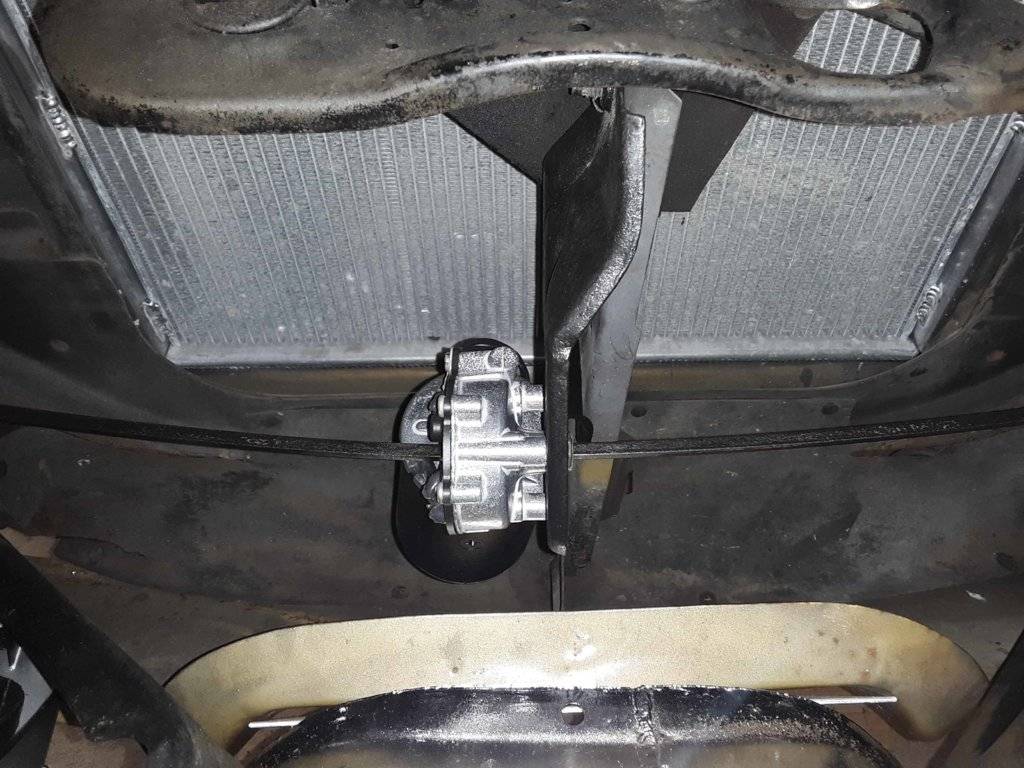

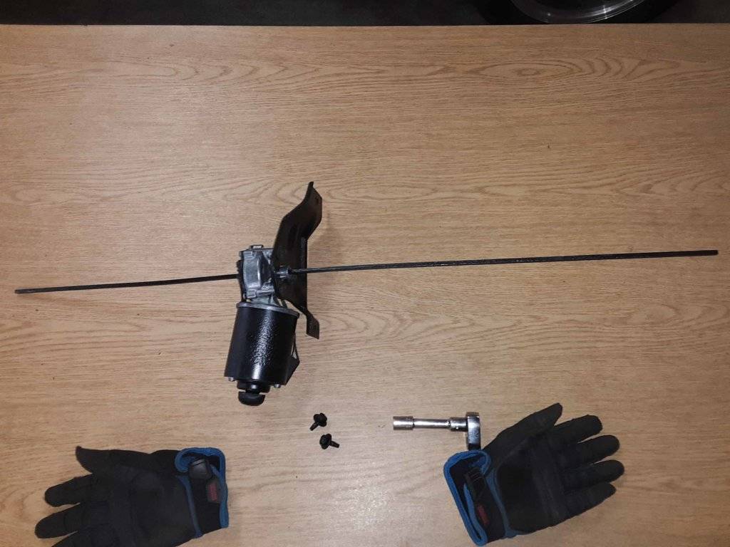

Grill Motor (rebuild $270 Jeff Wood, TX) & Mounting Bracket. Jeff said not to bench test motor, so I still don't know if it works.

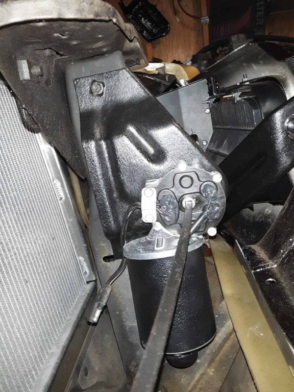

Grill Motor installed on bracket

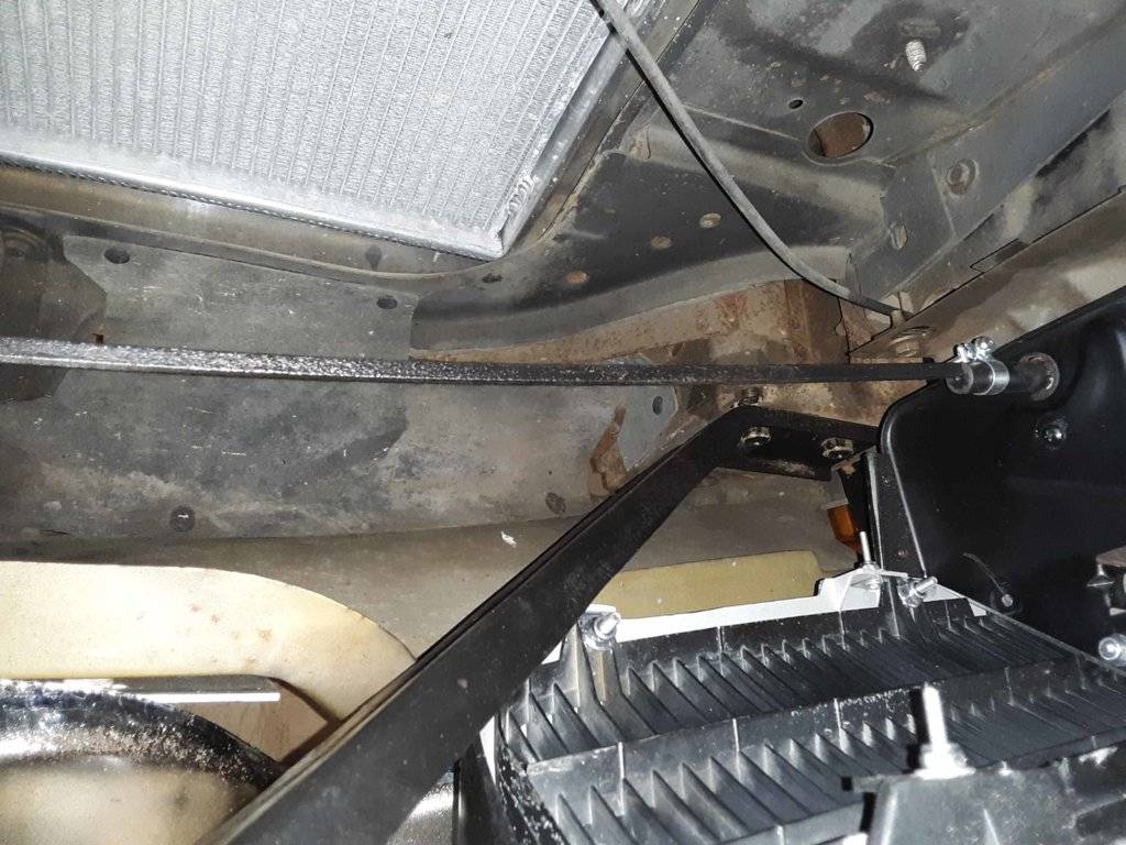

Grill motor rod: the rod is bent in a crescent shape. The ends of the crescent face rear, and the arc of the crescent faces forward. Shorter side of rod goes on right side of grill motor. Slide rod through grill motor.

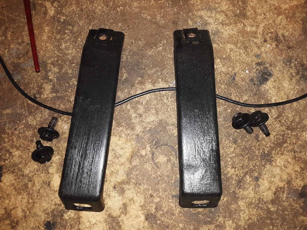

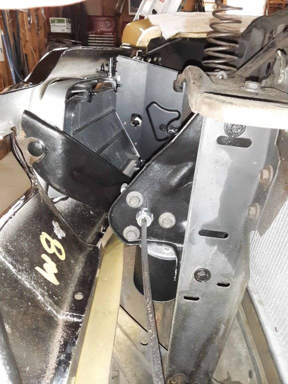

Grill motor, rod, bracket, install as assembly: Installed the 2 mounting bolts. The mounting bracket does not use the slots in the center vertical support for the hood latch. It uses the topmost circular hole and then the hole that matches that at the bottom of the bracket. Install the bolts from the left side, through the vertical hood latch support and into the 2 fittings on the grill motor mounting bracket. 7/16 short socket, 6 inch extension, 3/8 ratchet.
LS view
RS
From above

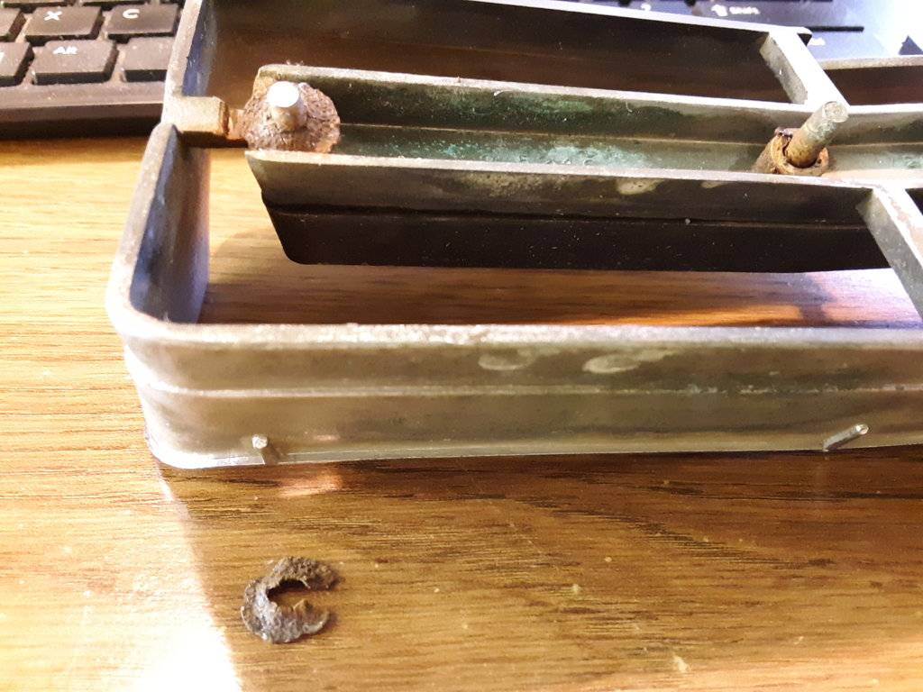

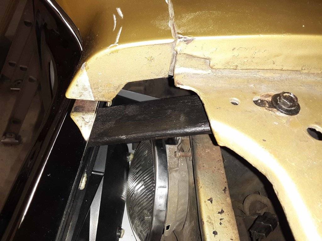

Flip up grill arms: with the rod evenly spaced versus the 2 arms, I found 7/8 inch distance from the end of the rod to the C clip that mounted the circular arm, extension of the flip up grill. I did not have the V-shaped clips that hold the rod to this arm in the mounting slots. I found 2 fuel hose clamps and placed them loose on the rod, one on the right side and the other on the left. Pressed the rod into the right side arm, slid the fuel hose clamp over the arm, tighten against arm to hold rod within slot on arm, 9/32 inch short socket, 10 inch extension, ¼ ratchet. Same procedure left side.
LS

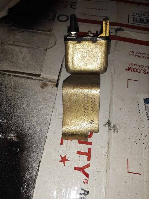

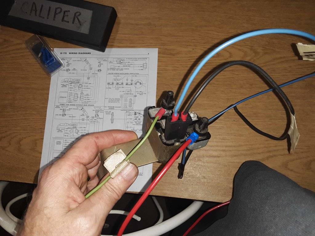

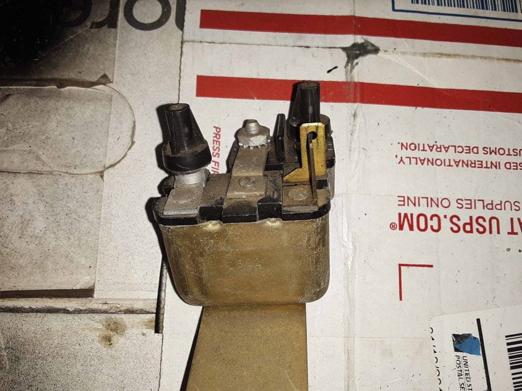

Grill Motor Relay
Part#, cast

The only thing that I found was different was that the Bl/Y and BK/R wires needed to be reversed from the diagram. Here I have them mounted according to diagram.

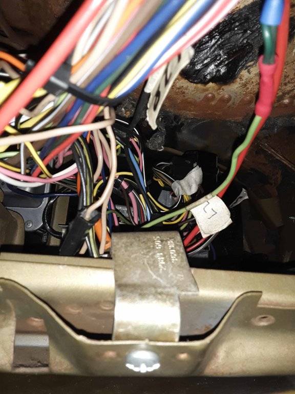

Red 12 gage wire is input power, 28", from ignition on auxiliary fuse box
Light Green 16 gage wire is actuator, 8", Connected to open HL delay relay connector
BL/Y wire, output power to close grill, 24" to get thru firewall, male bullet connector on opposite end
BK/R wire, output power to open grill, 24" to get thru firewall, male bullet connector on opposite end
I had to reverse BL/Y & BK/R in that black connector, because HL were on with grill closed and off with grill open. Did that while laying under dash.
Grill Motor Relay Mount on dash shell, lower edge
Grill Motor Relay wiring under dash. Black & Blue are now in correct position. (I know the wires need to be taped. Will happen later what dash pad and shell are off car.)
Headlight Delay Relay (open female bullet connector), 16 gage wire and correct color, obvious choice for activation signal current

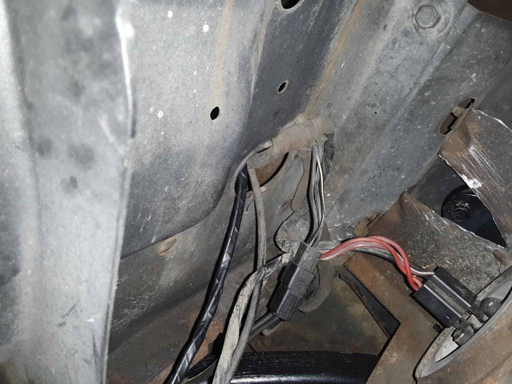

Engine Compartment Wiring. @kyle340 sent me the wiring harness for engine side, so this was easy
2-wire connector and ground wire at grill motor. Grill motor housing had .2 ohms resistance to ground after ground wire connected at fender.

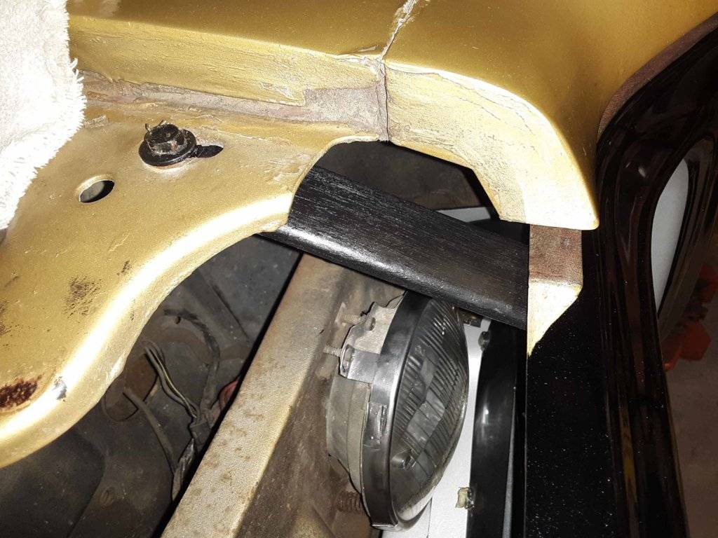

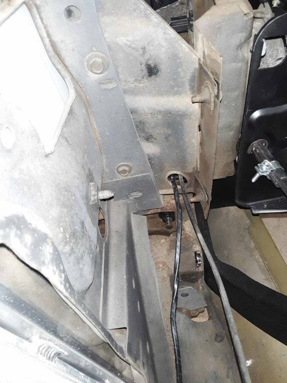

Ran thru opening in headlight vertical support. Hood release cable also runs here.
Thru opening in radiator sppt panel
Along top of wheel Well. Installed female bullet connectors at firewall ends and connected blue to blue and black to black. Attached other end of ground wire at battery body ground on fender.

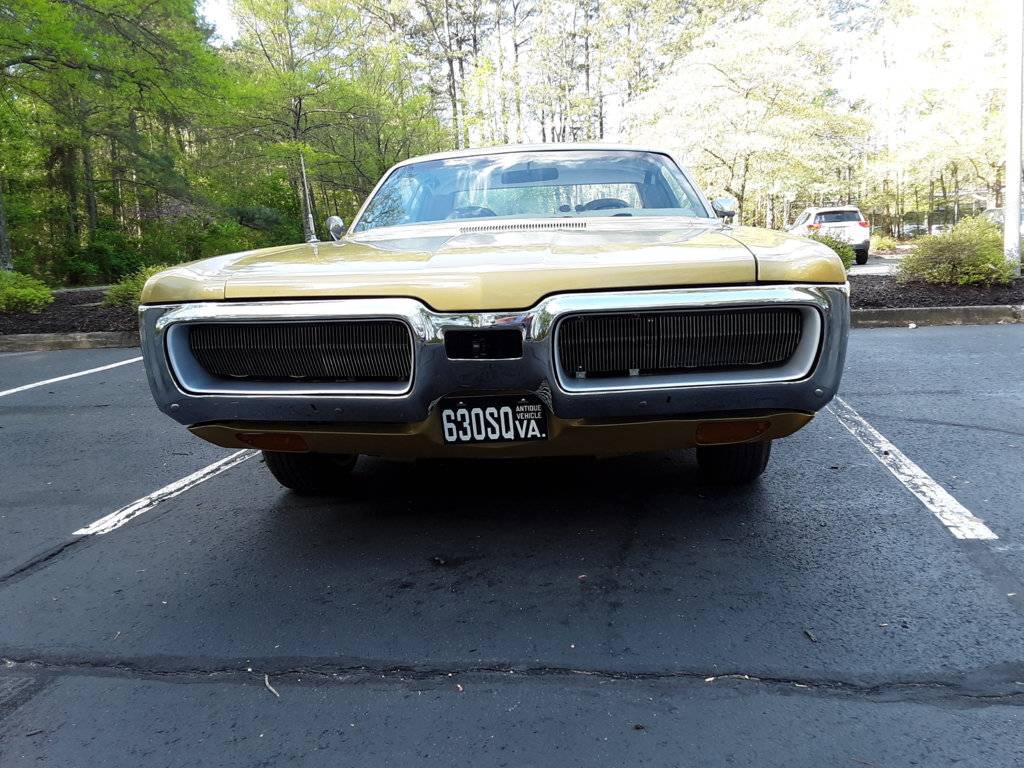

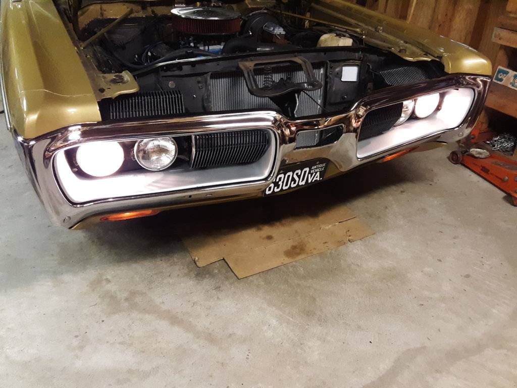

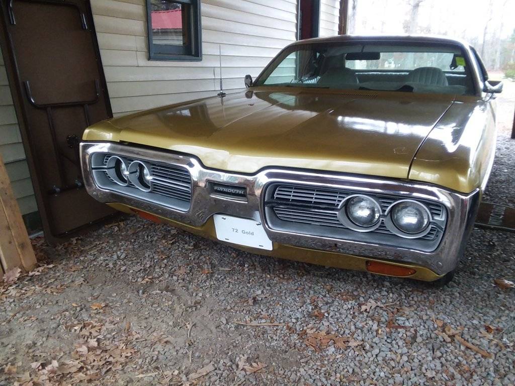

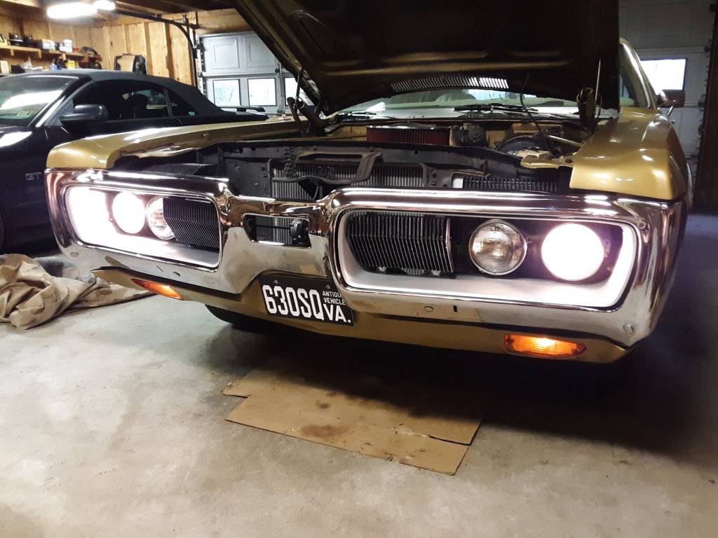

Test: Grill motor opened and closed flip up grills, no problem. Headlight switch off
Headlight switch on

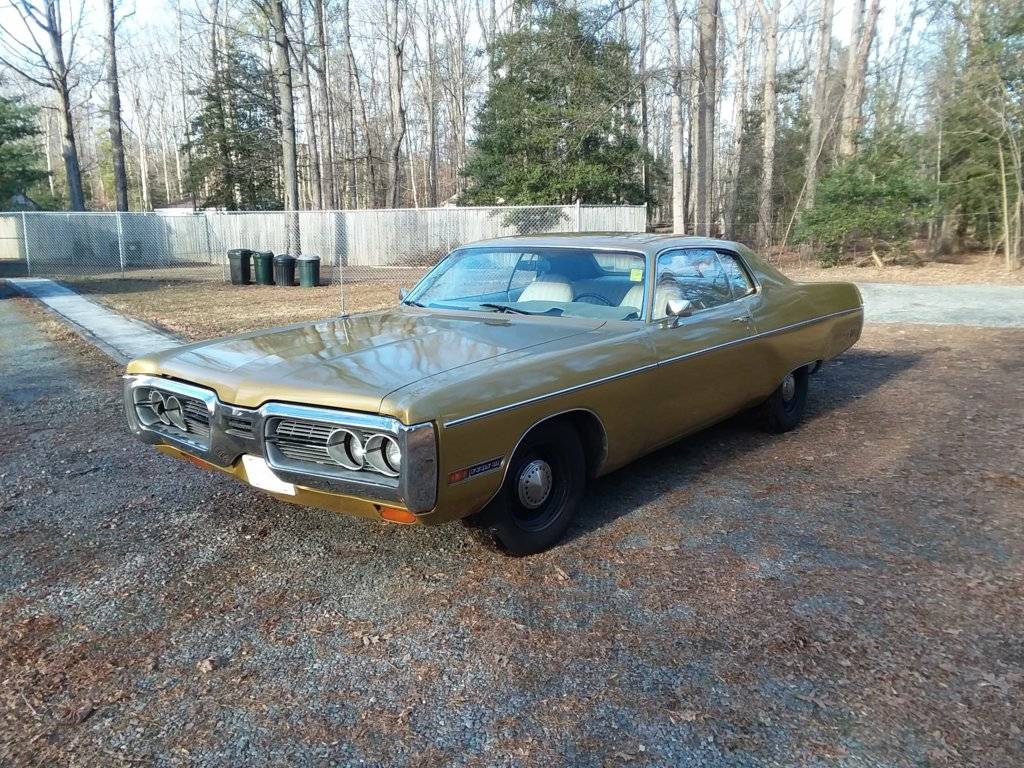

After more than 2 months on gathering parts and getting this project together, felt good to see the grill finally operational
Scott: I like the open HL grill

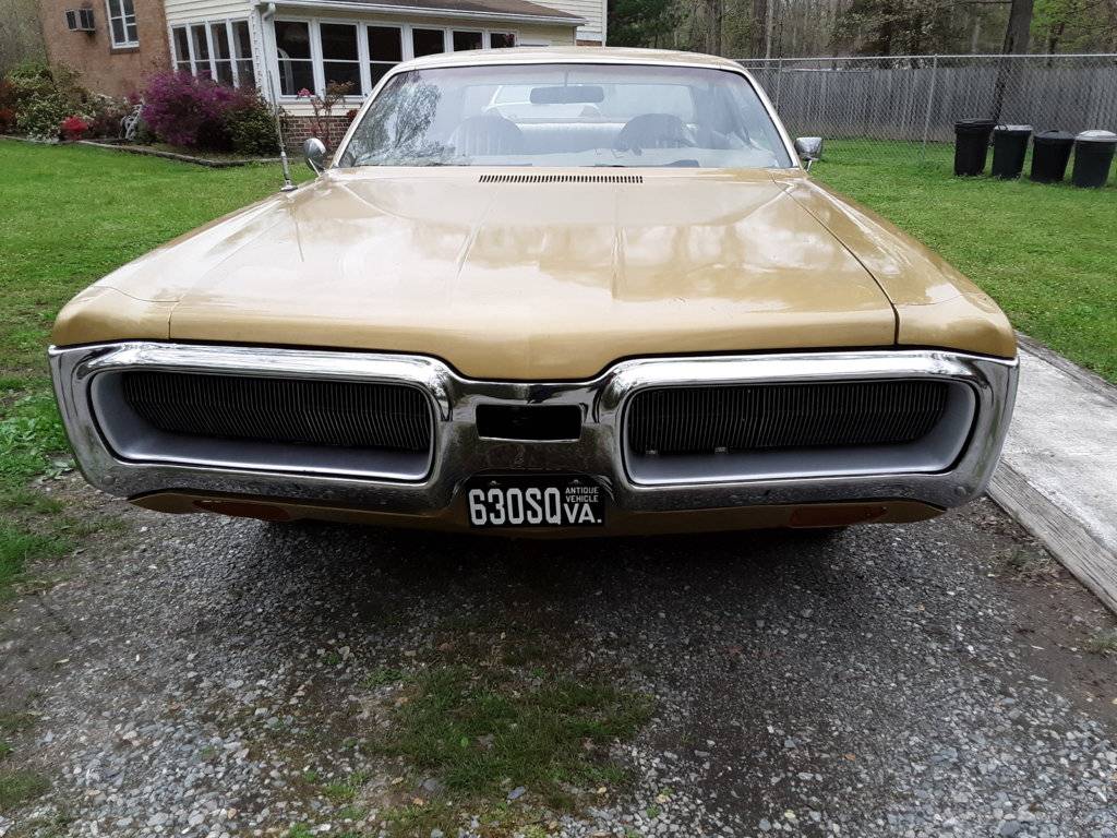

But with the gold paint I just had to have hidden headlights (Note: I'm still restoring center emblem for chrome bumper)
Quarter view

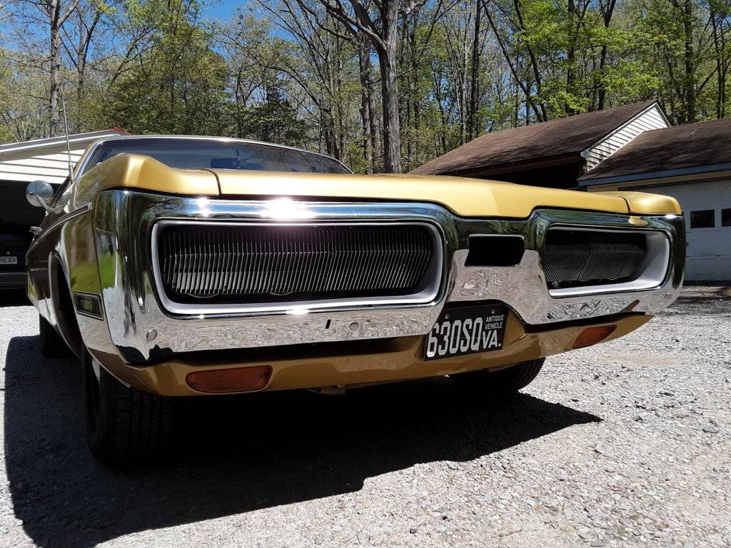

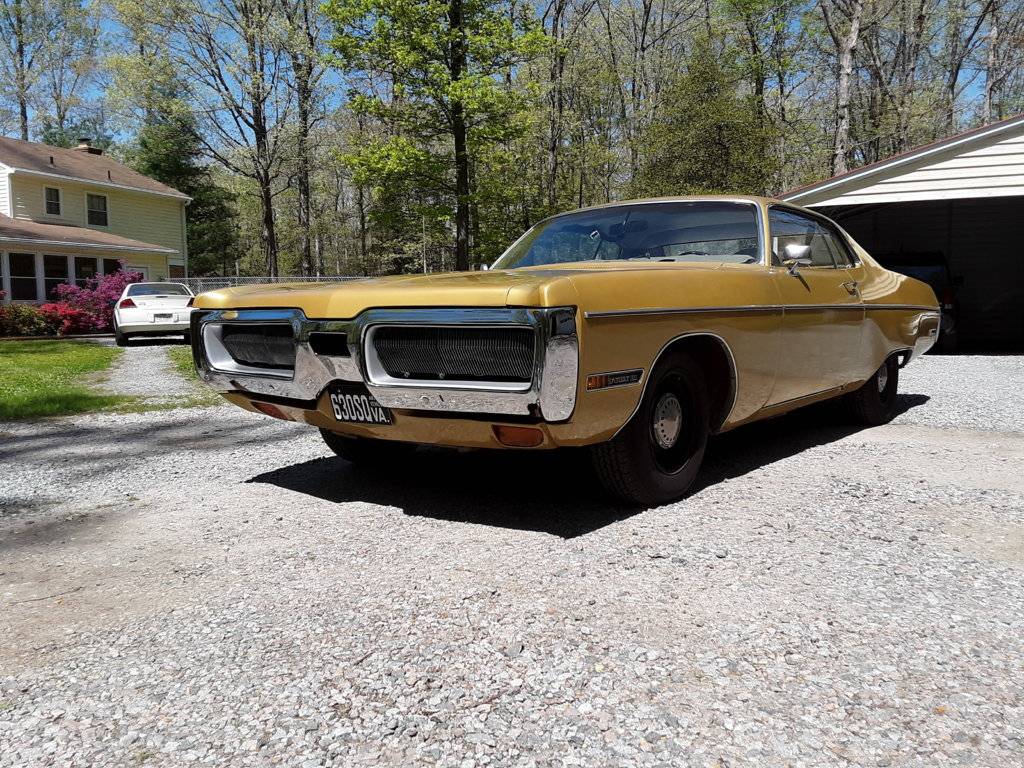

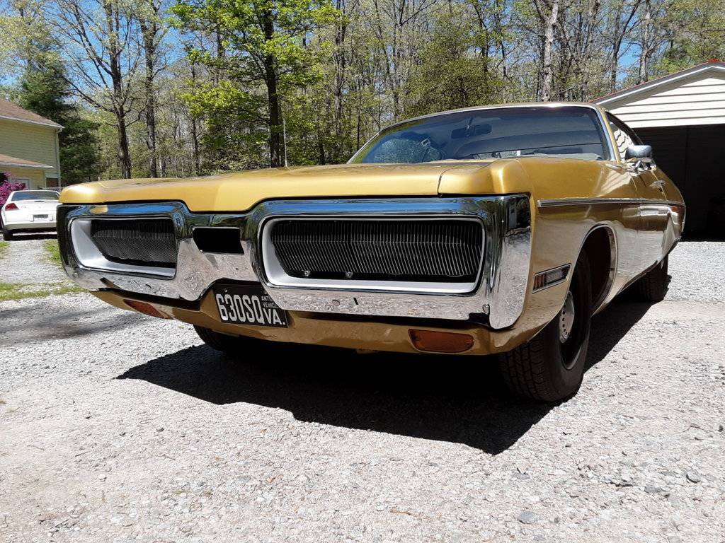

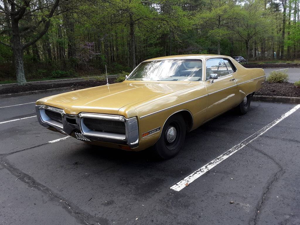

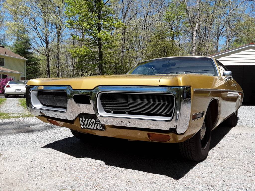

Awesome drive to work today
1972 Gold Fury Coupe lurking in parking lot
Imagine having that car coming up behind you at high speed on the highway.

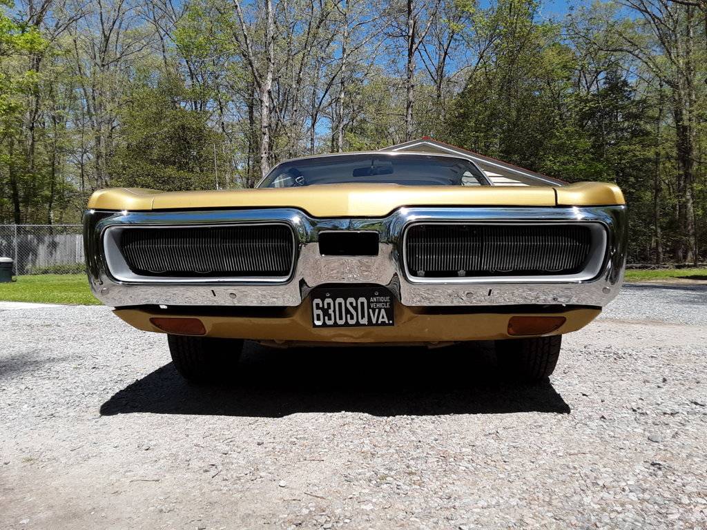

Gotta post some pics in the sun

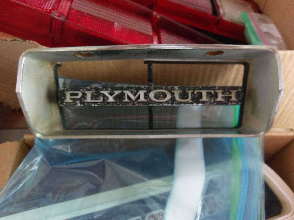

Hey Dan. Speaking of always cool and looking good. Check out these pictures in the sun:

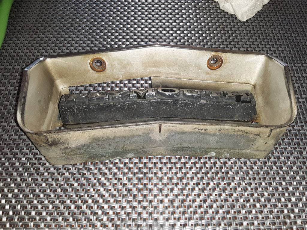

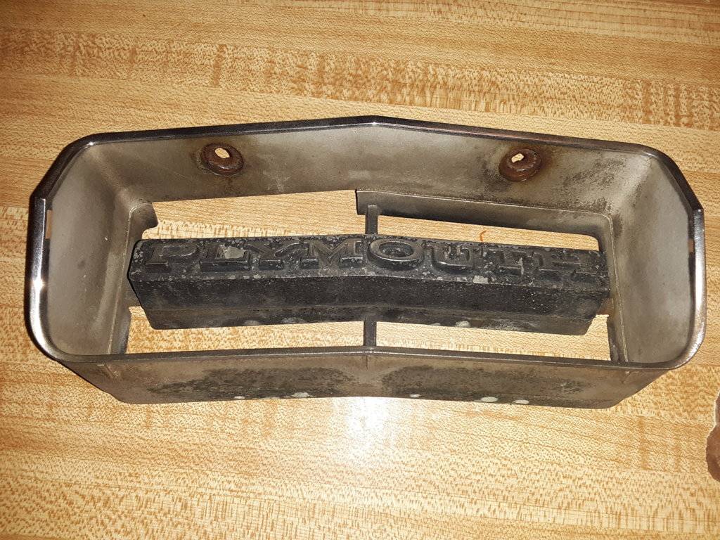

Plymouth Emblem, Center Chrome Front Bumper
Pics from last 3 days after work
Dirty
After Dawn & scratch pad, no improvement

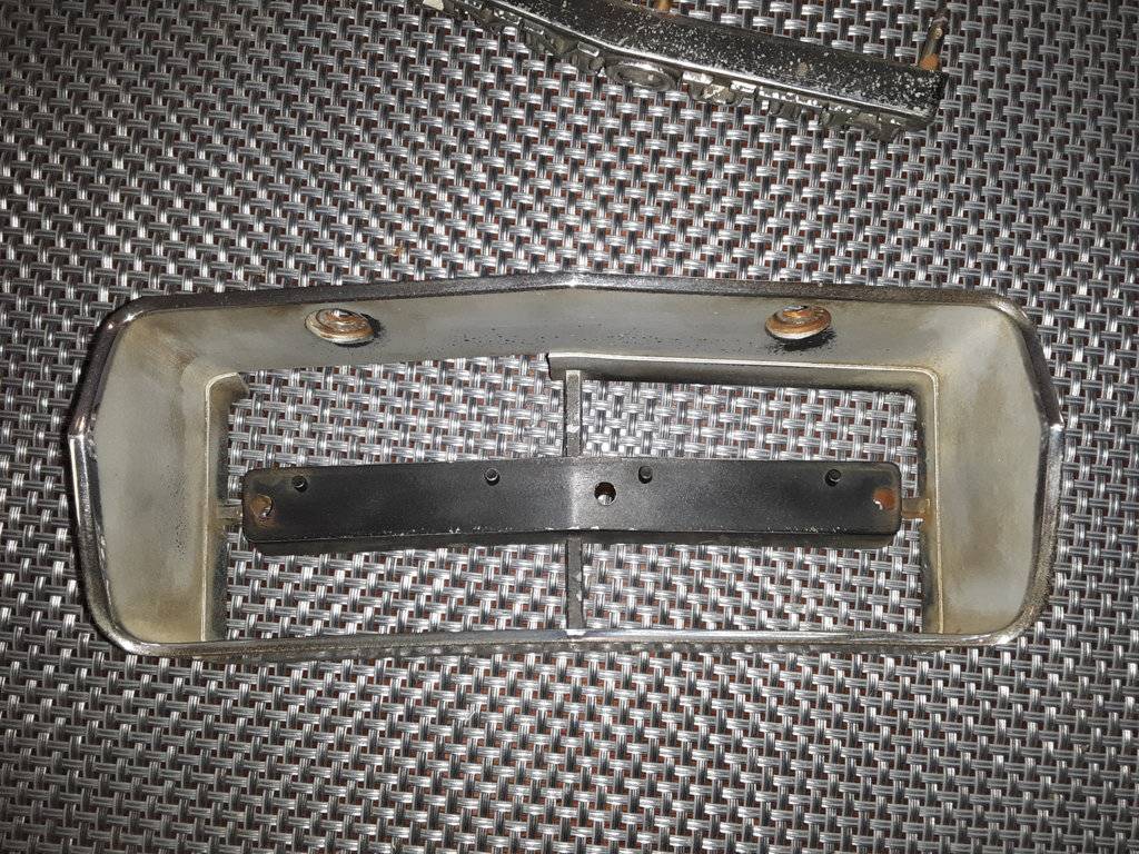

Speed nuts for Plymouth Emblem

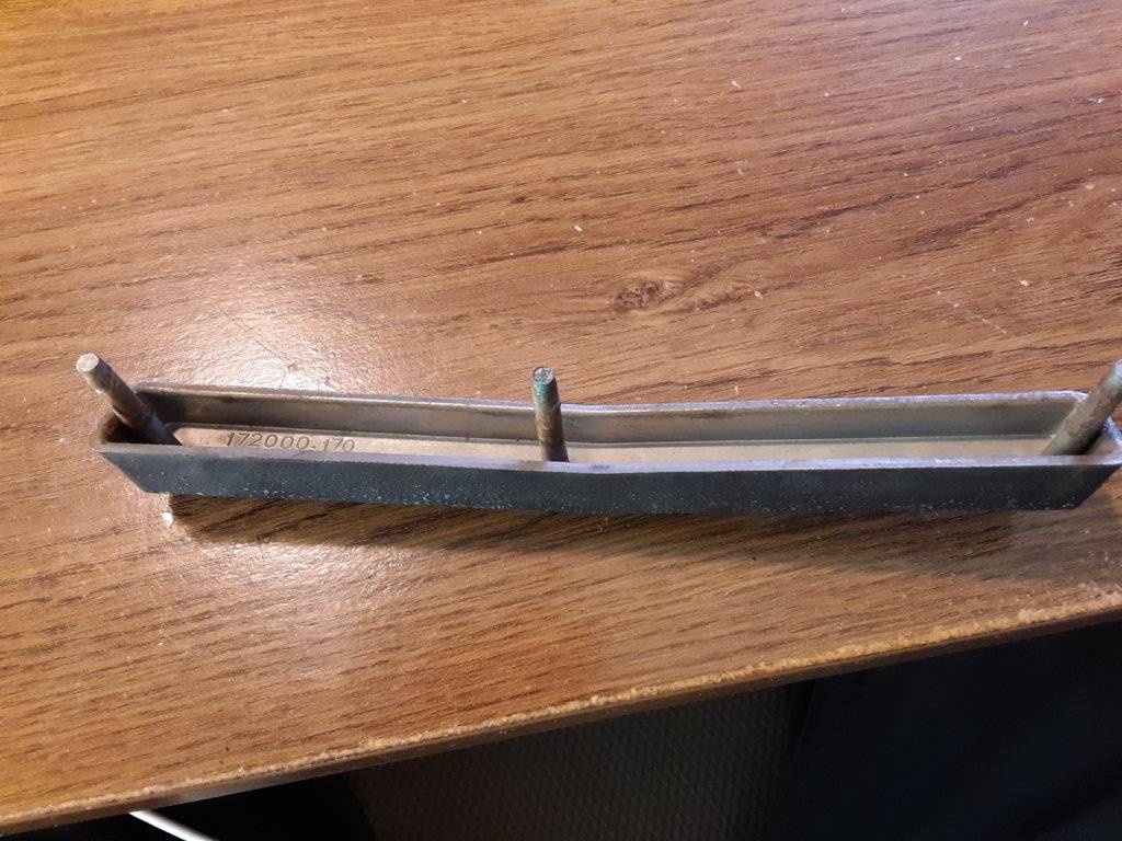

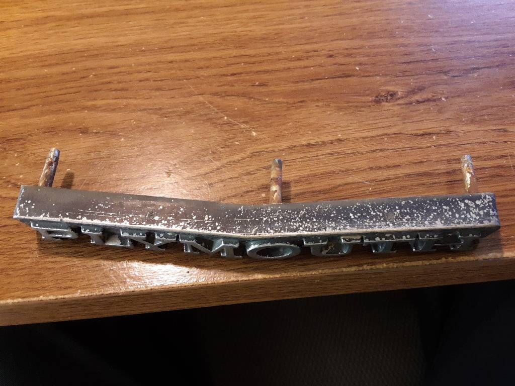

Plymouth Emblem

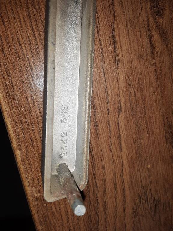

Rear View. P# left side
P# right side
Dirty
Plymouth Emblem
P# right side

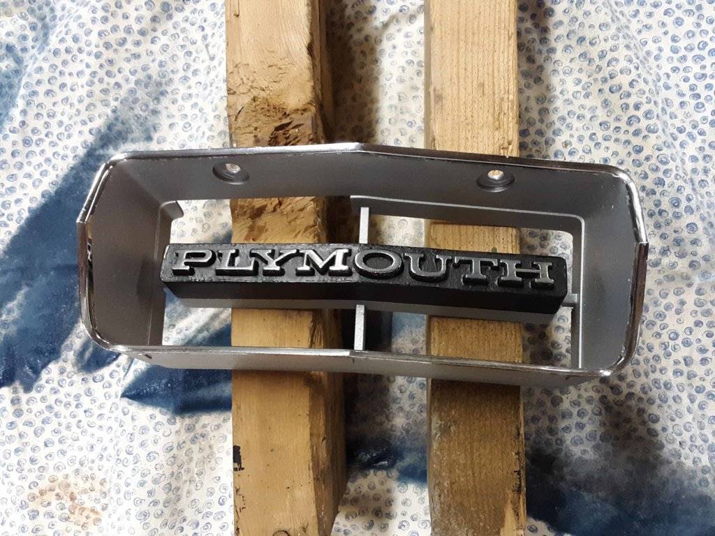

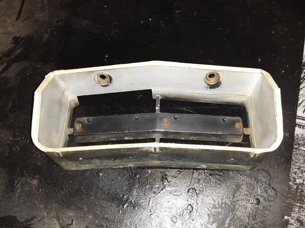

Center Emblem (continued)

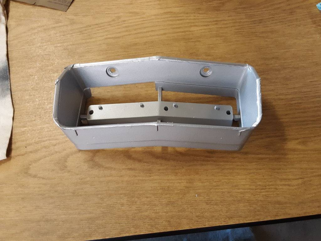

Plastic Bracket after scrub with Dawn and 0000 steel wool. Good paint prep.
Tape chrome finish at front edge
Argent Silver paint for bracket
Paint in progress
Painted rear side, 3 coats, Argent Silver. Paint began to run when I tried to paint all 4 sides in same coat.
Painted front side, doing 2 sides at a time. Did opposite sides, rather than all 4 sides in every coat. I did 6 coats total on front side with Argent Silver paint. No runs on the front side.

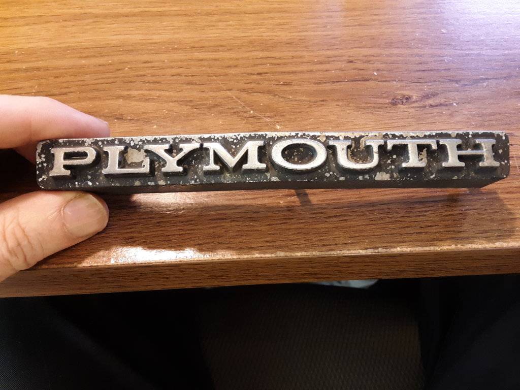

Plymouth Emblem: Smaller brush to detail around letters. Larger brush for flat sides. Flat Black oil-based paint
Plymouth Emblem, installed on bracket
Bracket P#
Clips after wire wheel clean and black paint. Install at top of rectangular opening on chrome bumper
Plymouth Emblem & Bracket, installed

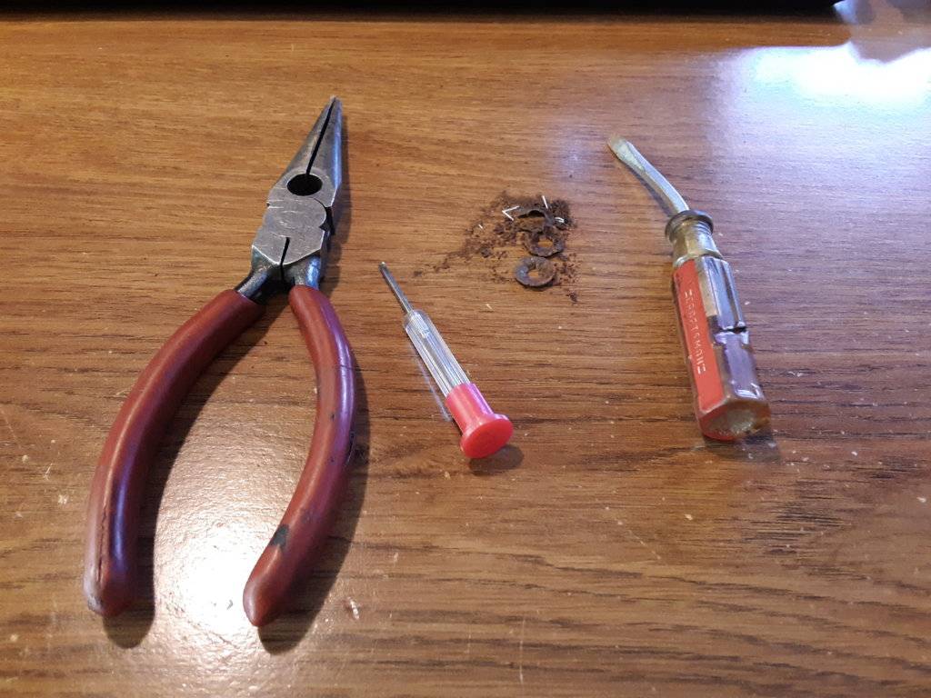

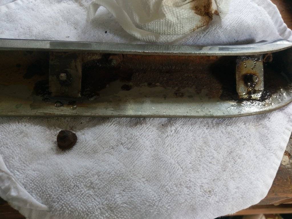

Also having issue with bolts holding chrone bumperette under front bumper. Heads snapped on all nuts. Looks like they are held in with a square shoulder similar to carriage bolt. Should these just knock through? I have tried hitting with mallet but no movement. Wonder if screwed in?
very informative, I am just at the same stage
Also having issue with bolts holding chrone bumperette under front bumper. Heads snapped on all nuts. Looks like they are held in with a square shoulder similar to carriage bolt. Should these just knock through? I have tried hitting with mallet but no movement. Wonder if screwed in?View attachment 279423View attachment 279424
My front bumper does not have bumperettes. Would think carriage bolt would come loose with mallet. Any way to turn it and see if it's a stud? Or get your finger behind it to identify by feel? Best of luck! @IMFURYS Dan, didn't you tell me something about bumperettes on your 1972 Fury? Maybe you can answer @bollotti.
