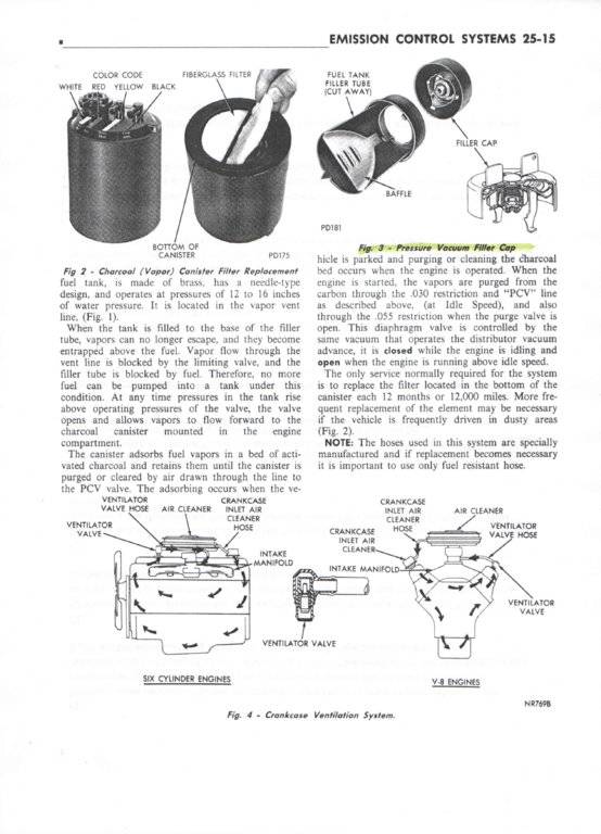

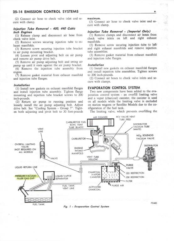

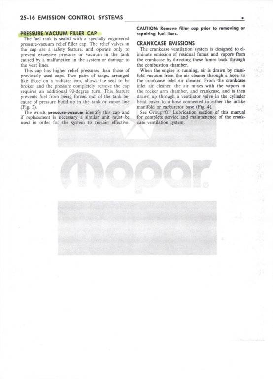

I agree with all suggestions that you may have a clogged vent hose system that is creating vacuum as fuel leaves the tank and air is not let in to fill the vacated space inside the tank.
Unless you have a station wagon, you don't have the limiting valve mentioned in the evap emissions section below.
The wrong gas cap may be part of the problem as well, since the cap is supposed to relieve excess vacuum, see 1972 factory shop manual, 25-16 below

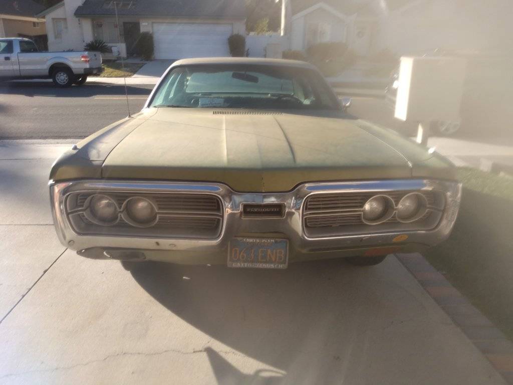

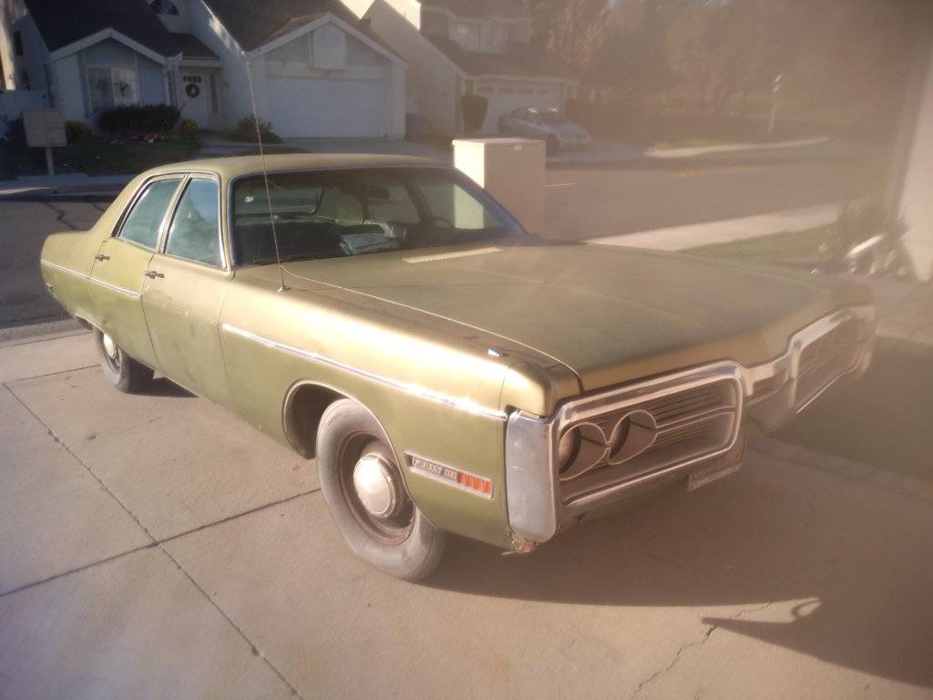

Thanks man .. ok here it is: we call it the green monster (during the holidays its the GrinchMobile)... I really thought the front was kinda ugly/weird but it has grown on me... I tried to get a shot of both my Mopars. The Fury is a bit banged up on the right side. The left is ok..zero rust anywhere..
Like the green monster.
72 Fury grill is a personal favorite. Love the grill inserts and loop bumper.

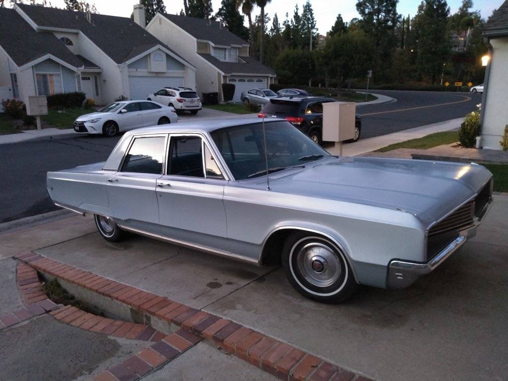

I love the color on your Newport! Is it the original Sky Blue Irid? Not against the Fury, Fusies are always nice in my mind.
Actually it's a cheap Maaco 399 paint job... I was under pressure to pick a color and I didn't know to check the tag so I looked at samples and eyeballed one... Sky Blue sounds familiar... but now I think the original color was a Teal... I'll have to look up my tag soon and see... The car has sat in the sun for about 4 years since paint and the cheap job has turned kind of a flat hue...but I like it so it worked out... Someday I would like to go back to original...
Looked at the fender tag on the Newport today... DD1 - online it says Sky Blue. On the fender tag decoder it says Monotone Light Blue Metallic.. Pretty sure I told the painter that but when I compare door jams it seems like the original color had more of a teale tint...
