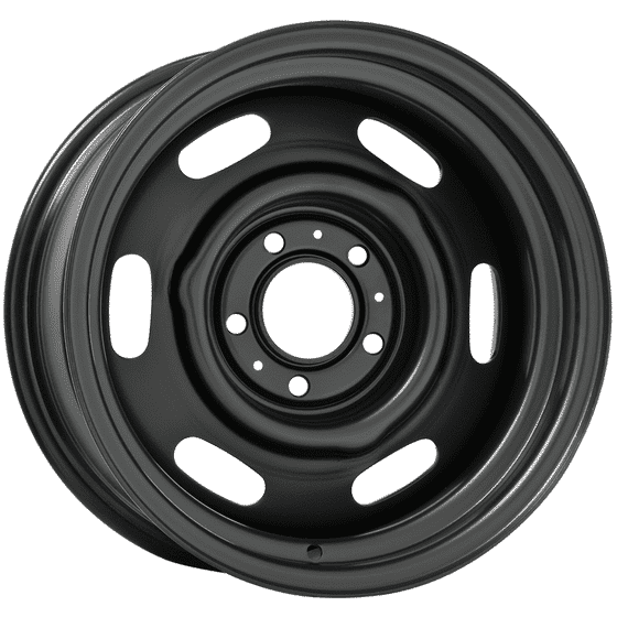

    I put the stock road wheels on my 72 fury 3 and just put 255/70/15's on the back last weekend it was hard to put them on. The clearance between the inner quarter and drum would not let me put the tire "up" in there so I had to put air in the shocks and raise the car way up and set the bottom in first. That allowed me to put the wheel on. I hope I don't ever have to change it on the side of the road. But once on there is plenty of clearance and looks great. I have 235/70/15's on the front.
