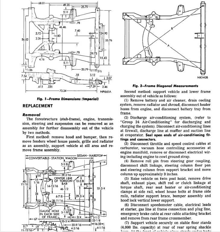

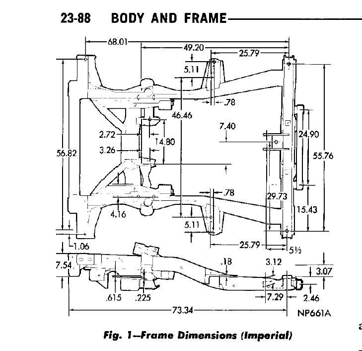

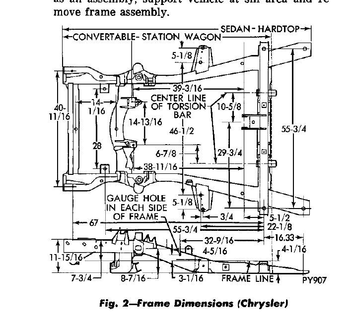

I don't have a FSM newer than 1970 for Chrysler/Imperial so I looked in my '70 FSM and in the body/frame section, there are dimensions for the stub frame. Since every FSM I've seen has these dimensions, it seems to me that the 72/73 will have the same.
A quick look and I see it's an inch longer between a couple major mounting holes, but look it over yourself. Here's a screen shot from my '70 FSM
(BTW, it's a stub frame and not a K-frame when referring to C-bodies)
