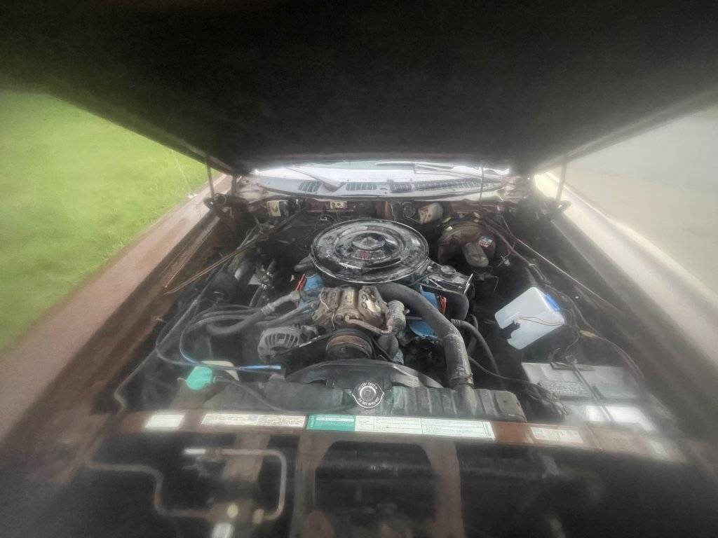

So I have been daily driving the car for about a week and a half, working on it slowly but ironing out major flaws.
The previous owner said this car was his baby, but some egregious concerns included the Kickdown spring missing, the jank-*** stereo system that was hacked into the car, the wiper switch wires being live and exposed under the dash, and the A/C compressor having a spot where it locks up.
I am currently working on getting the 360 in top shape. I drove it back from the seller’s house and it made the trip, but was not happy.
The first thing I did was install the missing Kickdown spring and the car would drive less like a dog.
Next, the idle speed was improperly set, so running the engine hot with the high beams on in neutral revealed 600rpms, raising it to 750 rpms made a huge difference in smoothness.
My latest task is a tune-up. I replaced the original PCV valve, cleaned and reoiled the breather, installed NOS Champion N13Y spark plugs and new Mopar Performance wires. I’m waiting for the NOS tan cap and rotor to come in. Misfires are all but gone!
