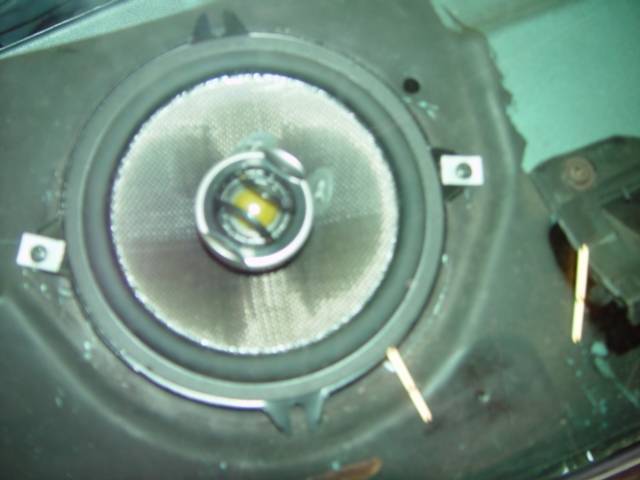

A few weeks ago had the car stereo installed, everything works really good, I can listen the car stereo up to 4 hours before the battery starts dying, the unique problem is that I made a mistake while buying the front speakers and now I can't install the dash top metal (the speaker tweeter is too tall) so I need to have those speakers replaced. Any idea which speakers can be used?
hey boss -
i doubt you can remove that tweeter dome you will probably have to change speakers. you can get a set that is single coil midrange and separate tweeter with a crossover box or something.

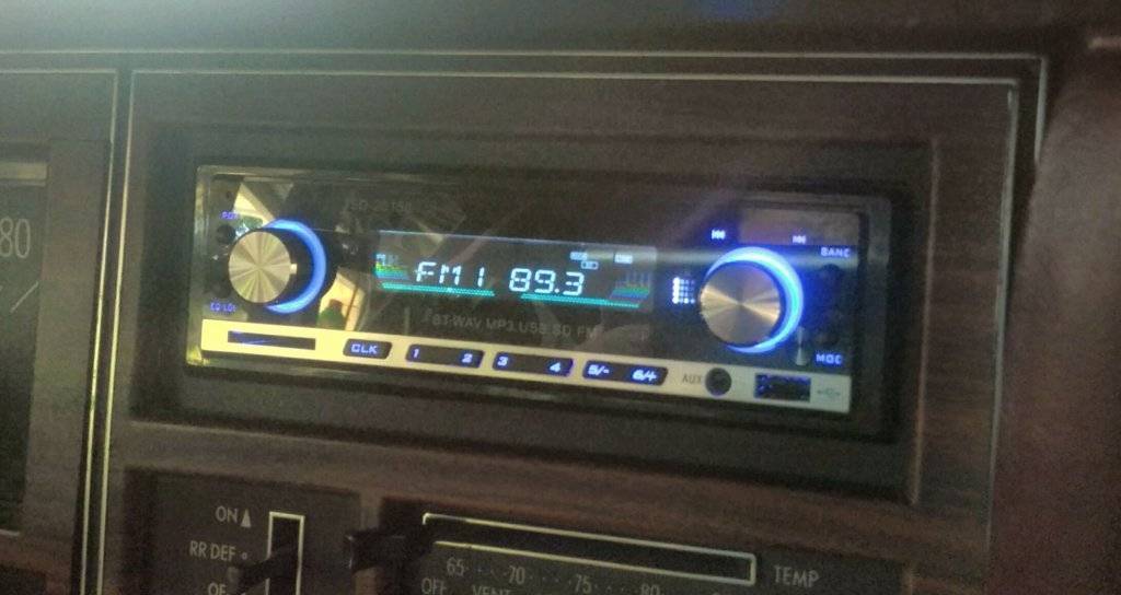

We temporarily hijack this thread with a personal note to Bob:
After three OEM radios crapped the bed, I was forced into it. :BangHead:
( FWIW, FM only, one color {blue}, 26 bucks {AMAZON} . :p )
nice my man! you even have a USB charger you just stepped that car into the 21st century!
No, my friend. This was not a step foward into the 21st century but a giant leap backwards in the preservation or originality. It was forced upon me and I relented in disgust. I had to take a shower to wash off the shame. It looks like ****...
