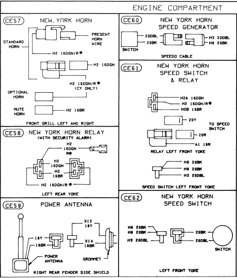

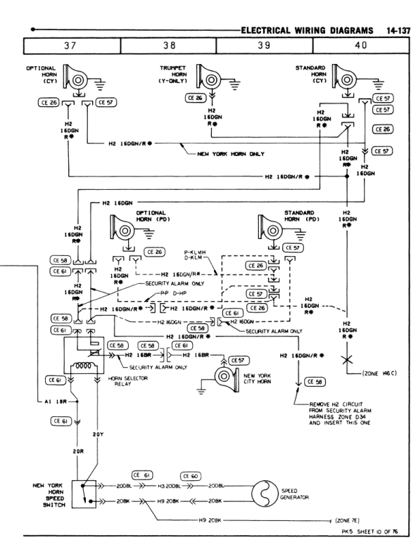

Looked into it and the only mention of it is actually in the wiring diagram. Might not be of much help to OP because if I'm reading this right, the relay on the relay bank should be the same and the difference is actually in the engine bay.

View attachment 571279View attachment 571280
There it is! Thank you very much. That's alot of horn options. The speed switch has me even more intrigued. I really want to know what it sounds like!

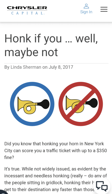

This is all I "turned up" with a quick google search, how the times have changed.
Honk if you … well, maybe not - Chrysler Capital
