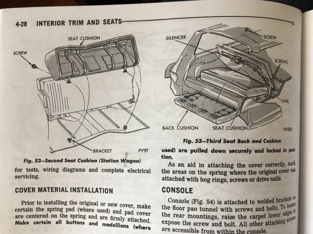

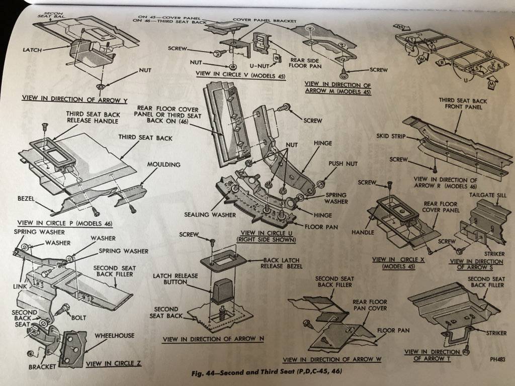

Ok dumb question how do I get the rear seat out to check the bottom? I tried pulling up on it but something seems to be holding it in place.
The bottom edge needs to be pushed rearward first to clear the hook latches at the front. Push in on one side at a time about an inch or so, then lift. Repeat on the other side.
IF it's like the sedans, and does not bolt in, then a combination of pushing down and back, then up might do the trick. It'll have to move back about 2" to clear the catch on the floorpan. One kind of each outer seating position. Some seem to be easier than others.
This is out of the 1969 manual.

Wow guys thanks for the diagrams. Good new is the door latch was just frozen and is working now. Also temporary patched my fuel tank as it leaks if its more then half full. Now to find a tank rebuilder as I haven't found a replacement tank for a 76 wagon.

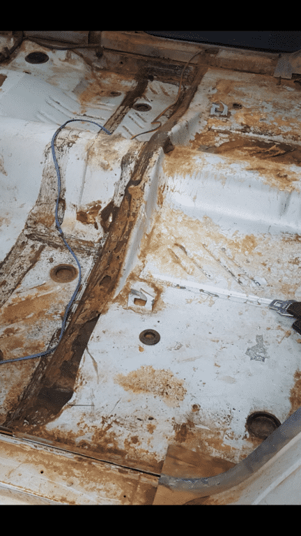

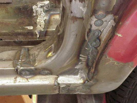

Dog legs, rear door bottoms, spare tire well is where ours rotted
Not sure what the dog legs are but door bottoms have signs of rust starting. There spare tire area on ether side have been poorly patched along with rear compartment.
Just what I thought.
Also it looks like my dog legs are good right now. With 1 exception, all the rusted out areas are flat.

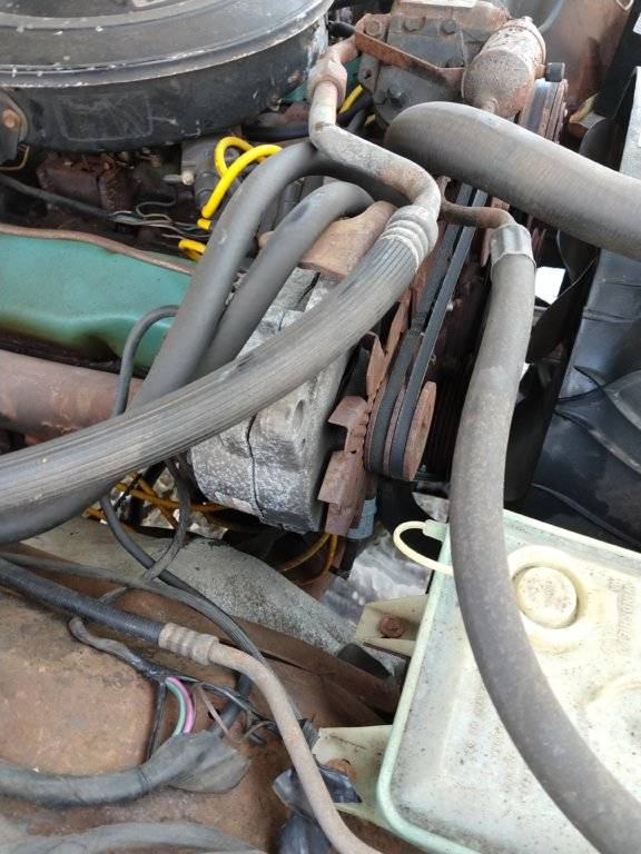

On another note, I lifted up the rear and with the car in neutral both wheels spin the same direction. Guess the means it has a Sure-Grip. Did not find a ratio tag anywhere. Then started going over why my gas gauge doesn't work. I'm getting an ohm reading of 42 which should be half a tank. Unless the problem is related to my amp gauge not working either.
