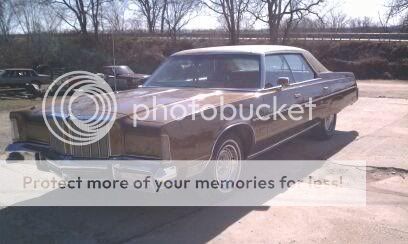

1978 New Yorker, thoughts?
Finally have an update...
Replaced the Lean Burn System

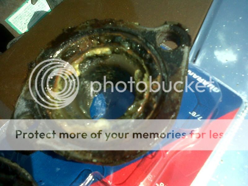

Replaced fuel tank and grommet (fuel tank was full of crap)
Cleaned all mice nests out of heater vents
Fixed wipers
Changed Tires (dry rotted like crazy!)
And as of yesterday, waxed it and cleaned interior
Mostly stock. Changed valve cover gaskets, and might change the carb. It doesn't have the "pep" that a 440 should have in my opinion.
Other than that though, I want to leave everything as original as possible.

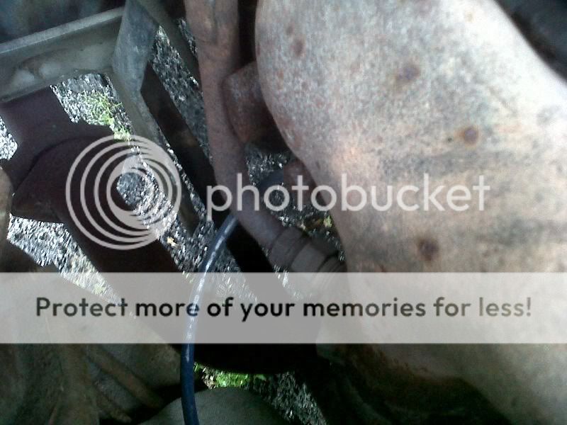

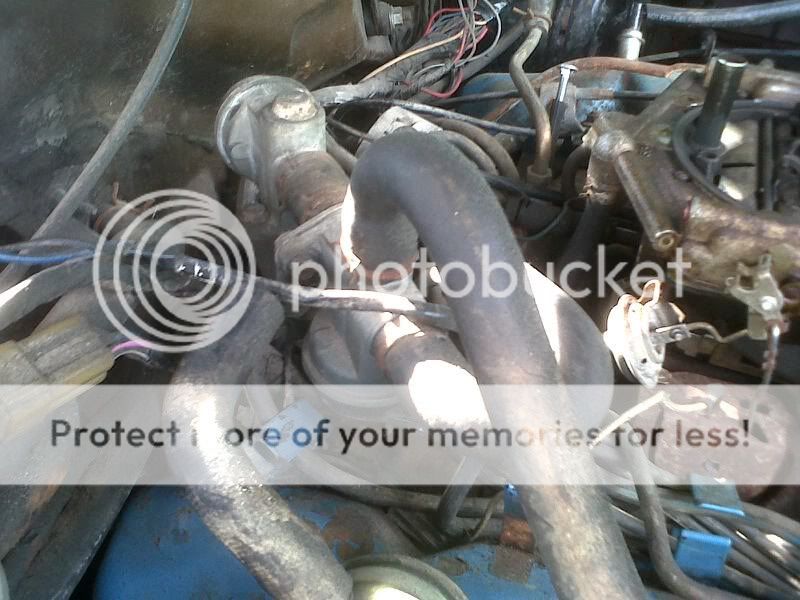

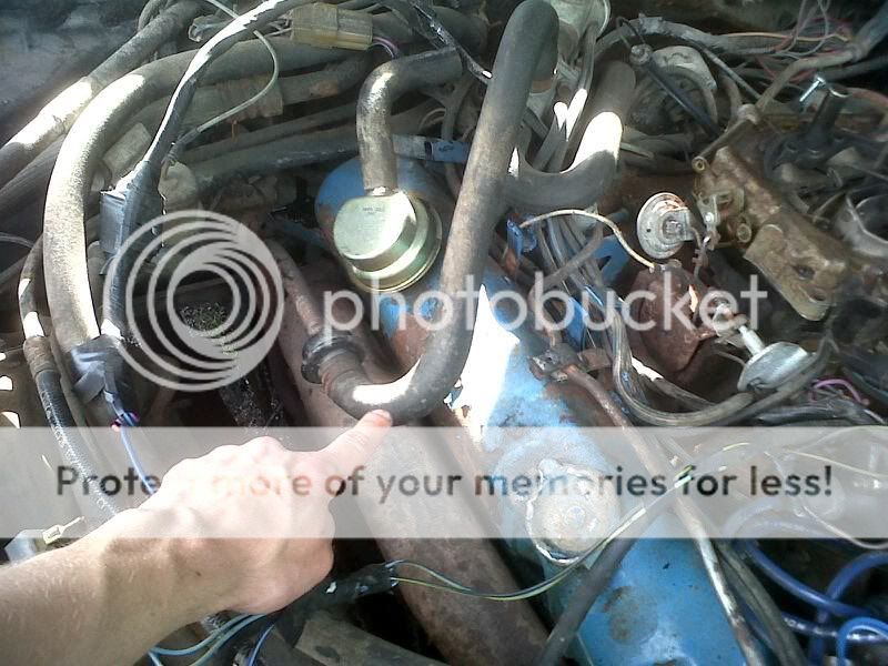

Do you have a 1/2" exhaust tube mounted to the rear of the right side exhaust manifold attached with one bolt to the manifold that runs up over the rear of the intake, goes to a check valve and then attaches to the bottom of the air cleaner?

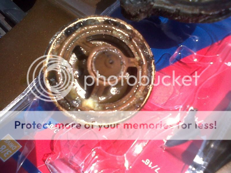

And finally, it was about 80 degrees here today, and I noticed at the stop light the car was running a little warmer than normal. Coolant is full, so I was going to swap out the thermostat just to be safe...I am going to order a 160 degree, but I have searched and really can't find a good answer... What is the difference between OE Temperature, and Alternate Temperature? And what do I want for a stock 440?

Finally got it done yesterday. I think it's more than time for a coolant flush also... That's definitely next on the list! I got the 180.
And by the way, I did not want to remove the compressor in the parking lot and found out how hard it is to get to the 2nd bolt in the thermo housing under the compressor. Is a swivel socket about the only way to get there?? Even a 1/4" drive U-joint was still too tall for that area. I ended up going to Autozone and getting a stubby wrench and skinning some knuckles, but got it!
...found out how hard it is to get to the 2nd bolt in the thermo housing under the compressor

78 NYB, is this the exhaust tube you wanted to see? I had to change master cylinder after I shoved my brakes to the floor and almost rear ended a guy, so I figured I'd snap a few pics...
