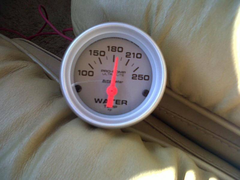

I was still having overheating problems. Even with no thermostat my heat gauge still read that it was getting warm. After many, many radiator drains, parts changes, and lots of frustration, I could only assume that the next step was digging into the heater core, or checking intake and head gaskets. But, before actually getting down to intake and head gaskets, I figured I should probably double check and make sure that my heat gauge in the cluster itself was true. I bought an infrared temp gun to check hoses... top read 210, bottom 150, but I didn't trust the gun.
So I went and ordered a new sending unit and Auto Meter (part # 4337) gauge with the 1/8 NPT that is required for the sending unit.
And Voila...it's magic. This was the reading after I pulled back into my house after driving in stop and go traffic, and up and down hills. Probably about 90 degrees F ambient here. I put in a 180 thermostat, and even after putting a load on the engine (35 MPH up hill, and climbing) it never got over 190!
So, I guess I can officially say that my heat gauge went bad in the cluster.
