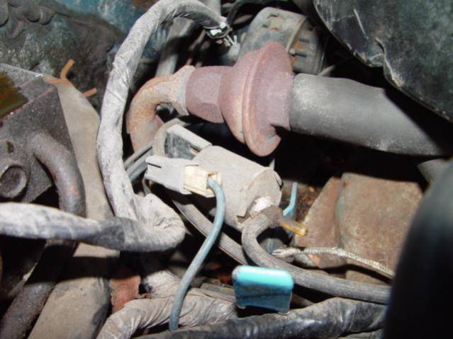

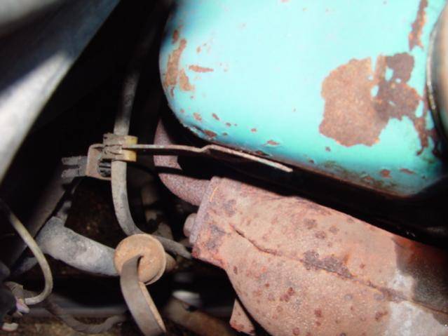

Yes, same principle but different manifold and tube location at the exhaust manifold. Mine use to come out of the very rear of the exhaust manifold near the firewall, Presently, all of the emission stuff is gone or no longer functional on my NY'er.
I couldn't attach the picture of the tube on my NY'er on the last post.

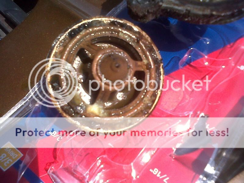

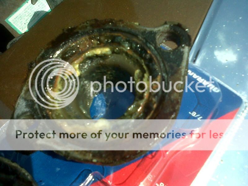

Finally got it done yesterday. I think it's more than time for a coolant flush also... That's definitely next on the list! I got the 180.
And by the way, I did not want to remove the compressor in the parking lot and found out how hard it is to get to the 2nd bolt in the thermo housing under the compressor. Is a swivel socket about the only way to get there?? Even a 1/4" drive U-joint was still too tall for that area. I ended up going to Autozone and getting a stubby wrench and skinning some knuckles, but got it!

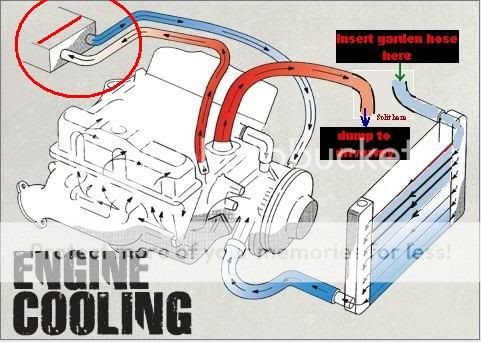

You're really going to have to go Nuclear on a super power flush on the whole system.
Chemicals, chemicals, and more chemicals.
Do several flushes with one of them being Tide laundry detergent powder.
I can't see the thermostat or housing too clearly, but it looks like something might be causing that colagulation other then maybe sitting a long time. I don't think anyone asked what color is your engine oil? If it's black you are good to go. If it's gray or a milky color you may have a bigger problem.
Thanks for the tips guys, and NYB, I actually just ran outside to check oil, we are good to go. It's not black as it's not that old yet, but it's certainly not milky or gray. Which is good.
It just occurred to me that a likely scenario for all that gunk is a previous owner used a ton of BarsLeak Radiator Sealer. Hmmm...
Do your several flushes withOUT a thermostat BTW.
Heater on MAX.
1st flush: Radiator flush from one of the chain stores.
2nd flush: Tide
3rd flush: Cascade dishwasher liquid (YES you read that correctly)
Last flush: stick the garden hose in there and walk away for 1/2 an hour.
My environmentally unacceptable way
but there are no pets running loose so I don't care:
Plus it cleans my concrete driveway.
