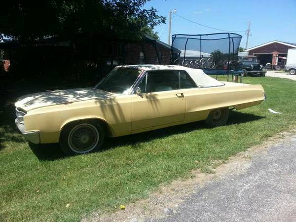

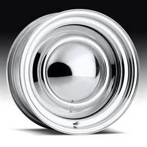

I like the look of wide tires on a big car. I had staggered widths on my last car (wide in the back, thinner on the front) but that doesn't allow you to rotate the tires. So… I want to put matching wheels and tires on all four corners. I am wanting to do these 15”x 8” 4.25" backspace Cragar Smoothies with 255/60/15 Cooper Cobra tires. The tire diameter matches the factory 27” diameter almost perfect. My question is has anyone seen 255/60/15 tires on the front of a C Body?
