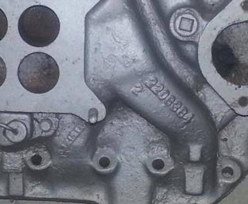

I would assume that it has the small bolt pattern mounting flange, like for a carter WCFB. If that is the case, You'll either use the WCFB or early AFB, or use an adapter to use a later model carb, which may limit your air cleaner options, due to height.

You need to look up the manifold casting number and find out what year 318 poly the manifold is for and then use the carb book to spec the appropriate carb. Many 318 Poly engines used the Carter WCFB rated at 520 CFM. This is a square bore unit.

Casting number is 2206384. I believe it's an AFB carburetor. Today that's the Edelbrock 1405 (manual choke) or 1406 (electric choke), right?
No, today's carters will not bolt to that flange. I know that is WCFB flange and I think that the real early afb's used that small pattern. Read my first post.

Not to my knowledge, unless you use an adapter. What is wrong with a rebuilt carb?

Go with a 1406 with the electric choke. It should bolt right on to the square bore manifold.

The AFB that came OEM on my '67 Newport 383 was the small pattern with the smaller air cleaner base plate hole. Is that different than the WCFB (Will Carter Four Barrel) pattern? I would have suspected they'd be the same bolt pattern.
CBODY67
Different bolt pattern. Sometime in the late fifties or very early sixties it changed. I remember the AFB on my 58' 392 was smaller.
