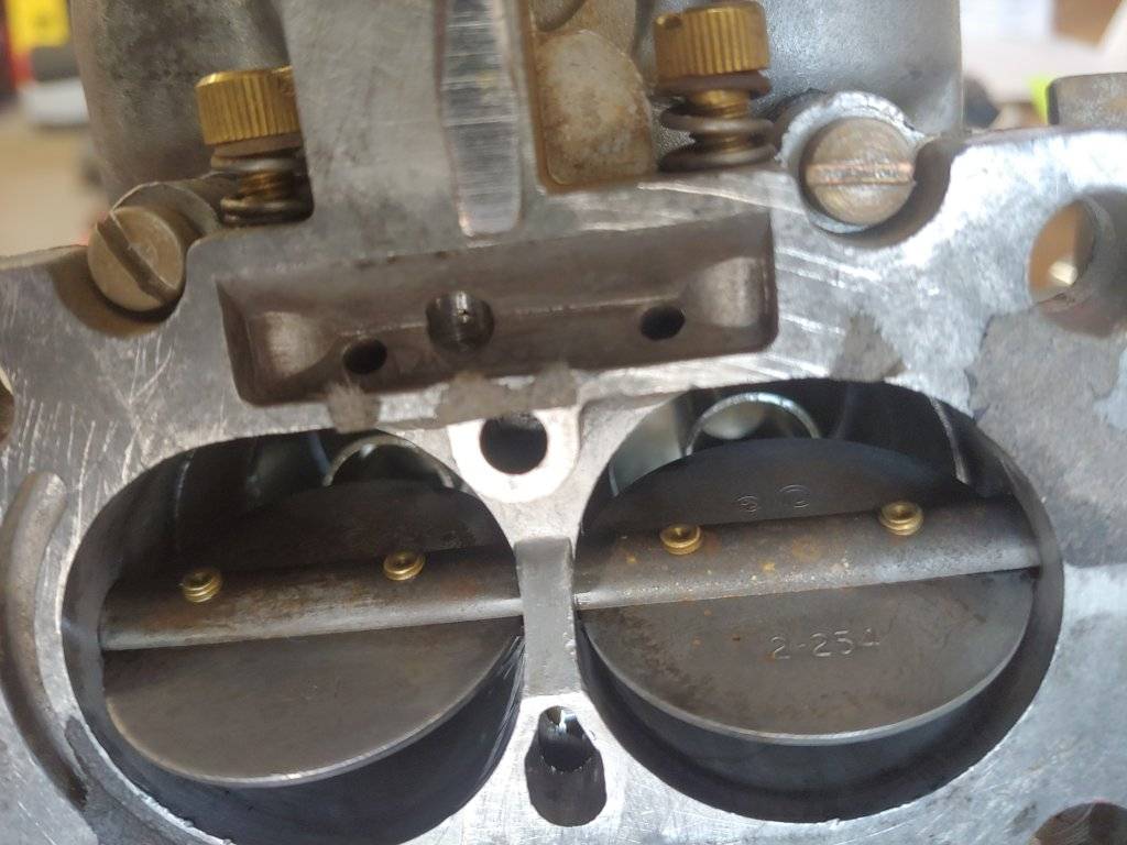

its a factory BBD but has a port on it I haven't seen anywhere online, there was a tube fitting from the drivers exhaust manifold that went into a port on the baseplate of the carb right underneath the fuel bowl.
that port fed a chamber that is sealed off and only has 2 much smaller ports that go directly into the Venturi and underneath the butterfly's.

That shows where the exhaust tube went in, the chamber and the two journals that went to the venturi below the butterflies.
The gasket blocks that chamber off from anything else it is its own specific circuit

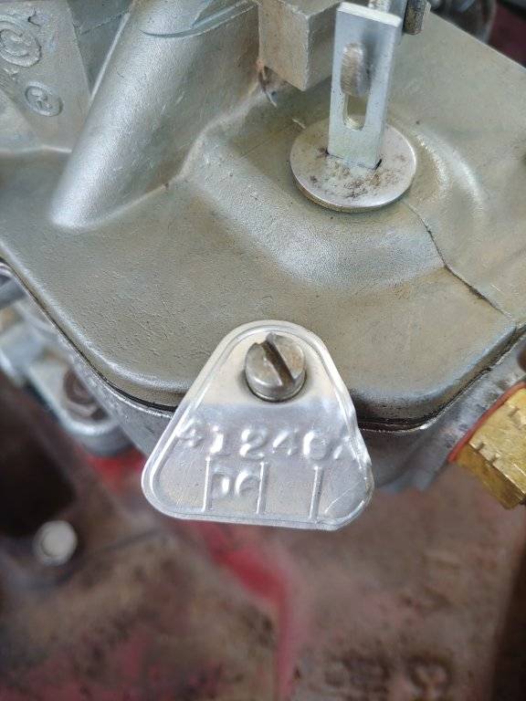

What is the carb tag number? What I'm seeing does not match what's in the '65 or '66 Polara servcie manual (Chry FSM).
4124S is the correct carb for your application, but that carb was used on 318 engines until '73, I suspect that this carb has the additional port for emission controls on the later engines. There were no EGR valves or other elaborate emission controls on a Canadian built Poly engines. Photo of the 4124S available at 4124S Carburetor Info Page. A photo of the lead coming off the manifold would be helpful. Suspect it is a "service" modification. The port in question was not likely used on your '67 Poly, plug it off. If this is a later carb, it might be jetted too lean for the '67 poly. Carb idle settings are the two slotted screws on the the throttle plate. Set these to 2.5 turns out from a locked position and it should idle, you can do fine adjustments from there.

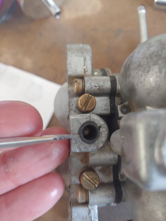

Thanks for the pictures! Just wanted to make sure you had a Carter BBD 2bbl. On other carbs, that center port (which is plugged) is where the pcv port is, but on the BBD, it's on the back side and angled instead. So that mystery (to me) has been solved.
The pcv system should be hooked to a larger-diameter manifold vac port, as the orifice in the pcv valve is spring-modulated, so its not like a pure vacuum leak.

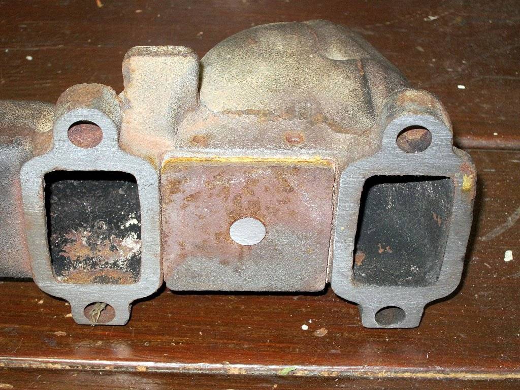

when I got the car off my grandpas farm it has a stainless tube that went from that port to a port on the drivers side exhaust manifold, but the tube had broken off just over the drivers valve cover and was completely plugged at the manifold but the tube was clear so it was sucking air in to the carb. it was wrapped in heat wrap so I was assuming it was channeling exhaust into the carb.

In the middle-'60s time frame, some GM cars had a tube coming out of the rh exhaust manifold, BUT it was a tube which sent through the manifold, to bring heated air into the automatic choke mechanism (pulled through the tube by a vac bleed which pulled additional heat through the pipe, to the choke thermostat, and then into the venturi area). That might have been what was trying to be done, but in the wrong way.

As CBODY67 mentioned that tube was for hot air. Ford. back then, used to move hot air from the exhaust to operate their chokes. The picture shows the back of an FE exhaust manifold where you can see the two outlets Ford used along with the chamber.
