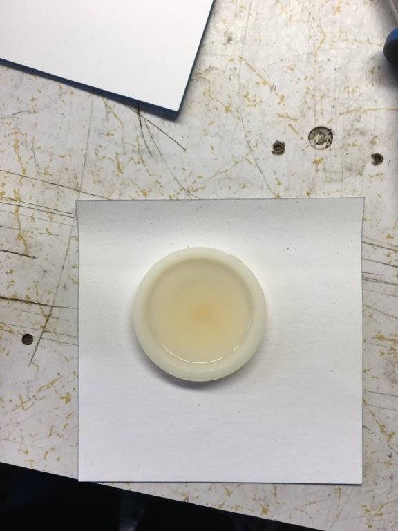

Out of curiosity... has anyone come up with a process to clean these bottles and restore the plastic to something closer to the original? I used orange hand cleaner with lanolin on mine seemed to help but....

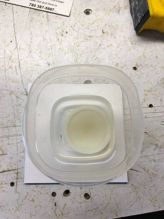

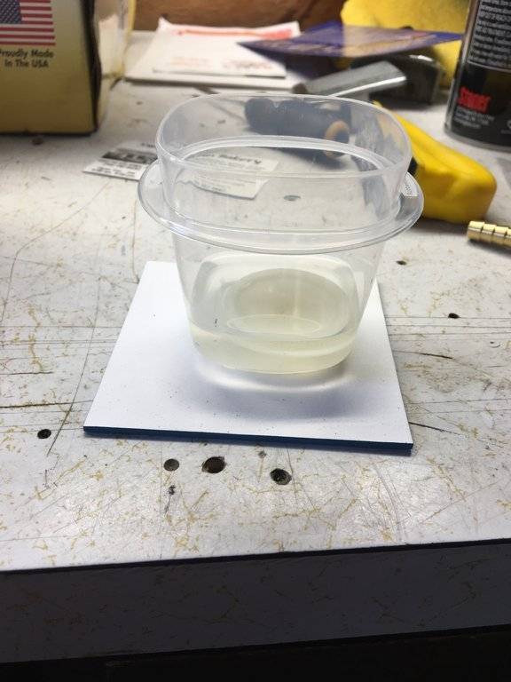

Use javex bleach. Just let it soak in the bleach for a few days and it should clean it right up. I'm doing that on a Interior light lens from a parts car rite now. The lens was burnt dark brown from the heat of the bulb and looked terrible and very much unusable but I soaked it in bleach for 48 hours now and it looks great with no damage to the lens , it didn't make it brittle and it's much thinner plastic than a washer bottle. I'm going to soak it for a few more hours to see how white i can get it.
