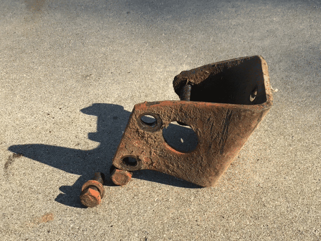

Be aware that the '66 block has different mount on driver's side. It will not have the mounting boss on it, and the '66 mount does not work in a '65.

Here is the mount bracket for left front of a 1965 Cbody
Yes, I understand that I'm looking at it as a core. My biggest concern was the mounting issue which has been answered. And if the heads were any different since mine are basically trashed.
This is good info, but if i were the OP I would check both blocks to confirm. Im almost certain that i have a '66 block with those bosses. Gonna have to look tho...
I thought they kept the bosses on later blocks and just didn't drill and tap them, due to not having to modify/replace the molds?
From what Uncle Tony said in one of his videos, where he detailed the particular-to-1965 lh frt mount, the new-for-1966 mount was phased-in during the first of the 1966 model run. Meaning that the boss was still there on those initial 1966 B/RB blocks, but not drilled. An interesting video on his YouTube channel. Another bit of Mopar information not generally known about.
