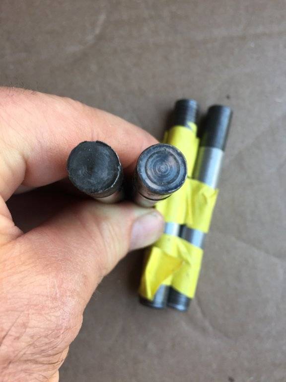

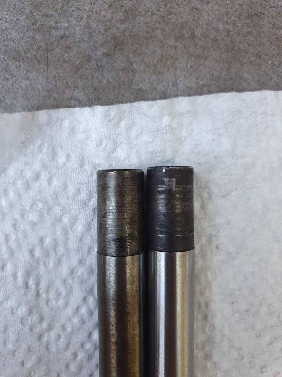

on the left is the old pusher, on the right is a new one, replaced with a new one, there is no sense.
but I noticed that the fuel pump, which I changed 3 months ago, does not even pump gasoline into manual. I took off gasoline, I try to pump it manually and I don’t feel that it is pumping something. I suspect that the pump turned out to be defective and did not last long.
