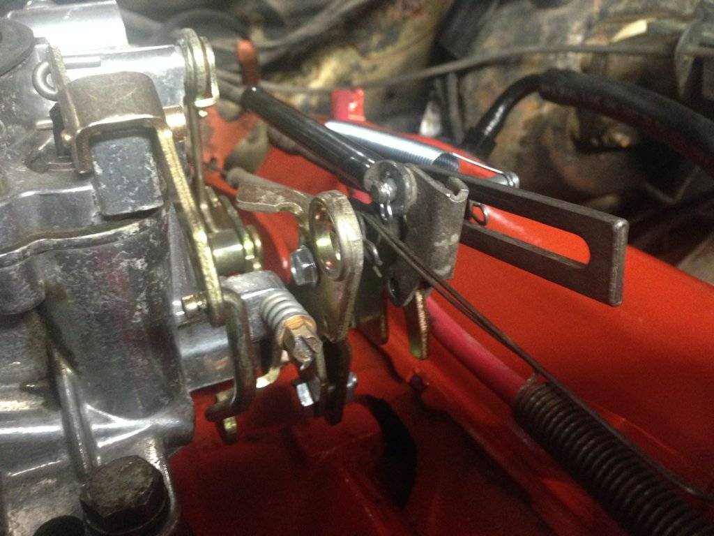

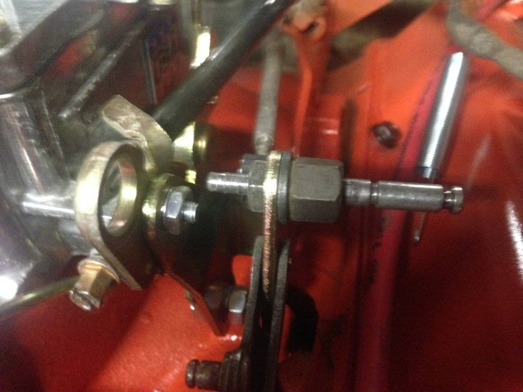

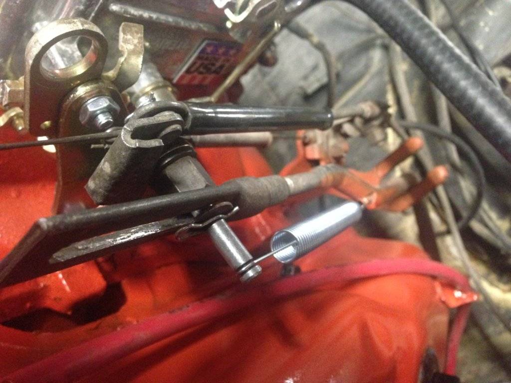

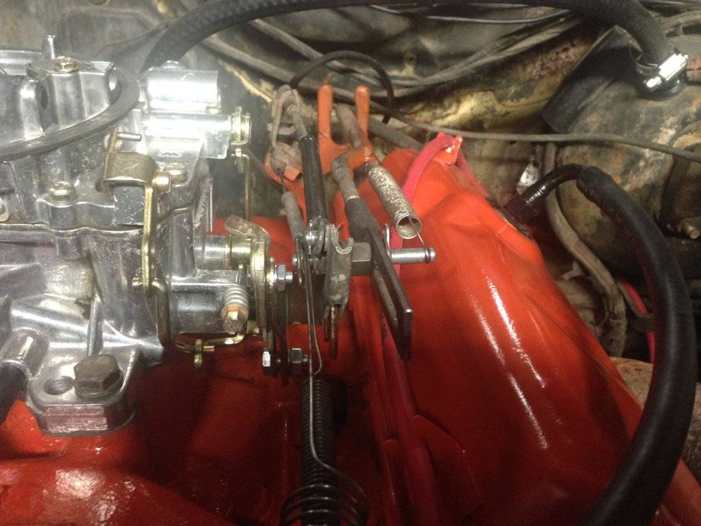

On my new yorker wagon, new performer, electric choke. It idled at 1200 when installed. I began fine tuning. Brought timing to 10 btdc , and got her down to 8-900. My idle stop screw is backed all the way out. There's a little click when I try to pull it back to the stop, drops probably 50-70 rpm, but still high. It seems to be running off the intermediate slots, as adjust screws are almost shut
What am I missing here? Don't think I have any vacuum leaks, manifold is original and booster holds vac, but looking at that is my next step

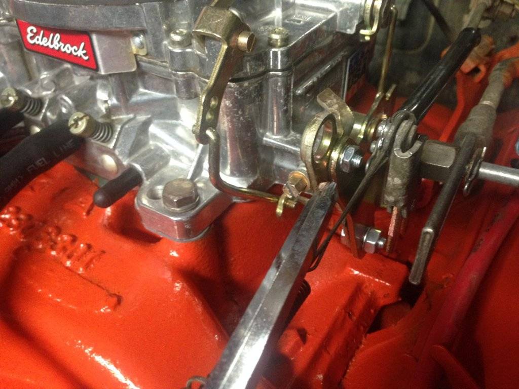

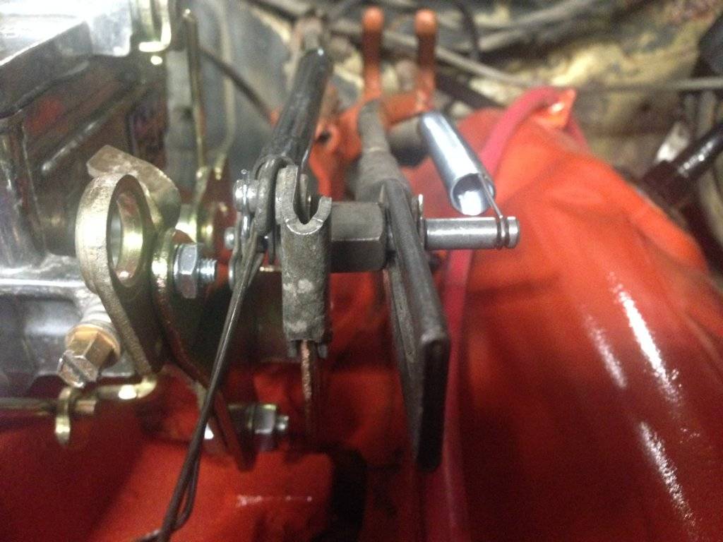

You need to get rid of the baling wire holding the throttle cable to the carb linkage. Edelbrock makes a stud adapter that is designed for Mopar applications. I suspect that you throttle cable may be binding with the current setup. Start there.

Yeah, it's temp:) I thought of that, but there is slack still in the cable,
Take the throttle cable off and see what it does. That and your cable for the transmission kickdown.

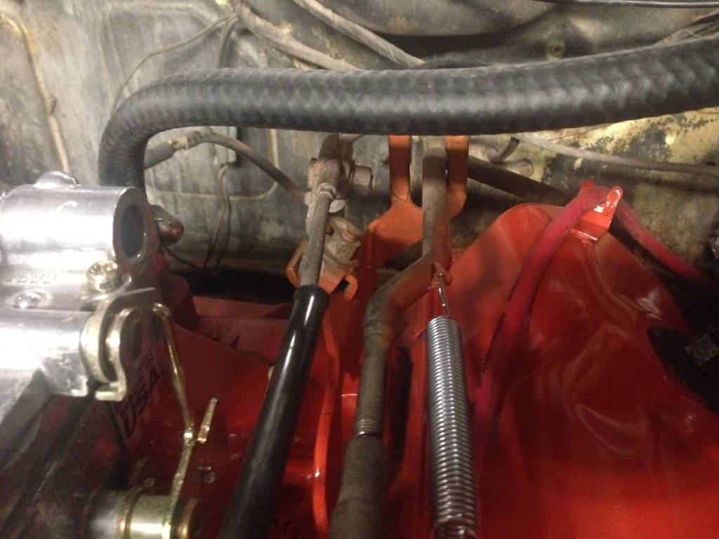

Looks like the problem is the lokar springs are interfereing with the fast idle. They are routed the way lokar wants them. I'm gonna see what i can do

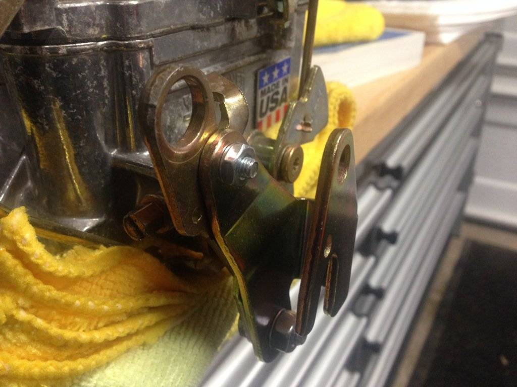

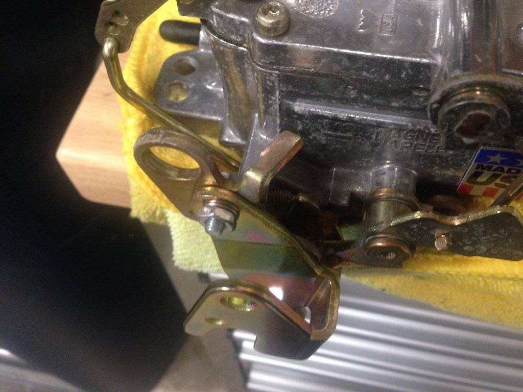

Buy the edelbrock Chrysler Throttle lever adaptor and install it , It works much better than tie wire.
I moved springs, now returns to full idle, got her to purr after 30+ years . Sometimes the simplest things cause a problem:)
