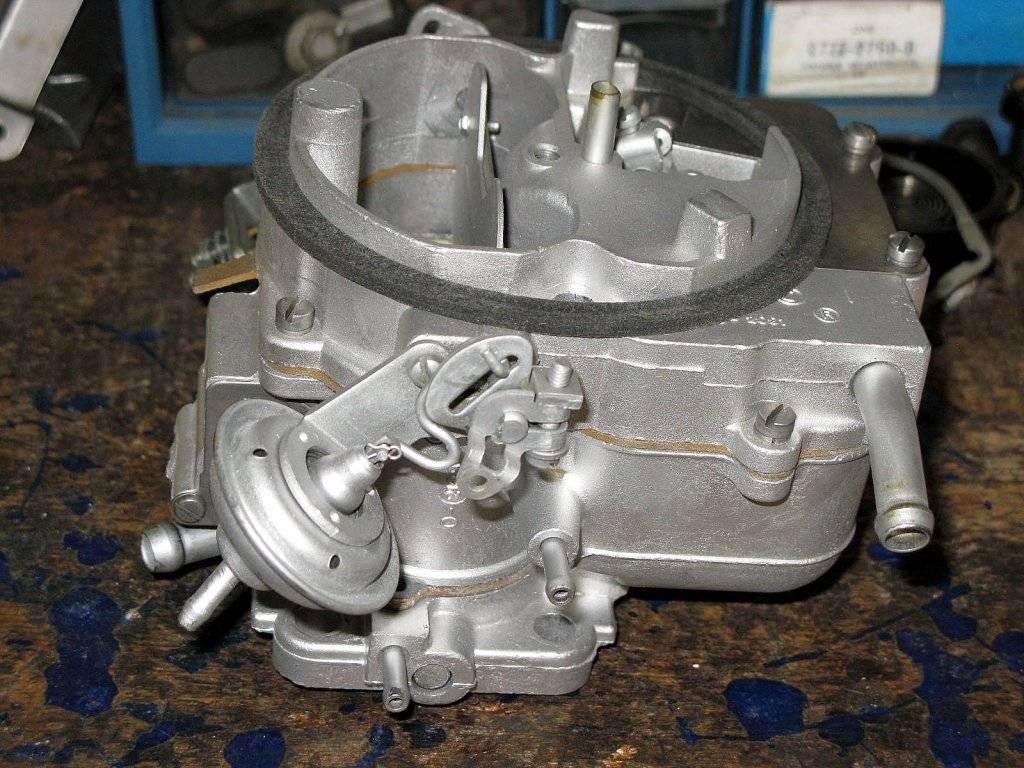

The Carter sure does look fine sitting on my counter but runs like crap.

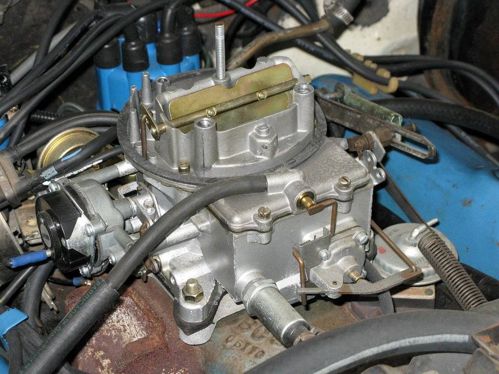

The Motorcraft 2150 looks fine besides working great. With the right amount of gas at start and the car starts in an instant. I love the way it does that.
Nice looking 2150. That sure is a trick linkage running the bowl vent valve!
What jetting/calibration changes were necessary? Which Ford application seems to work best?

The jetting was left at the standard jetting of #56. Sparks plugs look great. Timing I believe is at 10 degrees as I am a believer in adding more timing than specs short of spark knock.

The cheap copy carbs I've been getting from eBay and Amazon have been working fine. They aren't ready to go out of the box carbs, they are preassembled carb kits. They all have machining trash inside and the linkages have to be corrected as needed. But the machining and parts are ok, and they run good.
Ford 2100/2150-$70.
Little Carter BBD two barrel for small block-$70.
Edelbrock 600 four-barrel copy-$180.
