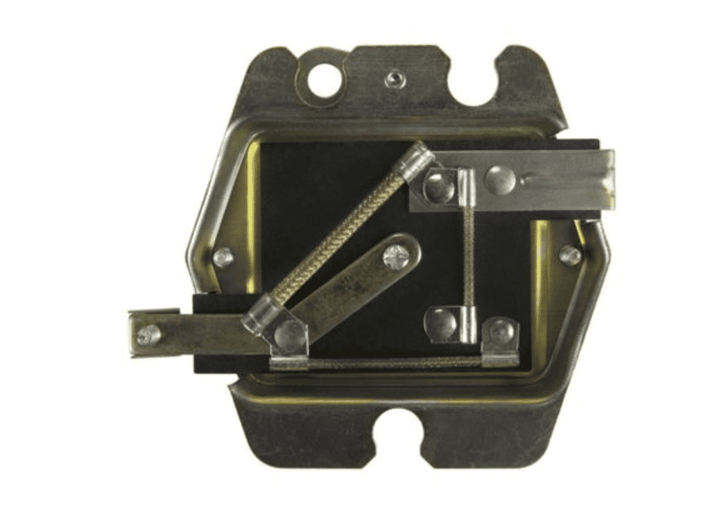

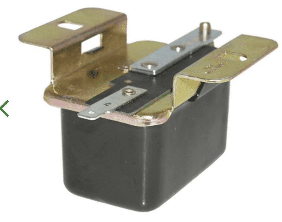

is there a voltage regulator that i could pick up? Would a local parts store have something like this?
found these two styles at local stores. Am I correct in assuming the first would be electronic and the second would be the older style?

Looks like from my research that the vr706 from duralast/Autozone would work for the voltage regulator. Seems like its a plug and play....unless someone has a better option.
