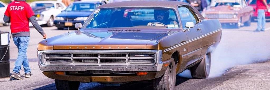

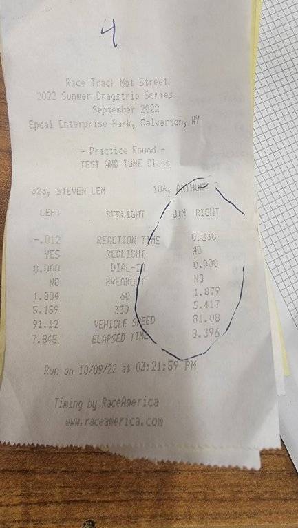

Figured id post an update. Got the motor swung in place in Sept of 21, Long Island Needs a Drag Strip & Pete Scalzo as well as many others were able to convince the town of Riverhead to allow us to run 1/8mile unprepped track for 8 weekends of 21 . I didn't have the time to get the bugs worked out before the last weekend of 21 but I was able to make a few trips in 22. Best pass of 8.39 at 81mph . I had some transmission issues I plan to work out through this winter. I'm confident I'll reach my goals of sub 13 sec if I can get the gremlins worked out. I did put a 9" rear and 4:10s in Feb of 22 it suits my needs pretty well I'll keep on tinkering until it's where I want It.
