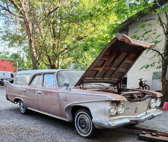

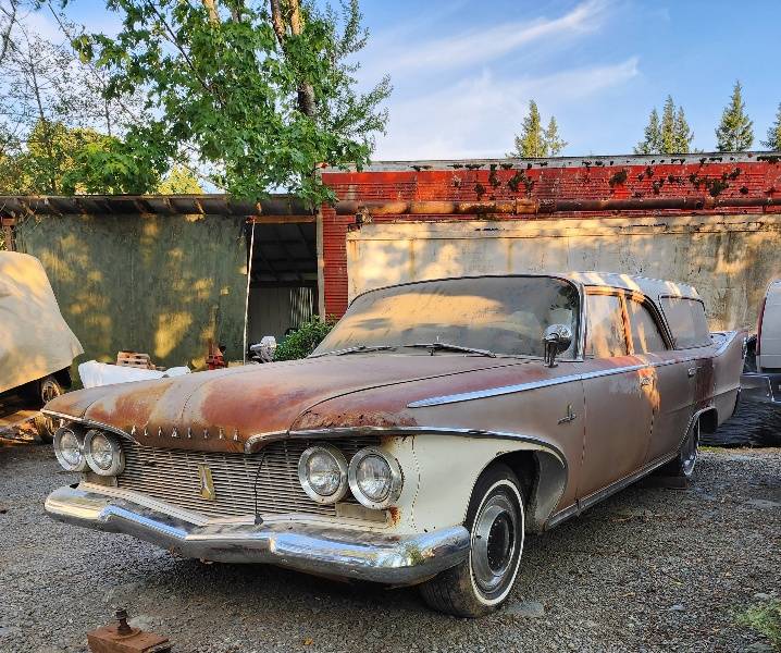

heres what the question is in regard to
60 Sport Suburban
my buddy has a 64 chrysler in his yard with good floors...........
