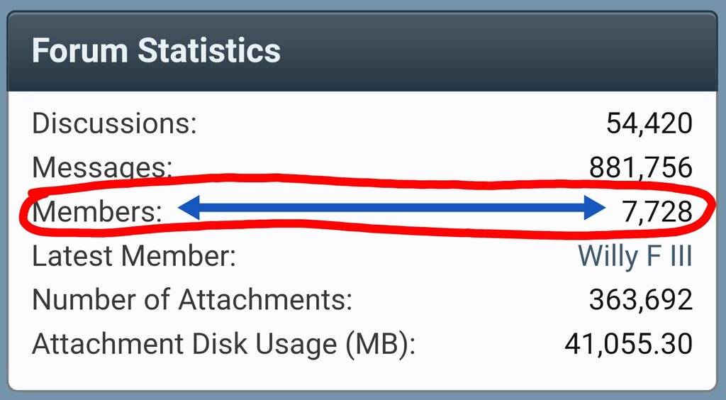

    Along with the other 77-hundred.

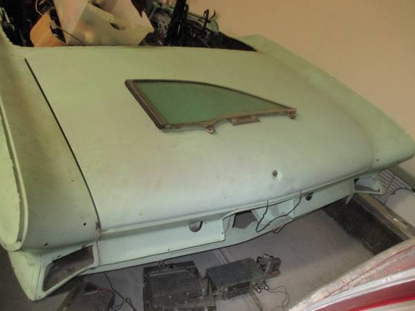

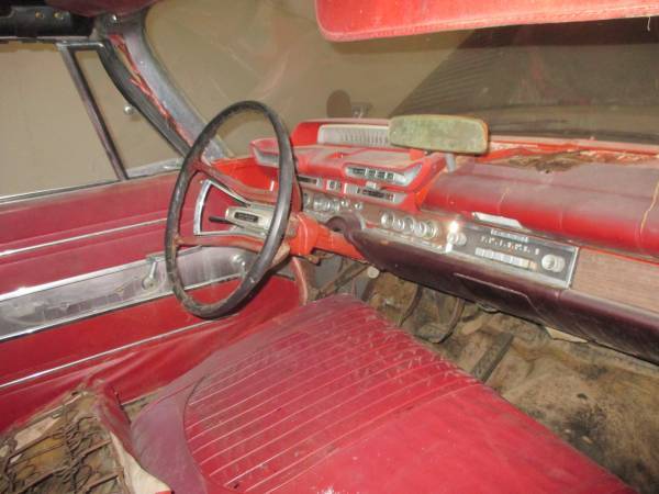

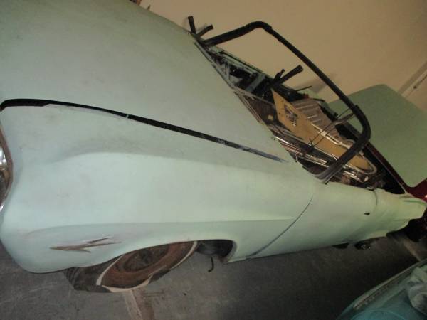

    image.jpeg image.jpeg image.jpeg I believe this is the 61 dodge original poster was talking about. It's still available.

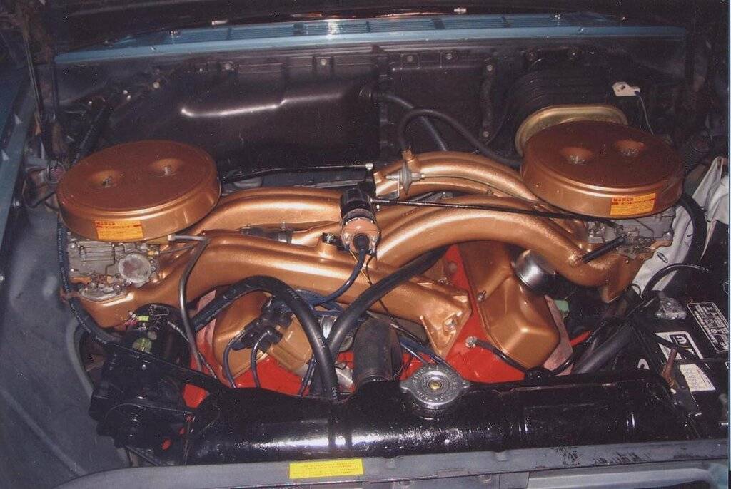

    I can't address Dodges or Darts, but the work done by Darrell Davis shows that '60 SonoRamic Commando equipped Plymouths came off the assembly lines of the Lynch Road (Plant No. 1), Los Angeles (No. 5), Newark, Delaware (No. 6), and St. Louis (No.7). My '60 SonoRamic Fury came from St. Louis and as you can see in Attachment 395413 it has the black engine bay and no fender well cutouts. You can also see it has the narrow and deep Golden Commando windshield washer fluid container and hanger rather than the longer and shallower SonoRamic one as well as the ball-and-socket carb linkage in stead of the later slotted type. Inside, its swivel seats are the earlier 1959 types (non-automatic) although these may have been retrofitted. It has always been my understanding that the fenderwell cutouts were there to facilitate sparkplug changes as back in those days, not every work station in a dealer's shop had a lift, so this was done by jacking up the front end, pulling the front wheels, and going through the openings to get to the plugs (I was quoted a price of 5 bucks per plug for labor by the dealer in 1960).
