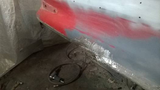

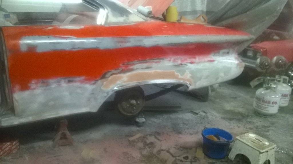

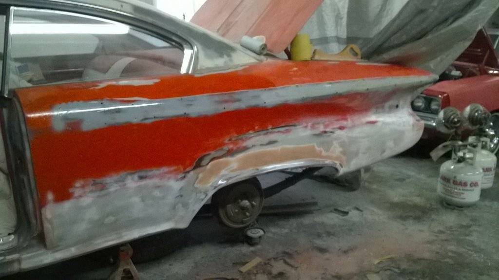

Today I did wet sanding on the rear drivers quarter panel to get the test paint removed. I got a lot of this off. I even did a video of this and its uploading on you tube I might as well post a few photos of what I did
Making a mess again... love it...

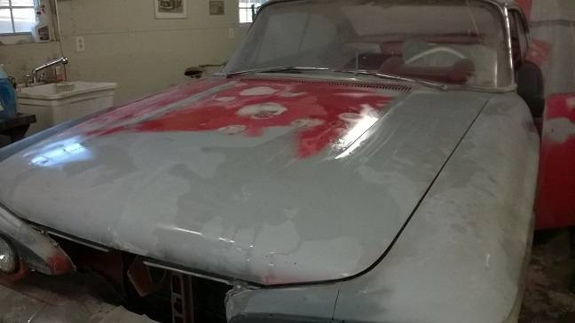

I did some wet sanding on the body to help smooth it out to prepare it for primer . I also did the drivers , the roof of the car the passenger door the top of the rear fender panel . On my next day off from work I plan to do the trunk. I also believe this style sunglasses was worn back in 1961

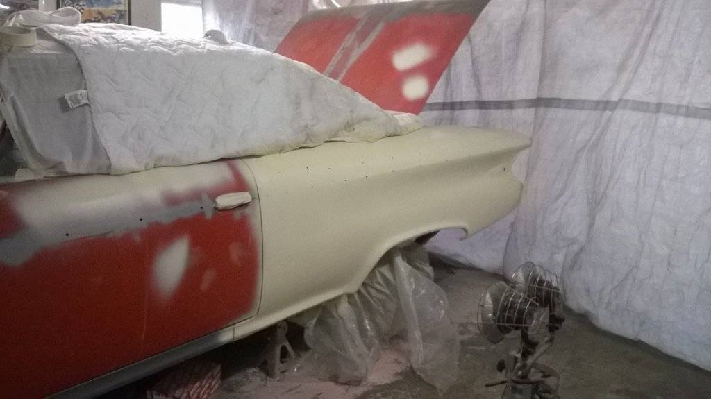

Here is some more progress the rear fender panel was prepped and primered to day. the 1st photo was the prepping and the 2nd the panel is in primer

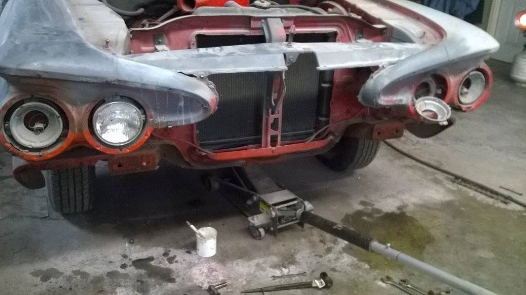

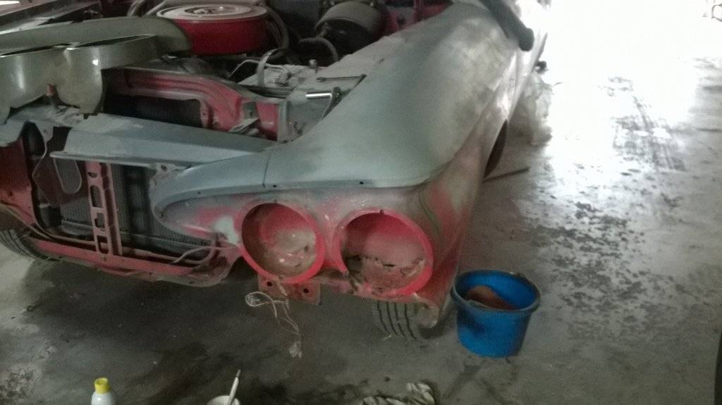

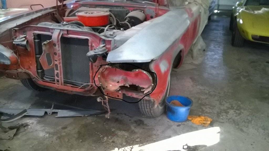

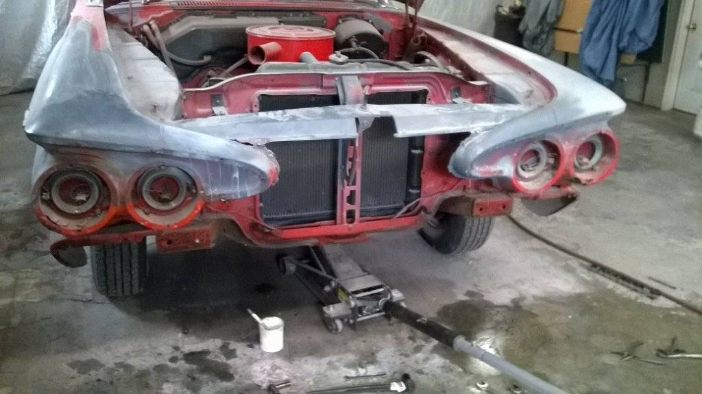

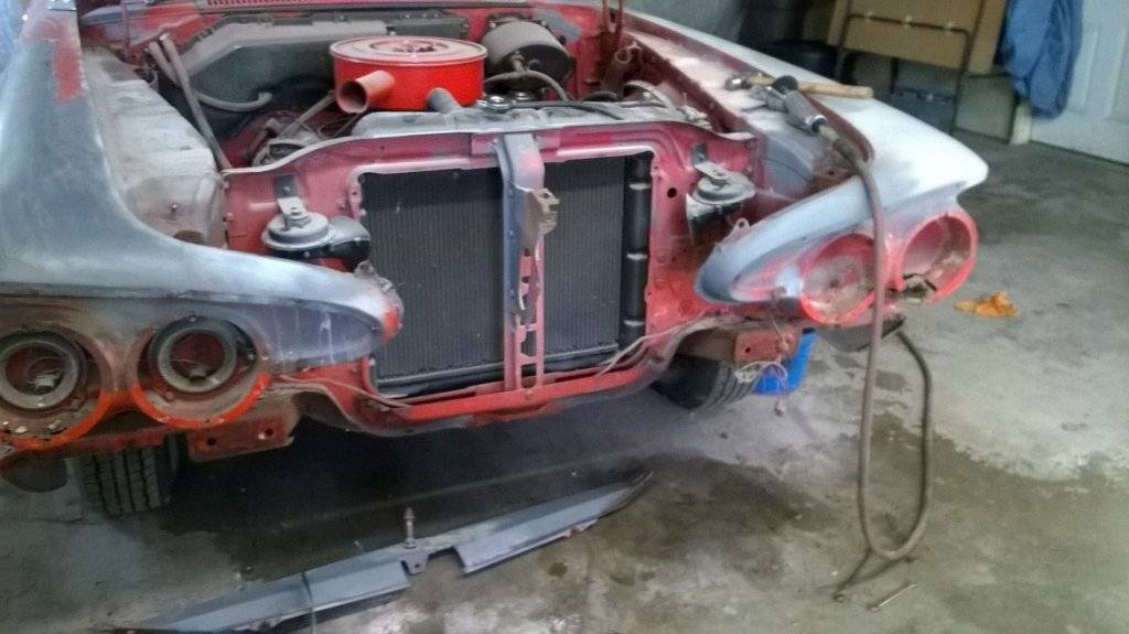

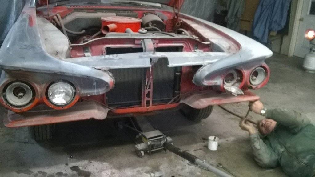

More progress the front bumper was removed , then the splash panels were removed and will be b blasted the head light and the headlight bowls were also removed

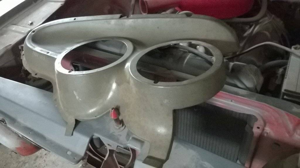

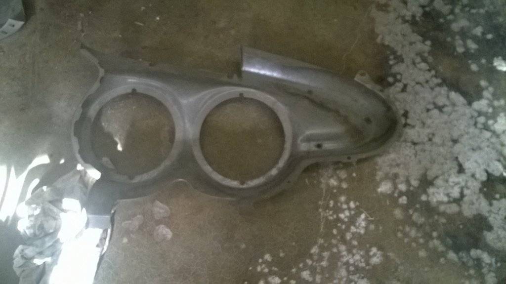

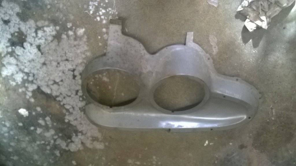

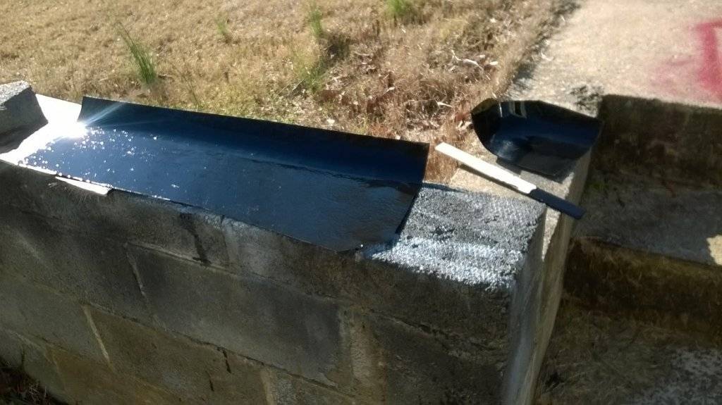

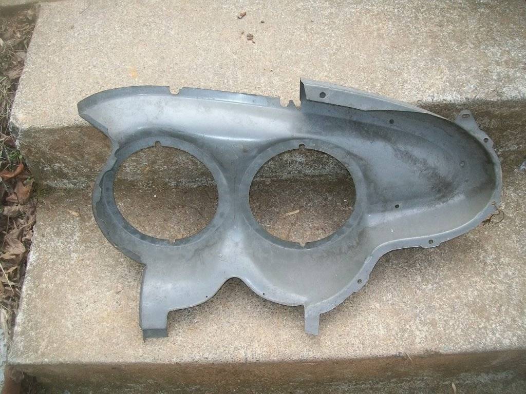

There is a delay until I get a left front fender it needs to be replaced but the passenger can be saved.there is an update I located a headlight patch panel for my car and its NOS. I did purchase it and it was this item that saved the day. I will be applying the por 15 inside this patch panel
My panel has been shipped I am waiting for it to arrive. My panel arrived Friday.
Its waiting to be put on to replace the 1 with the car cancer. Here are some more photos

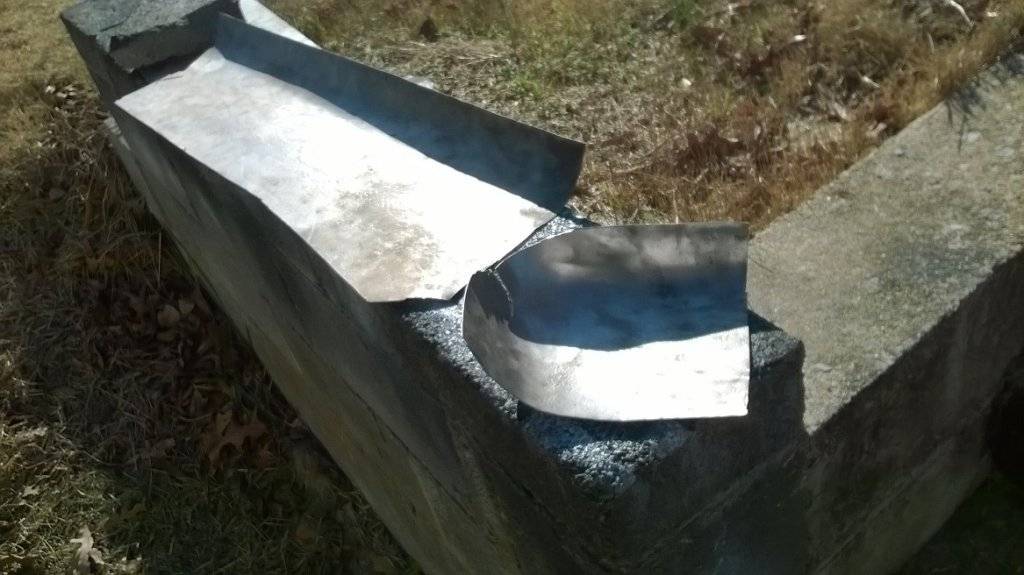

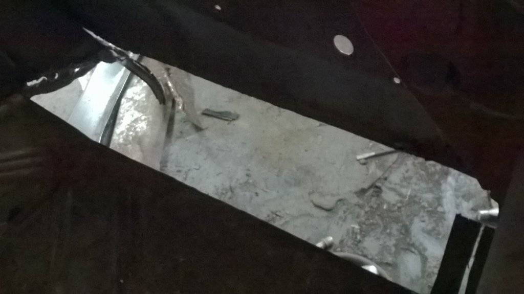

Now its to the passenger rear quarter panel the filling and fabricating of the metal that will be welded on but before that POR 15 will be applied before the welding .
The photo is the 1st part of the progress

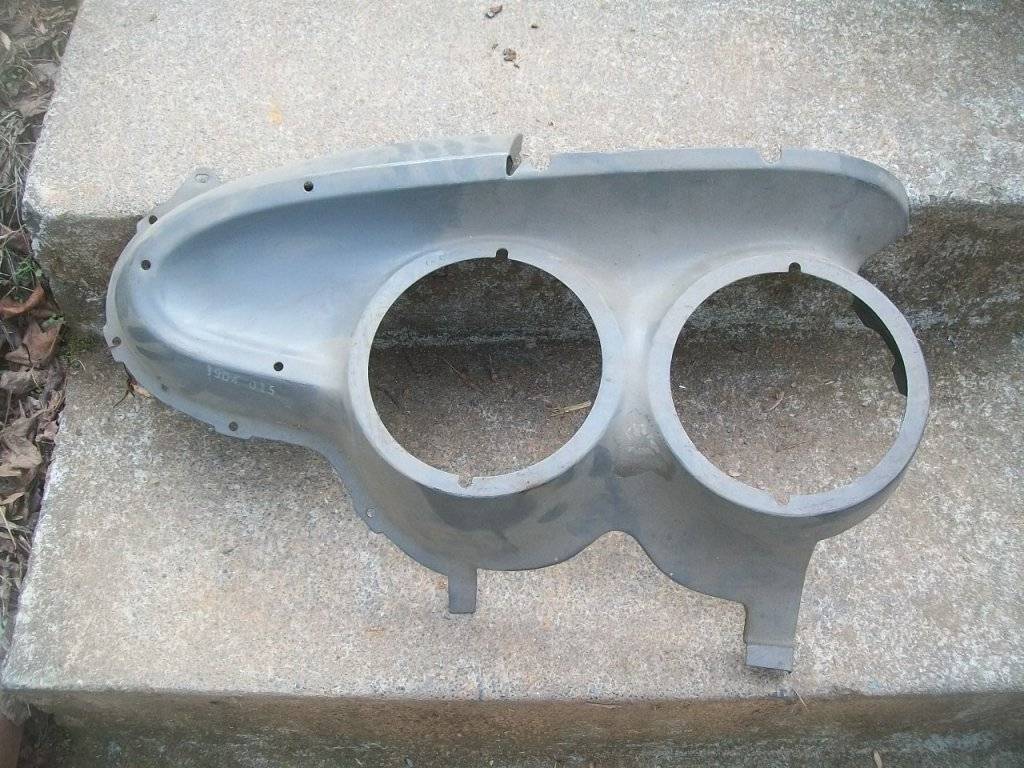

It sure as hell would be nice if body panels were reproduced for 1961 plymouth it would help us '61 plymouth owners alot. The panel in the photo is NOS
Many of us have similar concerns finding parts, but I am impressed with your finds... I would have thought everything for your car was impossible to dig up.

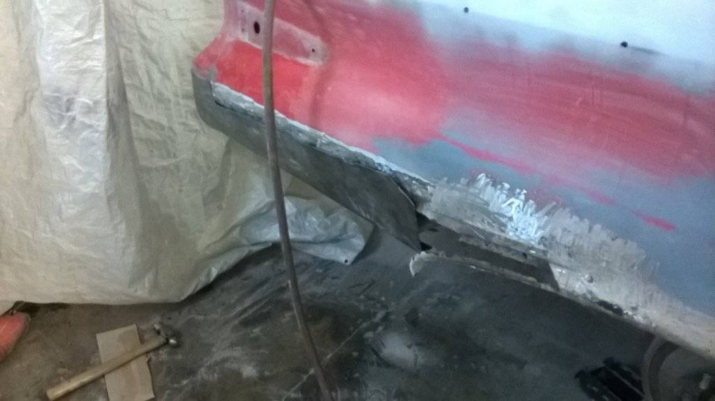

There has been more progress. Por 15 has been applied to patch panels The part were the new panel will be welded on has been cut and removed . After the part was cut off I was like OMG I have never seen that much car cancer. I hope this can be repaired
