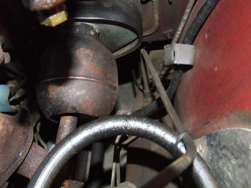

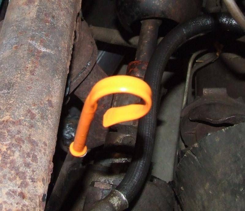

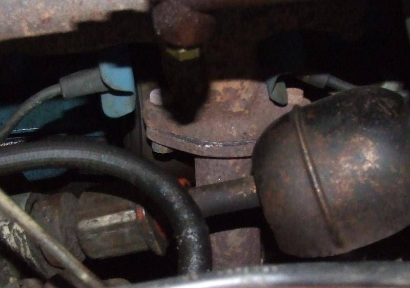

here's a pic of what I'm working with. Black rubber discuss seen under the master cylinder is the problem. I always called it a rag joint-maybe there is another name for it...

Let's go back to square one first.
Why is the coupler hitting the exhaust flange? It shouldn't. Therefore something moved. I doubt the coupler. Ergo the engine moved. How can an engine move? Usually because of bad motor mounts. Do we want to change a coupler to compensate for bad motor mounts? I can't.
It looks like you are also missing the heat shield which protects the rubber from the hot exhaust manifolds.
It's held on with a corbin clamp over the steering column housing.
I have the hi-po manifolds on a 413. I think it may be a later model manifold, since it has screw holes for the hot air shield on it. The original log style manifold did not touch.
