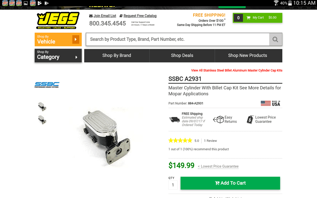

The one iam looking at is this one from Jegs.
You can save about $100 by going to Advance or Autozone and get a stock reman one for a 67 or newer drum brake Fury and getting a chrome lid for it if it has to be shiny.
Kevin
you need a DRUM m/c with the same diameter bore as what you took off, if possible. those looks like disc m/c ^^.

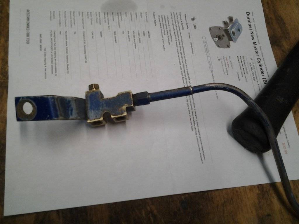

Thanks for all your input guys, what i deceided to do is order a duel m/c for a 67 with drum brakes my brakes are 11x 2 3/4 on the front and 11 x 2 on the rear. I have a picture i will post of my splitter block, iam going to plug the outlet to the rear brakes and put a union on that line to extend it to the m/c. Now iam wondering about my main line to the splitter is 1/4 inch and all the brake lines are 3 /16 should i replace the big one with a 3 /16 or leave it ? Thanks for any help.
