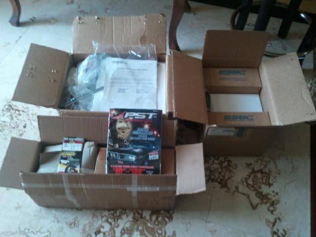

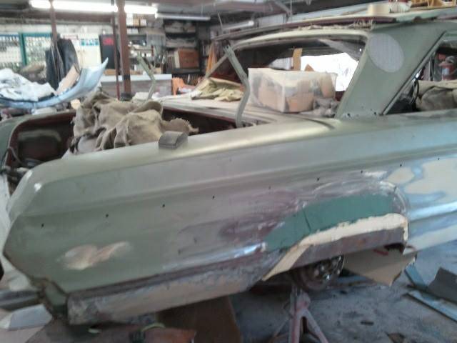

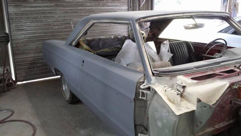

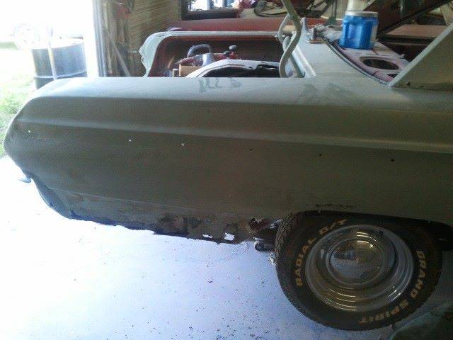

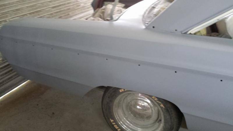

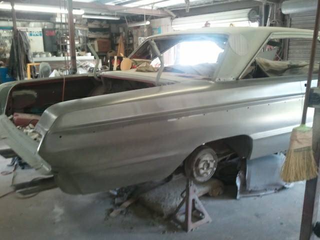

The Fury has been in the body shop for quite some time. I let the shop know as long as they don't charge me storage they could take as long as they wanted. The car is very close to being painted. Just a little more wet sanding and it's ready for paint. Below are some photos of what the worst part of the body was. It was repaired with metal by an old school body guy. He made the patch himself and blended it in and it looks great. Check out the photos. You'll also notice a few boxes. That is my disc brake and front end rebuild kit from PST. I have had the parts quite a while and they have been in storage until the car is further along.
Enjoy the pics.
