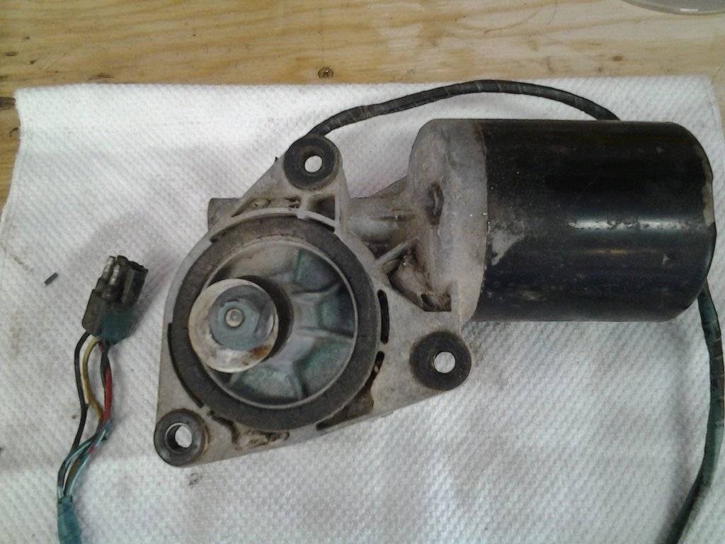

    I think I have a three speed motor from a '65 Chrysler. I will dig it out of the garage and get some pics later this week.

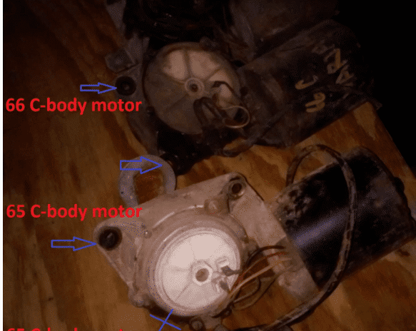

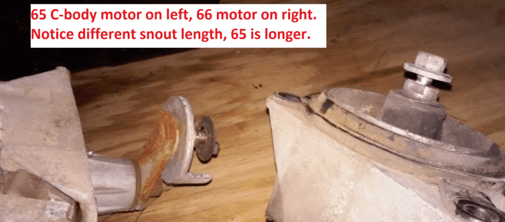

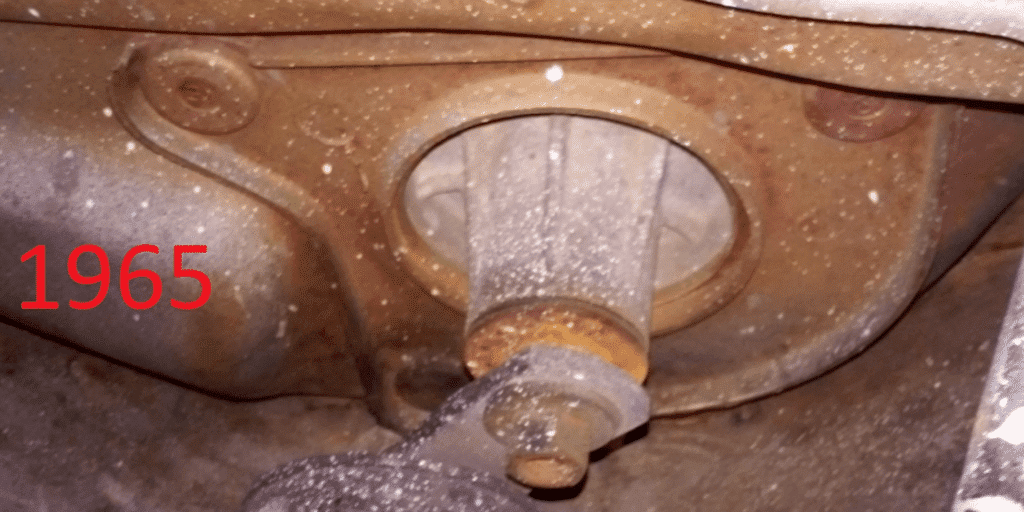

    Took some pics and marked them, the quality ain't great but no time to re-do them.
    Note the difference in mtg pattern between 65-66, both are 3 holes but 65 is more Y-shaped, where as 66 has 2 aligned vertically and 3rd off into a triangle pattern.
    And the difference in snout length also.
    Yet another thing for the list of how 65s differ from 66!!!

    My extra one doesn't seem to work.
