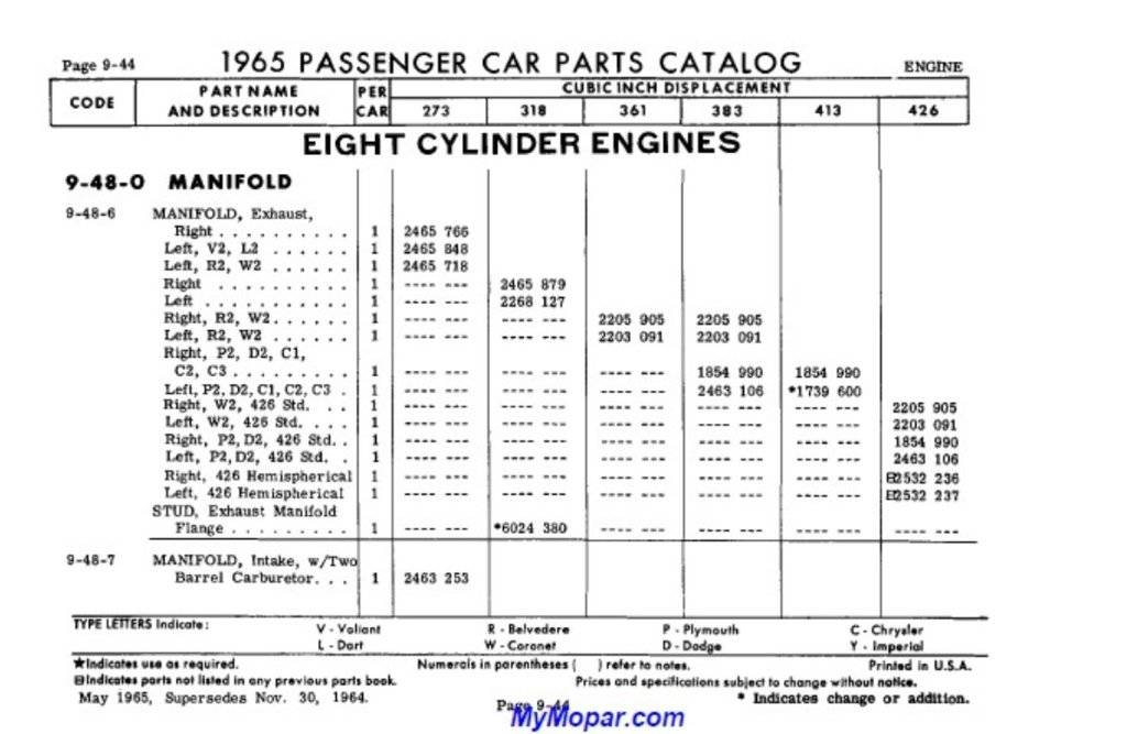

Parts book shows same manifolds for 383 and 426, so even if some cars came with the other style, it looks like you can't completely rule out 426 based on manifolds alone.
Edited for easier reading:
Full page:
Jeff

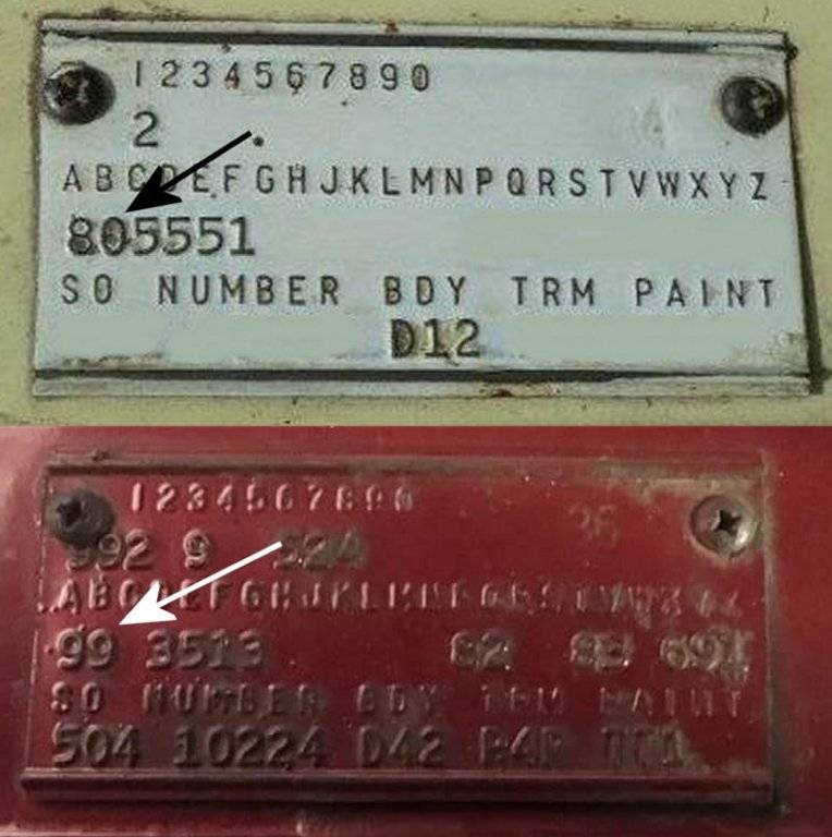

As stated previously, an 80 under ab designates the 426W. 99 designates the standard V8 (383 for a Monaco). The data plate would have to be in error for this to have come with a 426W, highly unlikely but errors have been known to happen.

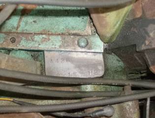

Nobody knows for sure what that motor is based on one low resolution pic. It appears to have the pad on the front of the block which would indicate an RB (raised block) but I can't even tell that conclusively based on the pic. IMO it really doesn't matter what block it is (413, 426W, 440) or even if it's a standard B (361, 383, 400). The trim on it is correct for a 426W, namely air cleaner, valve covers, plug wire looms, etc.

The posted parts numbers for left & right manifolds are different for B and C's based on the parts book excerpts shown. Suppose it's possible that they made an error in the original book but highly unlikely. I've seen quite a few '65 C's with big blocks & they all came with the manifolds shown in that Monaco.

To make it clear, from the 1965 parts book, exhaust manifold part #'s:
For Belvedere & Coronet 2205905 (R) & 2203091 (L) for 361, 383 & 426W
For full size Plymouth, Dodge, Chrysler 1854990 (R) & 2463106 (L) for 383 & 426W
Don't know what the wildcard 1739600 left side C-body 413 is. They forgot to list Imperial!
These are P/N's, not casting #'s. Based on the P/N's they were likely used on earlier models as well. I would trust the factory parts book way more than one of Galen's books.
The engine in the early B-body is quite a bit forward from the firewall compared to later B-bodies and all C-bodies. Perhaps that's why they made a different manifold that exited to the rear for these. If you put these in a C-body I'd bet the clearance (firewall) would be very close.

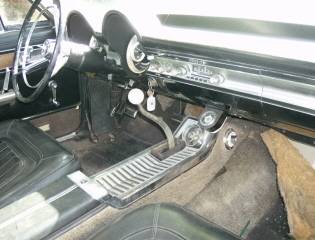

I won't necessarily render an opinion, just stating what I see. As for the engine being a 426W, that could very well be. Only way to know is to see the pad. I will post a pic of mine. Mine is an HP motor, not all 426W's were, I saw one at Carlisle maybe 6-7 years ago without the HP stamping. Now, as for it being original to the car, per the data plate....no. My data plate matches up with the build tag from Chrysler....mine is indeed the real deal. Somebody mentioned the shifter, check mine out, very rare. Short of what has already been discussed, and short of a bona fide paper trail I would say that it is not a factory 426W car. Unless that data tag can somehow be authenticated to state "99" equals 426W then I would always have my doubts about it. When this car first surfaced I thought cool, another like mine. I know there are some on this board who say there are others out there.....SHOW me, and most importantly SHOW me CONCRETE proof. I CAN! Once again, my car may, and I say may, be the only one out there.....and don't forget, it is for sale,lol!
