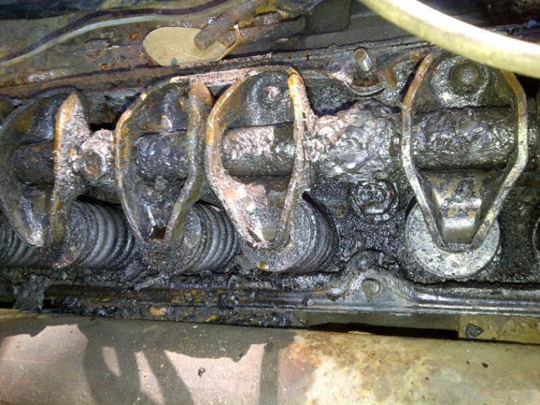

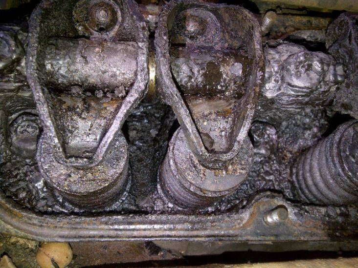

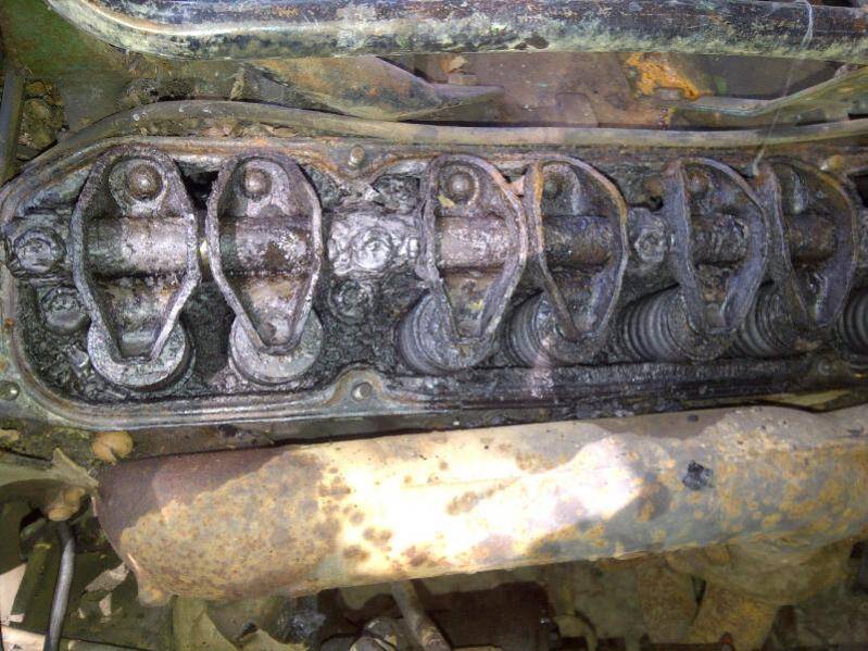

Removed the valve covers and saturated with oil, will give it a few days and try again. Thanks again for all the advice.
That is good advice as well...Taking the valve covers off and removing the rocker arm assemblies. Then spraying the valve stems and letting them sit. Then taping them with a rubber hammer to make sure they all move freely.
But if you can't get the crank to spin then this really doesn't matter...BUT...with removing the rocker assembles, and push rods, you eliminate this as a possible source for the motor not turning over.
Oy, I'd yank it. Someone didn't keep up with oil changes for sure. Who knows what lurks in the bottom of the oil pan. That's got a lot of hot miles on it.
I agree that it appears that it didn't have regular maintenace..BUT...it could be also that it was only driven on short trips, never allowed to get nice and hot for extended persiods. I've had motors that looked like that and they were fine....just changed the oil and filter frequently to help capture as much of the melting goo as possible. You can also run a liter of diesel mixed with your oil to help clean out the oil build up.
