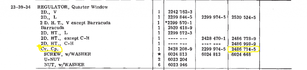

I don't have access to my part # book. I was wondering if anyone can tell me if the Drivers side rear window regulator will interchange between a 65 Polara convertible and 65 Sport Fury convertible?

According to the '65 parts book they are the same.
To clarify, the '65 C-body conv. 1/4 window regulators are the same for power or manual windows. That is not to say that power and manual window regulators are the same.
