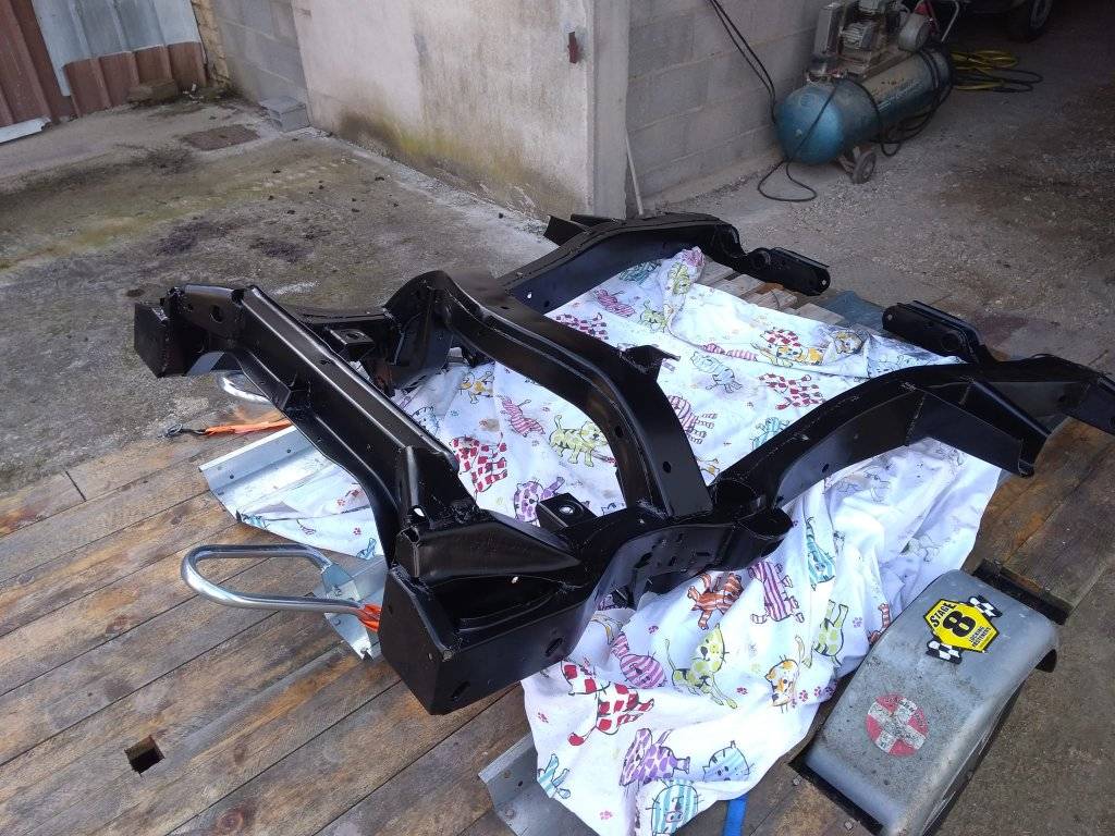

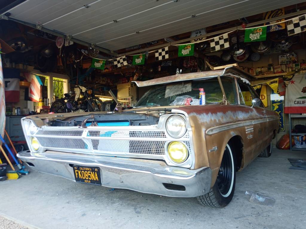

I've made some progress on my project. I've removed the front frame, repaint in black. I have all of the parts for the engine, I'm going to rebuild it this mounth.
But one problem, I research a pitman arm for my car but I can't find it in a right price ... It's 200 dollars for this parts ?!
thanks for the help.

Looks like pitman arm can be had for 100. Over here from auto parts stores.
Felicitations, tres belle caisse! Try using rockauto, when I lived in Europe they were almost the only reliable source of mechanical parts, and they ship everywhere!

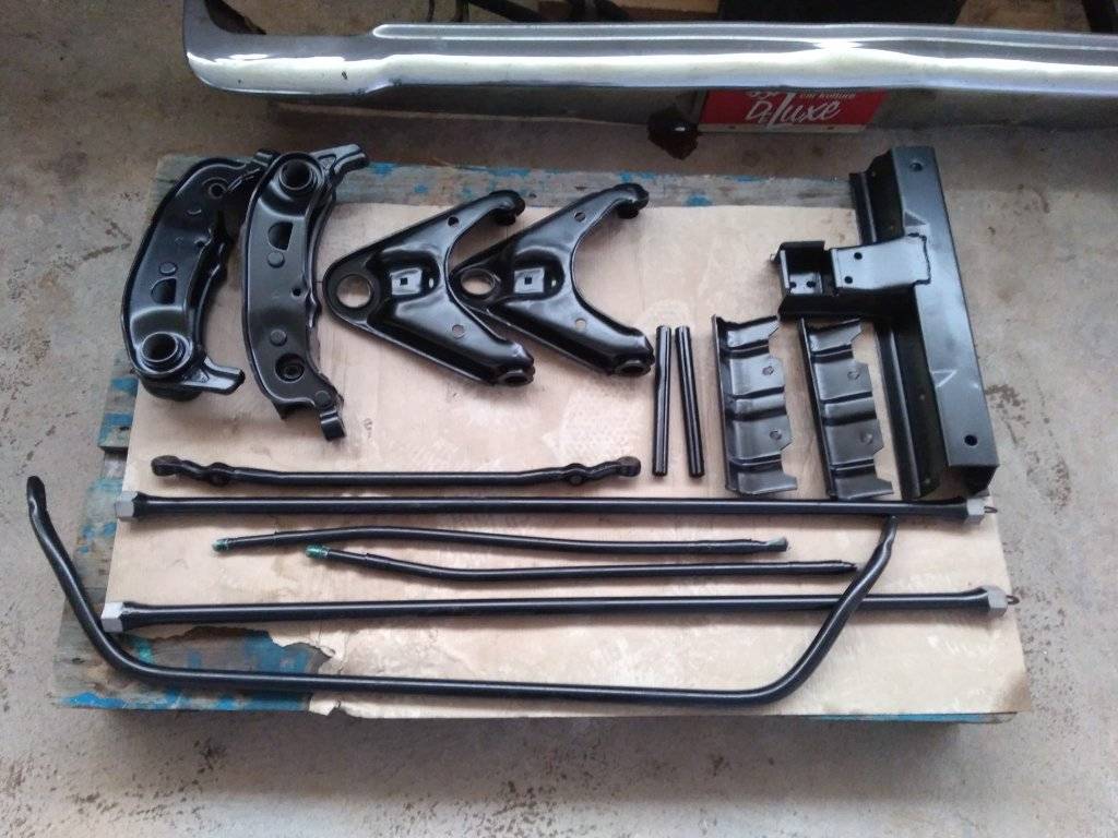

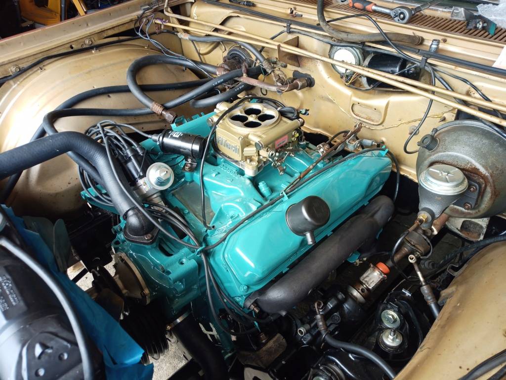

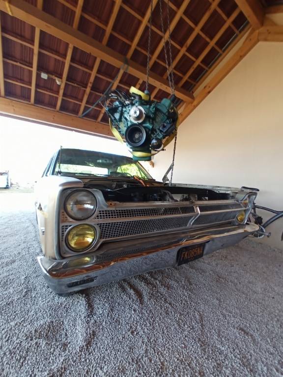

Some news about my project. I have completly rebuild the frame, front suspension, break last winter.
Last week I put the 383 freshly rebuild on the car. I plan the first start for september . Some pics of the news ...

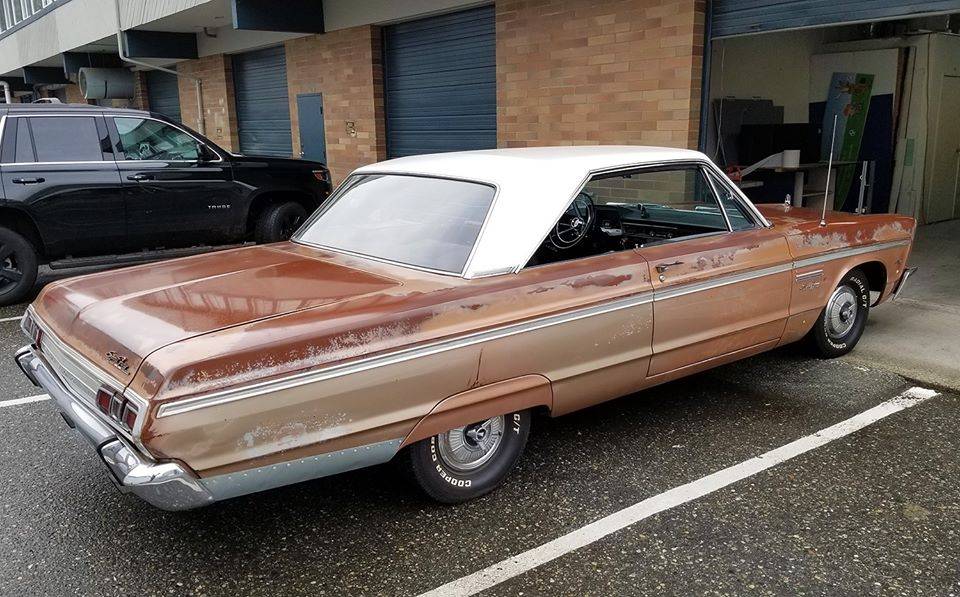

Congratulations on your car!! My first car was a 65 Fury III 4door hardtop. That was back in 1972 when I was 20 years old. I loved the car...383 with torqueflite and power steering. It had am/fm radio from factory. That was a rare option then...oh, tinted windshield too. It was a beautiful color combinations..tourquise exterior and aqua interior. Unfortunately the 383 had issues.....used a lot of oil and would overheat in summer. It only had 75k miles when I bought it. I drove it till 130k and then gave it to a friend.
I'm curious about the efi. I saw the FiTech, did you have trouble with it?
Love the patina you have there!!
I've just finish to instal my Fitech 600hp kit. I turn the Key next weekend !!

I planned on going FiTech, but went with Holley in the end. I liked the idea of getting everything together. I went with the Holley Sniper, distributer (so I can set the time curve), ignition box, coil, and the in-tank pump/sending unit. I also purchased a box that will communicate with the Dakota Digital dash. Dakota didn’t have anything to communicate with the FiTech.
If you checkout my thread, you’ll see that I was all about the FiTech unit for a couple years. There’s a video link in the thread of a guy with the same EFI you have and it works great!!
Keep us posted and get a video!!
Thanks for the answer ... I've find the motor mounts on engine swaps .com
Yes I think the fitech EFI is a good product ... I hope it works good ! Stay tuned

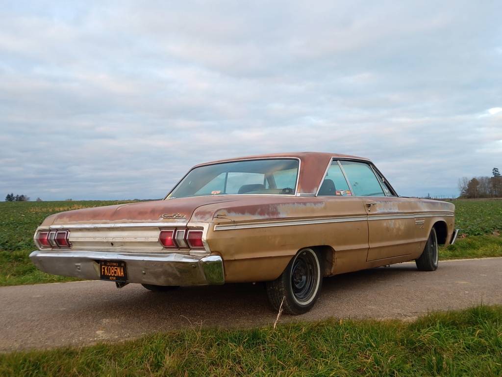

It runs !!!! Today was the first test drive of the Sportfury. It runs pretty good !
Have a nice week mopar guys ;)

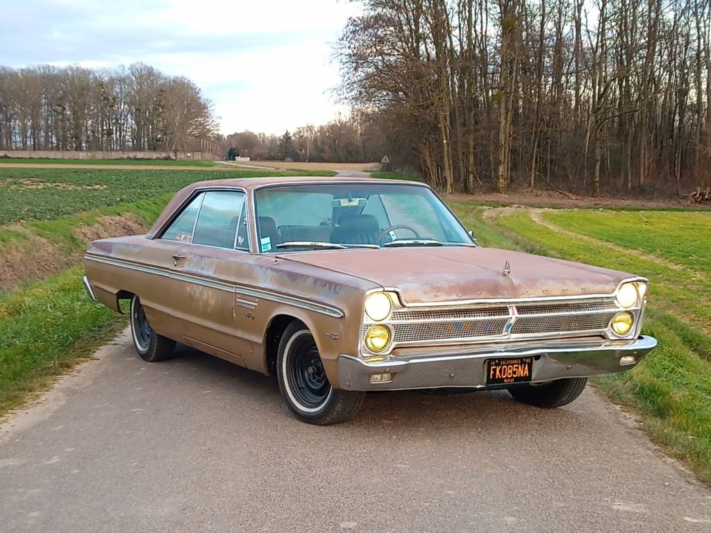

After some adjsutements the fury runs great. I drove it for 50 miles this week-end.
One last problem I don't have a kickdown, and when I put pedal to the metal, the tranmssion sounds like a noise belt sound ... Any idea of the problem ?
Thanks :)

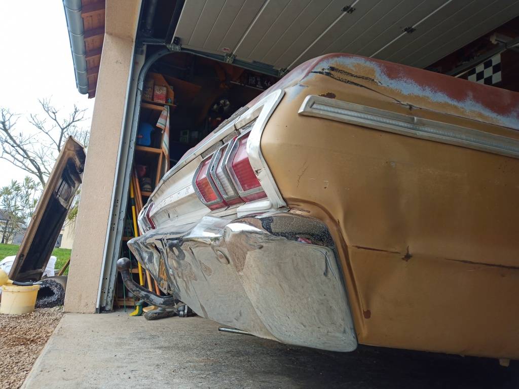

and a pic of my home made trailer hitch !
Thanks :)
Car is looking good!! You definitely want to get a kick down cable/linkage hooked up because you can literally fry your transmission without it!!
